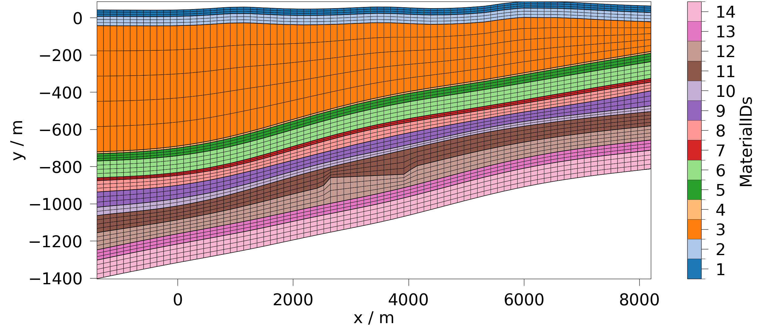

Plotting filled 2D contours returns a matplotlib figure. Via fig.axes
you have access to the Axes object and can further customize and plot to
your liking.
fig = mesh_2D.plot_contourf(ot.variables.material_id)

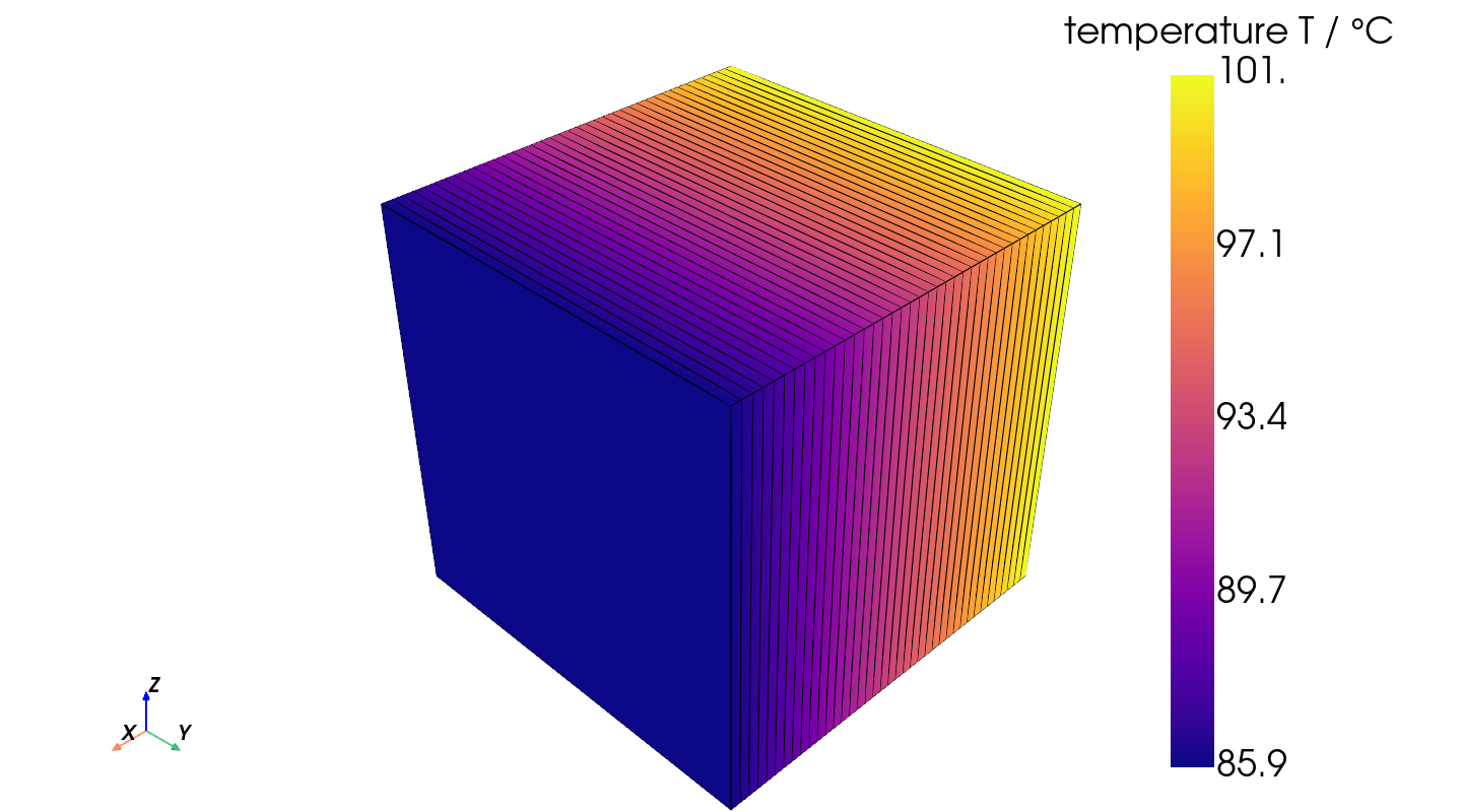

Plotting 3D meshes returns a pyvista.Plotter object, which you can add
other meshes to or change some visualization parameters. Note: In the
interactive scene the colorbar labels may be faulty until you start moving the
model around.
plotter = mesh_3D.plot_contourf(ot.variables.temperature)
plotter.show()

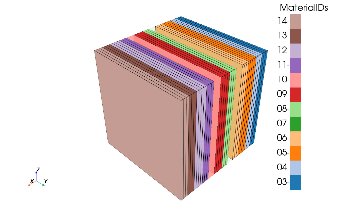

Plotting cell data also works. In this case we plot categorical material ids
and have some of them labeled. You can also add a dictionary to map
transparencies to the individual ids. Passing interactive=false will
return a screenshot instead of a Plotter.
adding a synthetic MaterialIDs field for demonstration purposes
cpts = mesh_3D.cell_centers().points
mesh_3D.cell_data["MaterialIDs"] = (12 * cpts[:, 0] + 3).astype(int)
"MaterialIDs", opacities={7: 0.1, 10: 0.9}, interactive=False

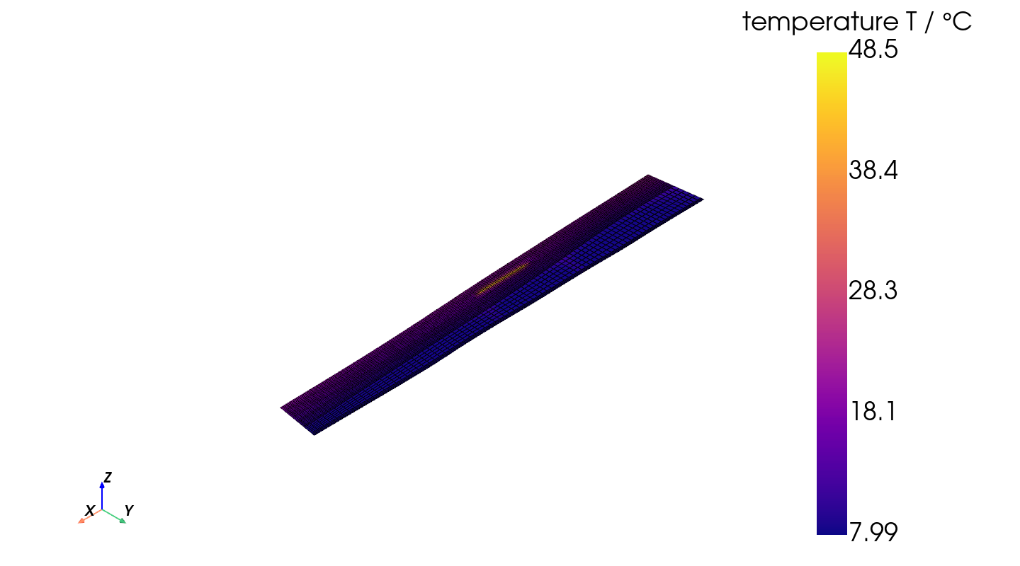

When passing interactive=true, also 2D meshes will use the pyvista
backend:
plotter = mesh_2D.plot_contourf(ot.variables.temperature, interactive=True)
plotter.show()
