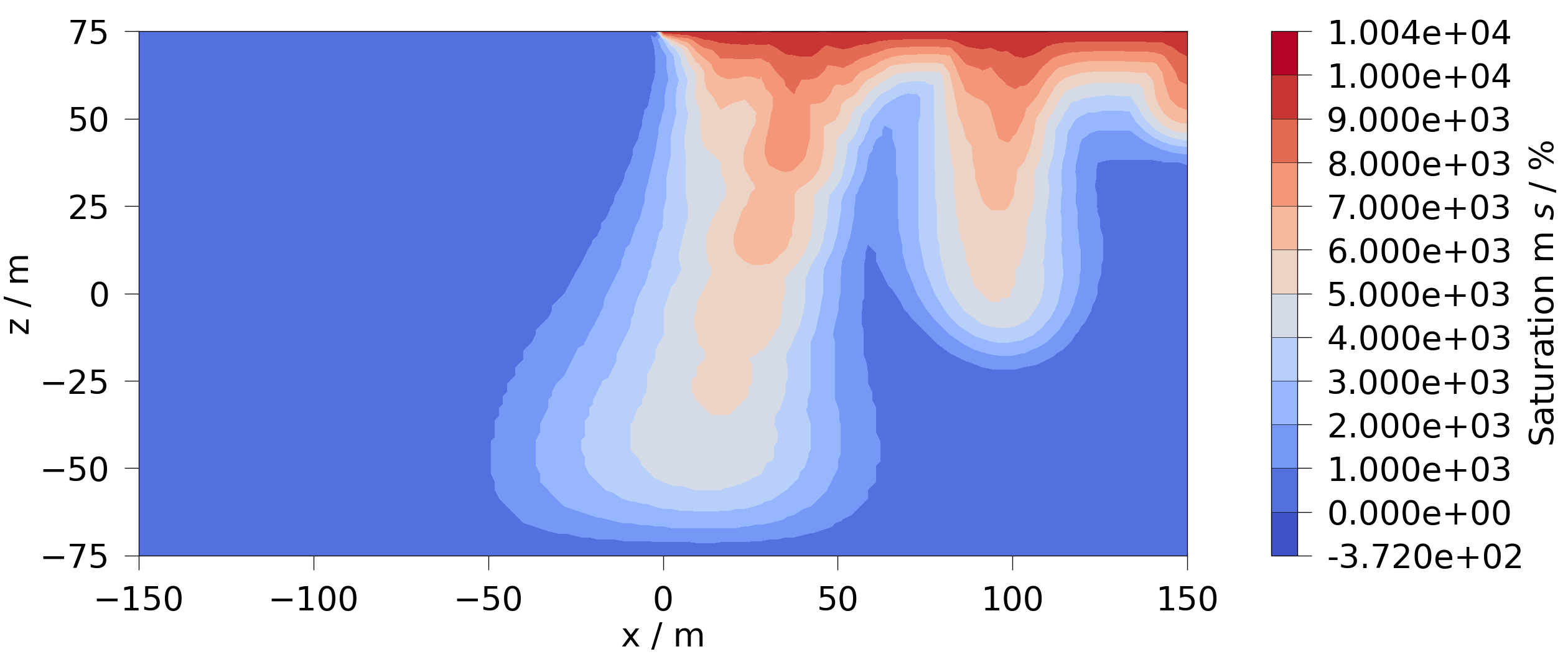

The following code gets the maximum saturation for each point in the mesh over
all timesteps and plots it. Note: the data in the returned mesh has a suffix
equal to the aggregation functions name. The plot function will find the
correct data anyway if given the original variable
mesh = mesh_series.aggregate_over_time(saturation, np.max)
fig = mesh.plot_contourf(saturation)

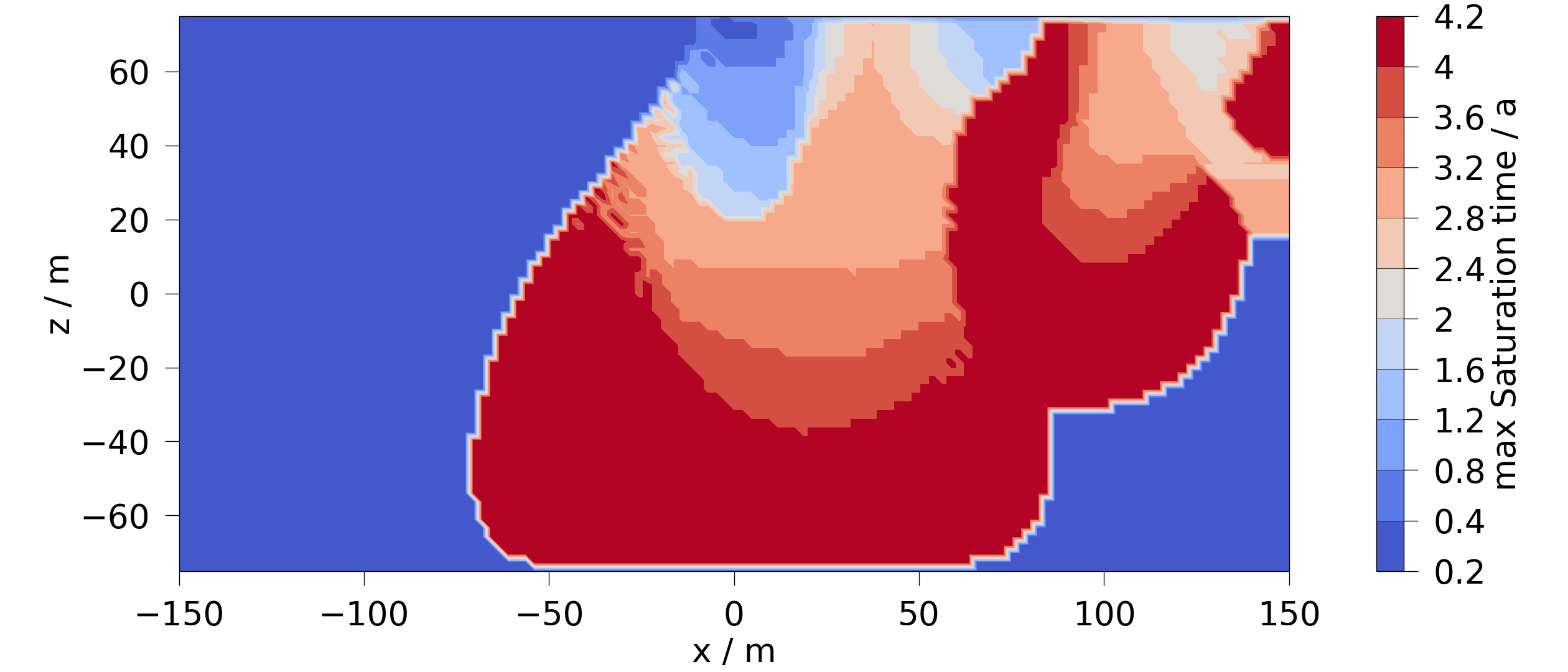

It is also possible to plot the time when the minimum or maximum occurs. However, here we have to use a new variable for the plot to handle the units correctly:
mesh = mesh_series.time_of_max(saturation)
fig = mesh.plot_contourf(ot.variables.Scalar("max_Saturation_time", "a", "a"))

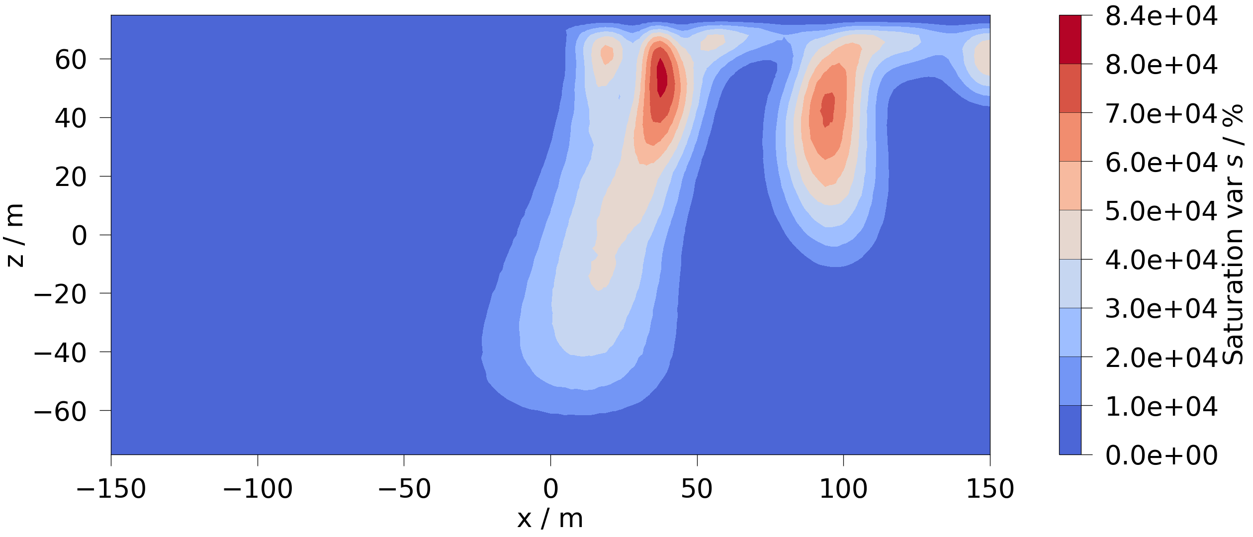

Likewise we can calculate and visualize the variance of the saturation:
mesh = mesh_series.aggregate_over_time(saturation, np.var)

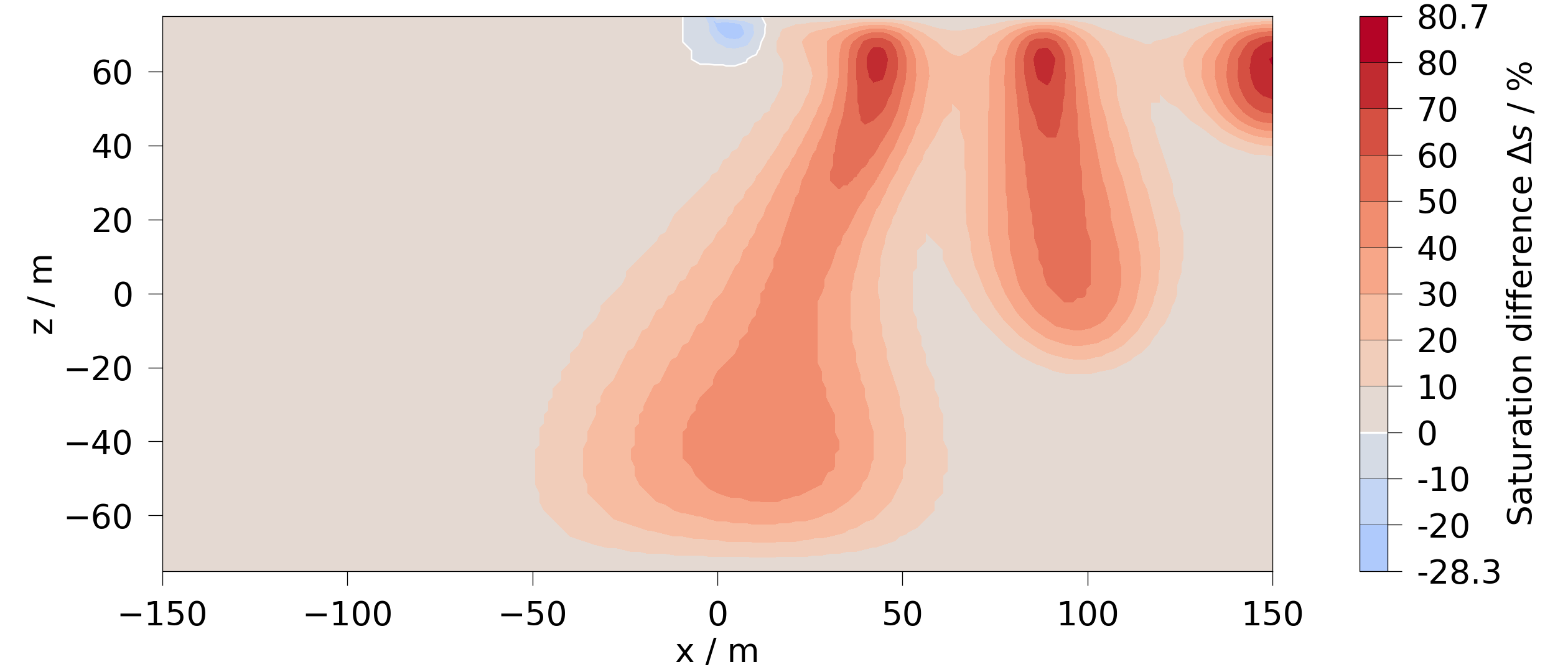

Difference between the last and the first timestep:
mesh = mesh_series.mesh(-1).difference(mesh_series.mesh(0), saturation)

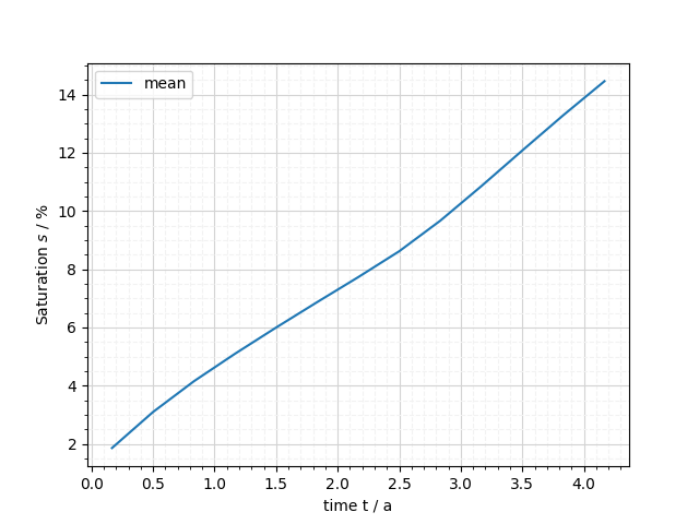

It’s also possible to aggregate the data per timestep to return a timeseries of e.g. the max or mean value of a variable in the entire domain.
fig = mesh_series.plot_domain_aggregate(saturation, np.mean)
