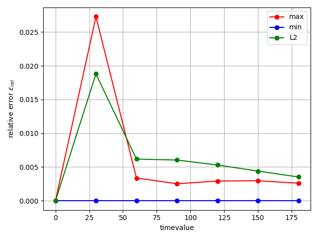

Looking at the errors, we see a higher error right at the beginning. This is likely due to the more dynamic behavior at the beginning.
fig = studies.convergence.plot_convergence_error_evolution(
evolution_metrics, error_type="absolute"
evolution_metrics, error_type="relative"
