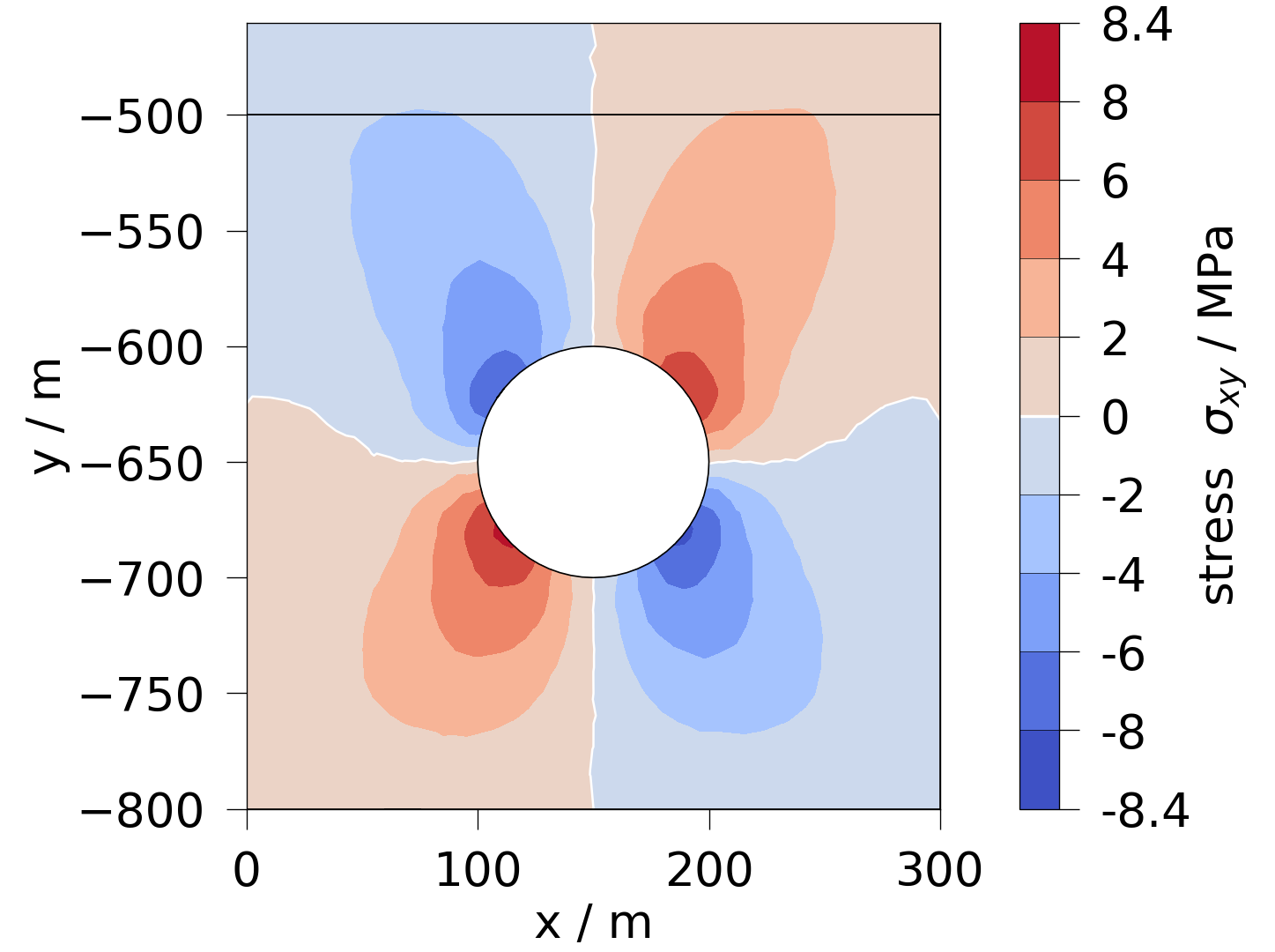

We can inspect the stress (or strain) tensor components by indexing.
fig = mesh.plot_contourf(ot.variables.stress["xx"])
fig = mesh.plot_contourf(ot.variables.stress["xy"])
