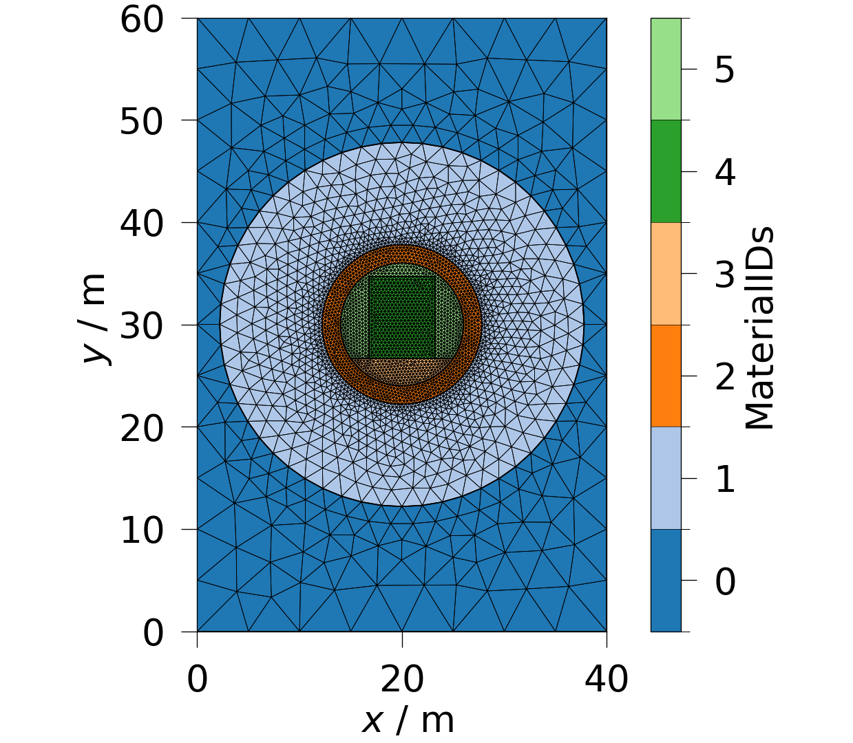

Plot the domain mesh#
Here we plot the domain mesh with material IDs shown.
fig = ot.plot.contourf(meshes.domain, ot.variables.material_id, show_edges=True)
plot meshes from yaml

# You can run the tool directly, passing a YAML geometry file and optionally
# an output directory. The tool will generate the intermediate `.msh` file,
# convert it to VTU meshes, and save everything to the output directory.
# .. code-block:: bash
#    yaml2vtu -i example_simple.yml
#    yaml2vtu -i example_simple.yml -o output_dir
# This produces:
# * `output_dir/mesh.msh` - the raw Gmsh mesh
# * `output_dir/mesh_*.vtu` - domain and submeshes in VTU format, ready for OGS
Total running time of the script: (0 minutes 1.383 seconds)
