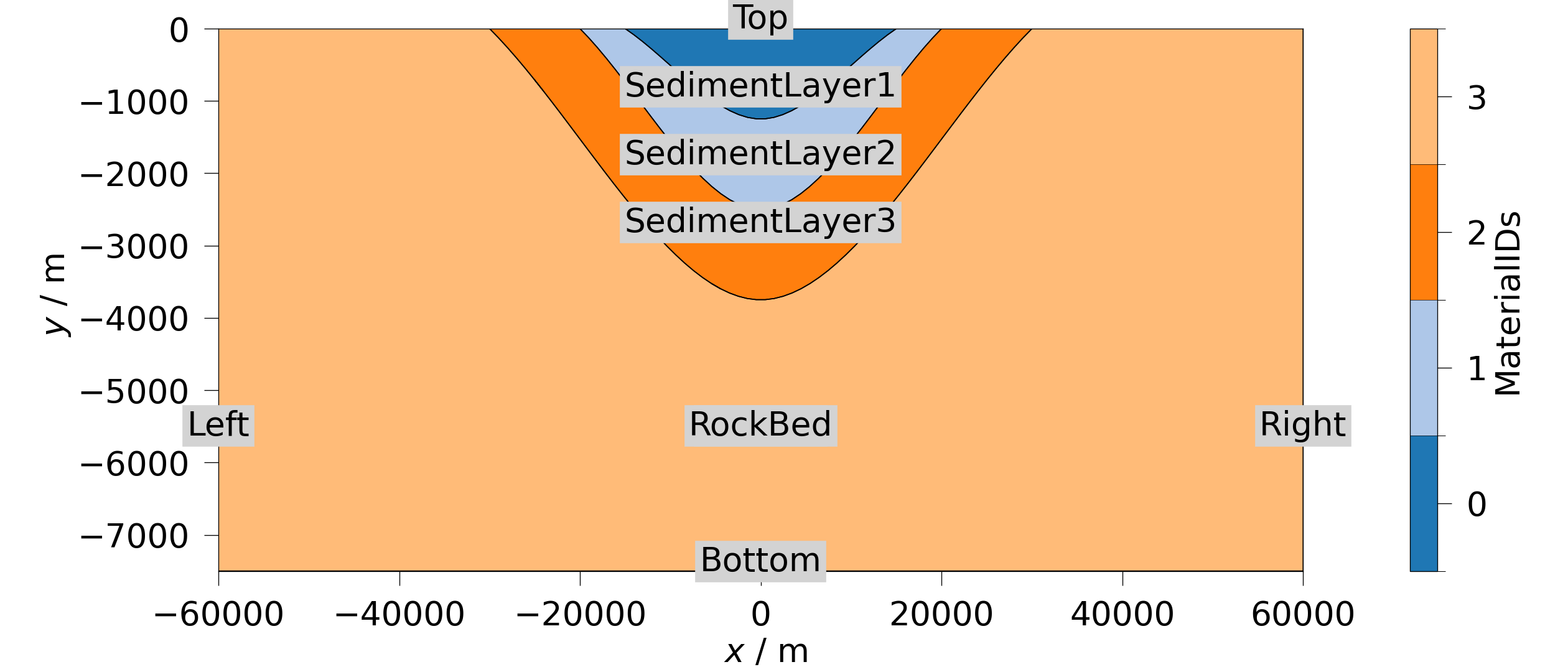

Let’s plot the domain mesh and mark the subdomains.
domain = meshes["domain"]
fig = ot.plot.contourf(domain, ot.variables.material_id, show_edges=False)
style = {"size": 32, "backgroundcolor": "lightgrey", "ha": "center"}
    text_xy = [mesh.center[0], 0.5 * (mesh.center[1] + mesh.bounds[2])]
    fig.axes[0].annotate(name.split("_")[-1], text_xy, **style)
plot msh2vtu
