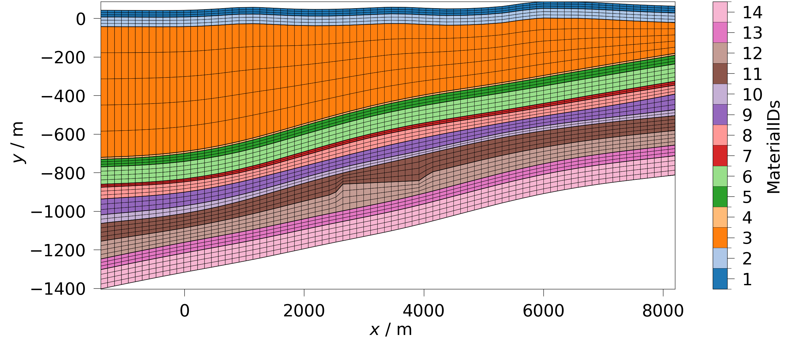

Plotting filled 2D contours returns a matplotlib figure. Via fig.axes you have access to the Axes object and can further customize and plot to your liking.
fig = ot.plot.contourf(mesh_2D, ot.variables.material_id)
plot plot

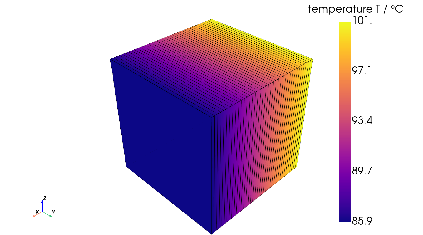

Plotting 3D meshes returns a pyvista.Plotter object, which you can add other meshes to or change some visualization parameters. Note: In the interactive scene the colorbar labels may be faulty until you start moving the model around.
plotter = ot.plot.contourf(mesh_3D, ot.variables.temperature)
plotter.show()
plot plot

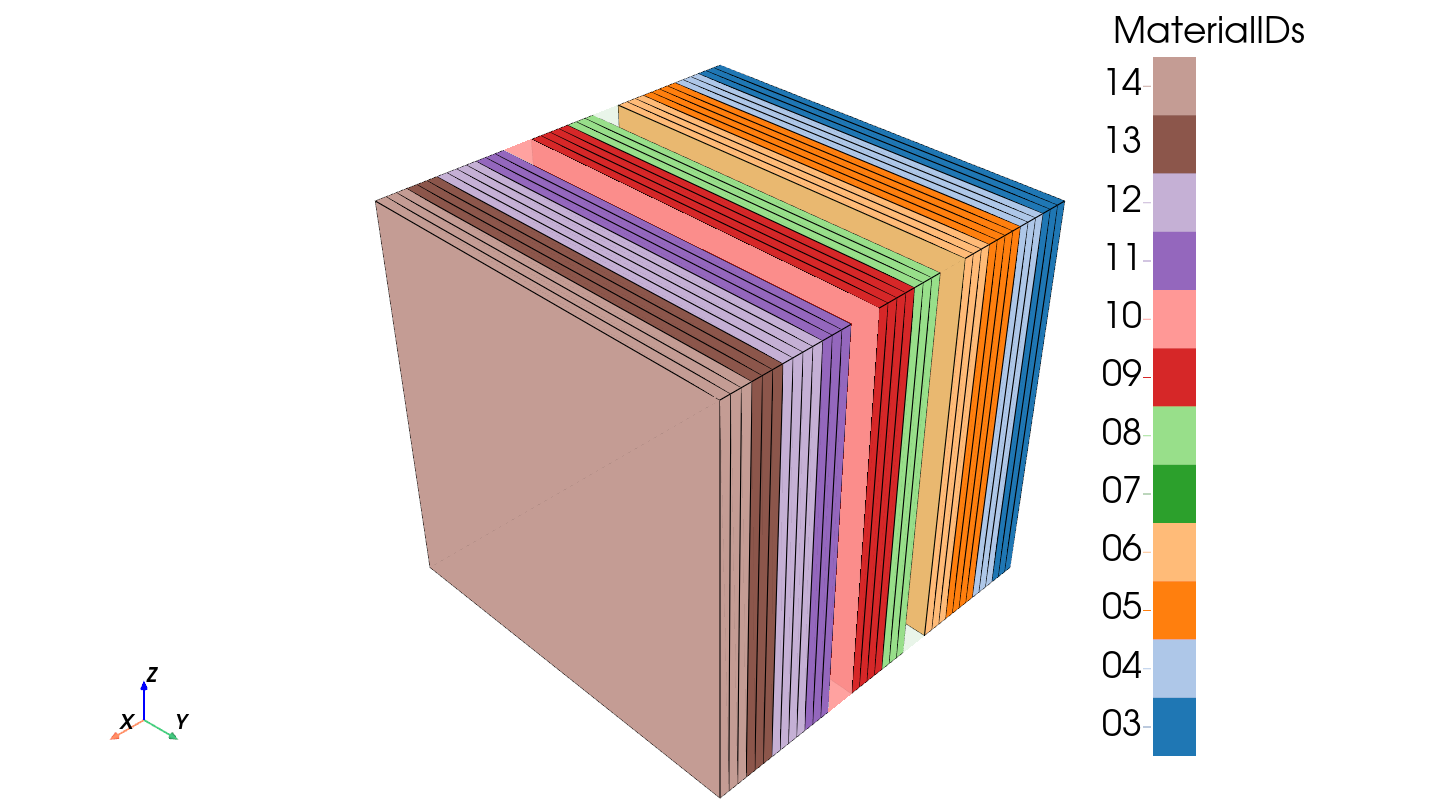

Plotting cell data also works. In this case we plot categorical material ids and have some of them labeled. You can also add a dictionary to map transparencies to the individual ids. Passing interactive=false will return a screenshot instead of a Plotter.
adding a synthetic MaterialIDs field for demonstration purposes
cpts = mesh_3D.cell_centers().points
mesh_3D.cell_data["MaterialIDs"] = (12 * cpts[:, 0] + 3).astype(int)
    "MaterialIDs", opacities={7: 0.1, 10: 0.9}, interactive=False
# You have to be aware, if you switch between local and remote rendering in your
# notebook, that there are some differences in the resulting figure. E.g. remote
# rendering seems to have trouble correctly labeling categorical values.
plot plot

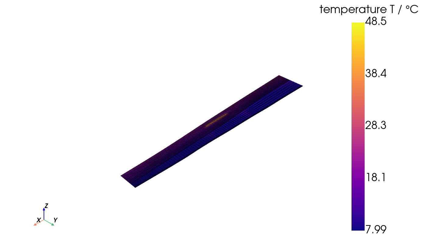

When passing interactive=true, also 2D meshes will use the pyvista backend:
plotter = ot.plot.contourf(mesh_2D, ot.variables.temperature, interactive=True)
plotter.show()
plot plot
