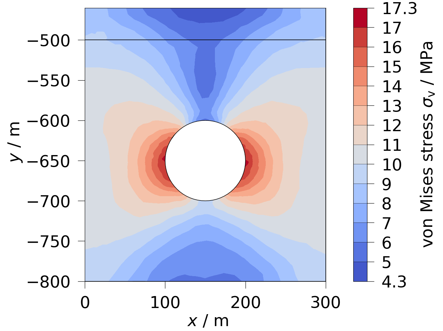

We suggest specifying the variables and their transformations once. These can be reused in different kind of post processing. When plotting with ogstools.plot we can use these presets to simplify the task of processing the data (e.g. calculate the von Mises stress):
fig = ot.plot.contourf(
    examples.load_mesh_mechanics_2D(), ot.variables.stress.von_Mises
plot variables
Have a look at Plotting the data for more examples.
