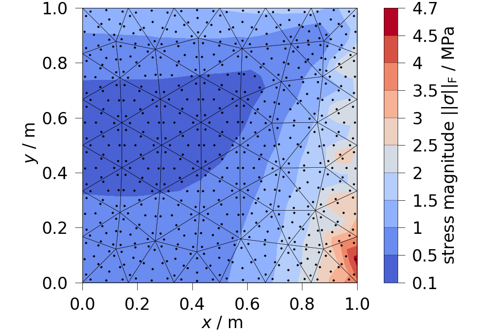

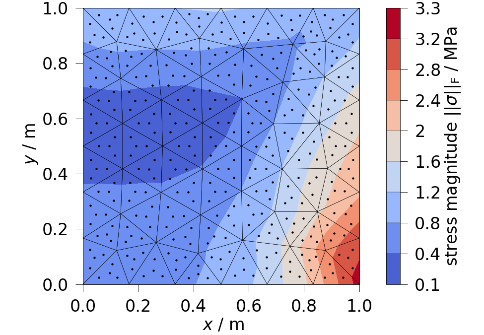

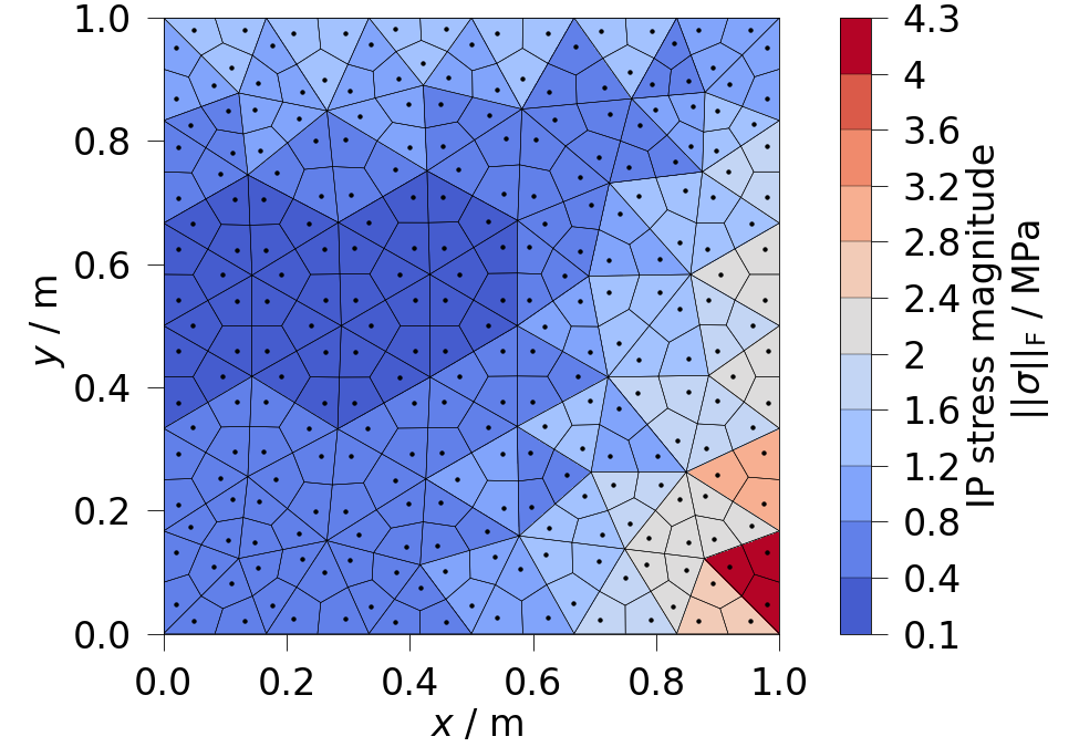

Triangles with increasing integration point order#
Why does the stress not change with the integration point order?
In linear triangular finite elements, the shape functions used to interpolate displacements are linear functions of the coordinates. As this is a linear elastic example, the displacements are linear. The strain, which is obtained by differentiating the displacement, will thus be constant throughout the element. The stress, which is related to the strain through a constitutive relationship will also be constant throughout the element. Thus, the stress is not affected by the integration point order.
simulate_and_plot(elem_order=1, quads=False, intpt_order=2)
  • plot ipdata
  • plot ipdata
simulate_and_plot(elem_order=1, quads=False, intpt_order=3)
  • plot ipdata
  • plot ipdata
simulate_and_plot(elem_order=1, quads=False, intpt_order=4)
  • plot ipdata
  • plot ipdata

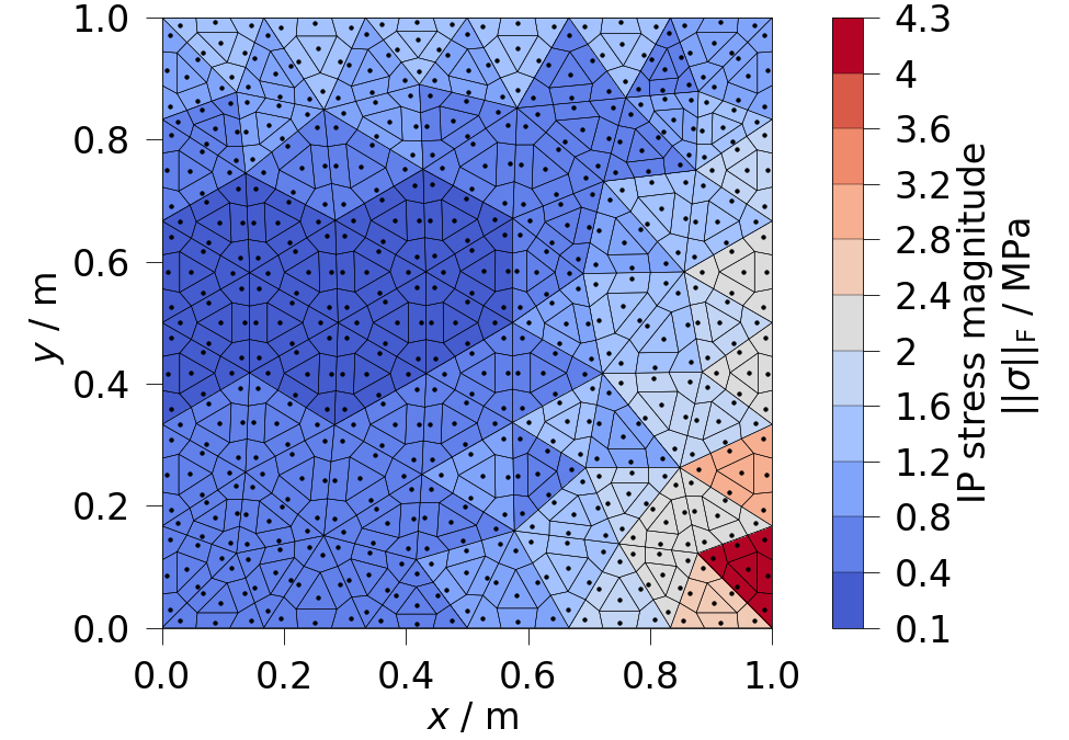

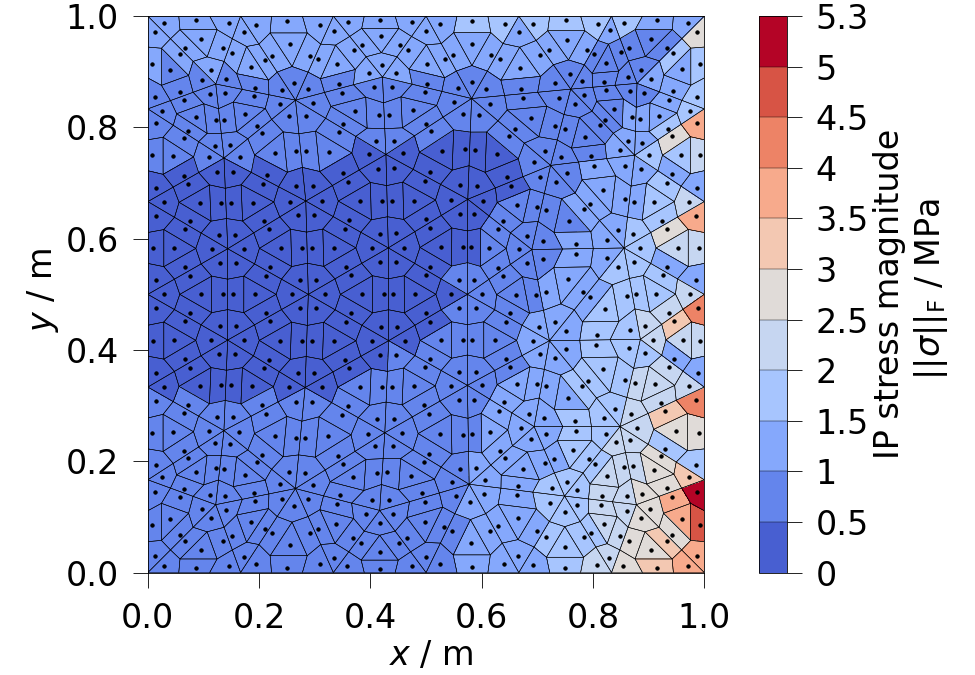

Quadratic triangles#
simulate_and_plot(elem_order=2, quads=False, intpt_order=4)
  • plot ipdata
  • plot ipdata

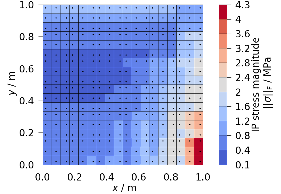

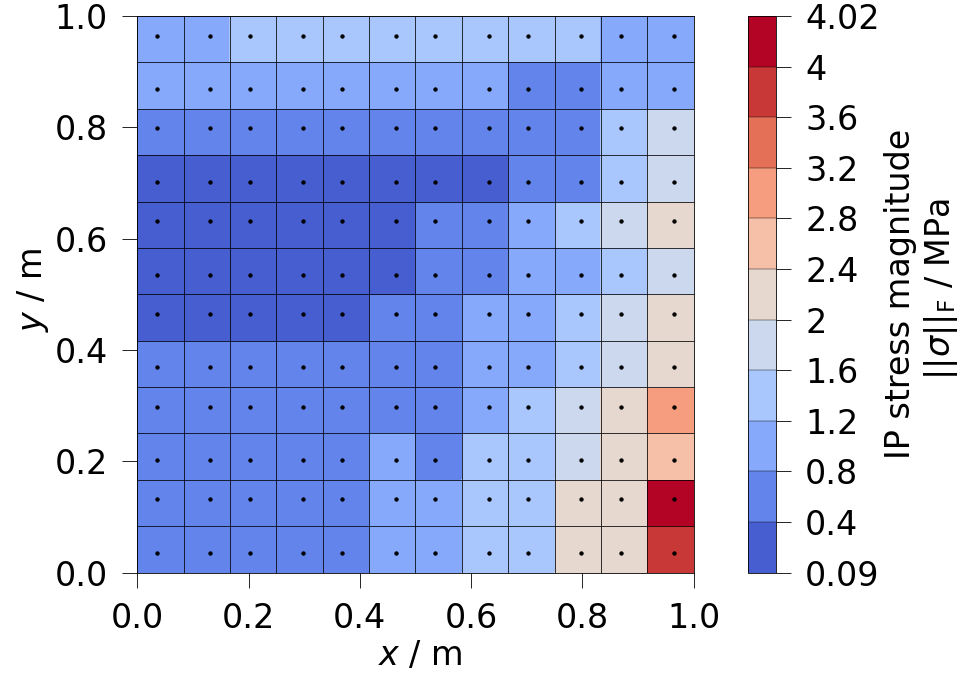

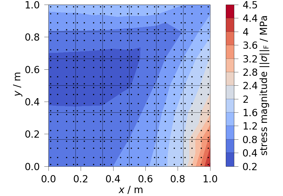

Quadrilaterals with increasing integration point order#
Why does the stress change here?
In contrast to triangular elements, quadrilateral elements use bilinear shape functions. Thus, the differentiation of the displacement leads to bilinear strain. The stress in turn is bilinear as well and can change within the elements. The number of integration points consequently affects the resulting stress field.
simulate_and_plot(elem_order=1, quads=True, intpt_order=2)
  • plot ipdata
  • plot ipdata
simulate_and_plot(elem_order=1, quads=True, intpt_order=3)
  • plot ipdata
  • plot ipdata
simulate_and_plot(elem_order=1, quads=True, intpt_order=4)
  • plot ipdata
  • plot ipdata

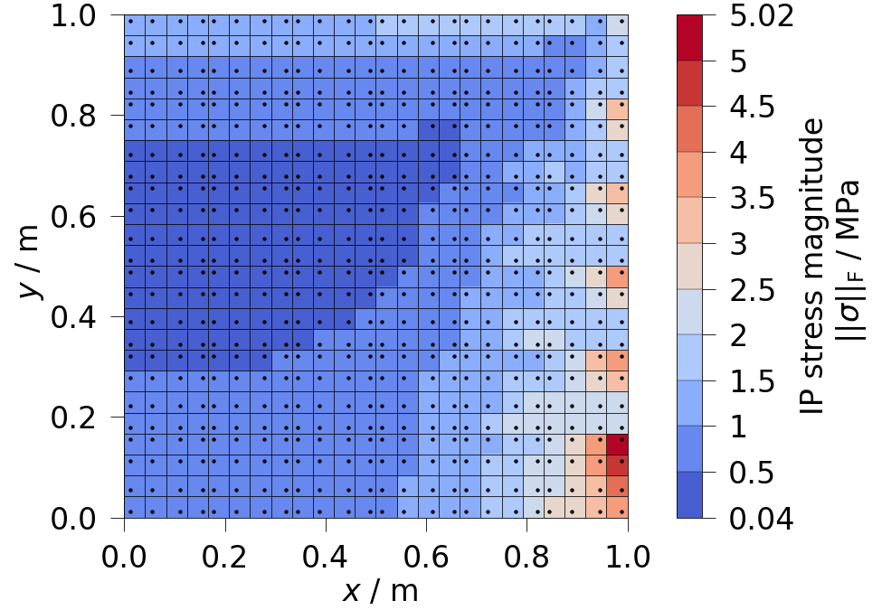

Quadratic quadrilateral#
simulate_and_plot(elem_order=2, quads=True, intpt_order=4)
  • plot ipdata
  • plot ipdata
