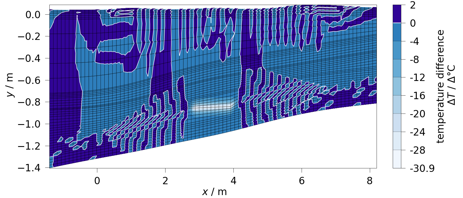

The following call will return a mesh containing the difference of the variable between the two provided meshes. Then we plot the difference:
mesh_diff = ot.mesh.difference(mesh1, mesh2, ot.variables.temperature)
fig = ot.plot.contourf(mesh_diff, ot.variables.temperature)
plot calculate diff

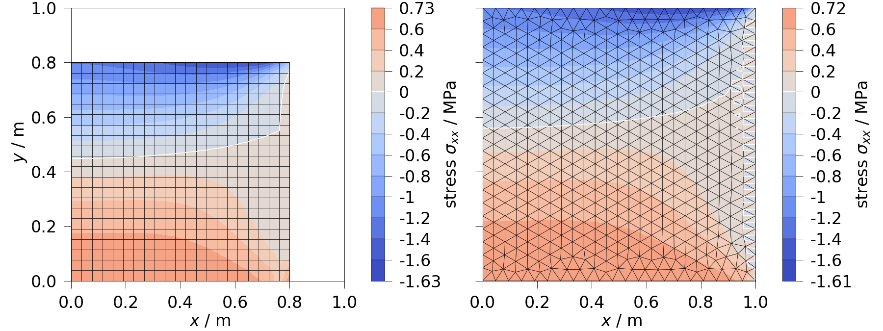

They are visibly quite similar, aside from the difference in cell type and size:
fig = ot.plot.contourf([quad_mesh, tri_mesh], ot.variables.stress["xx"])
plot calculate diff

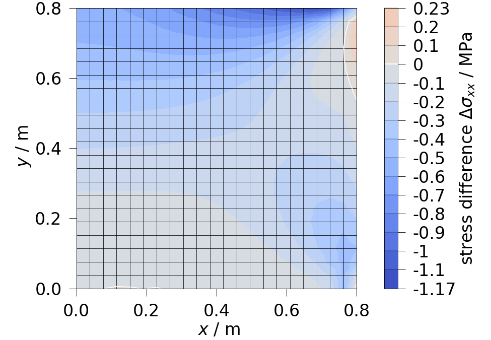

To better quantify it we form the difference and plot the result. The base mesh of which we subtract from provides the topology to show the differences. Thus we see data here on the quad mesh. Be aware that comparing different topologies is inherently affected by interpolation.
diff_mesh = ot.mesh.difference(quad_mesh, tri_mesh, ot.variables.stress)
fig = ot.plot.contourf(diff_mesh, ot.variables.stress.difference["xx"])
plot calculate diff

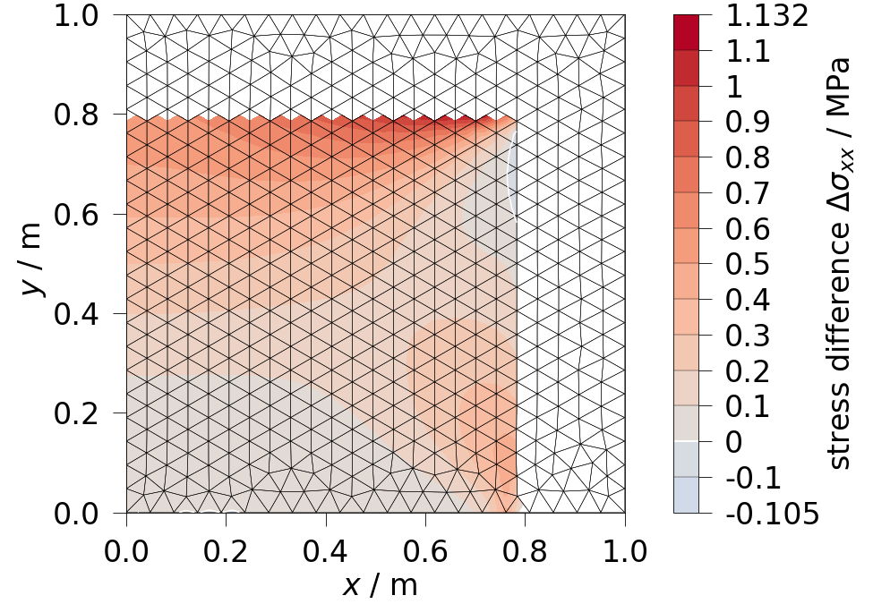

Doing it the other way around shows the difference on the tri-mesh. Here, we see, that the subtracted mesh was smaller then the base mesh and thus, the which are outside of the domain of the second mesh are masked.
diff_mesh = ot.mesh.difference(tri_mesh, quad_mesh, ot.variables.stress)
plot calculate diff

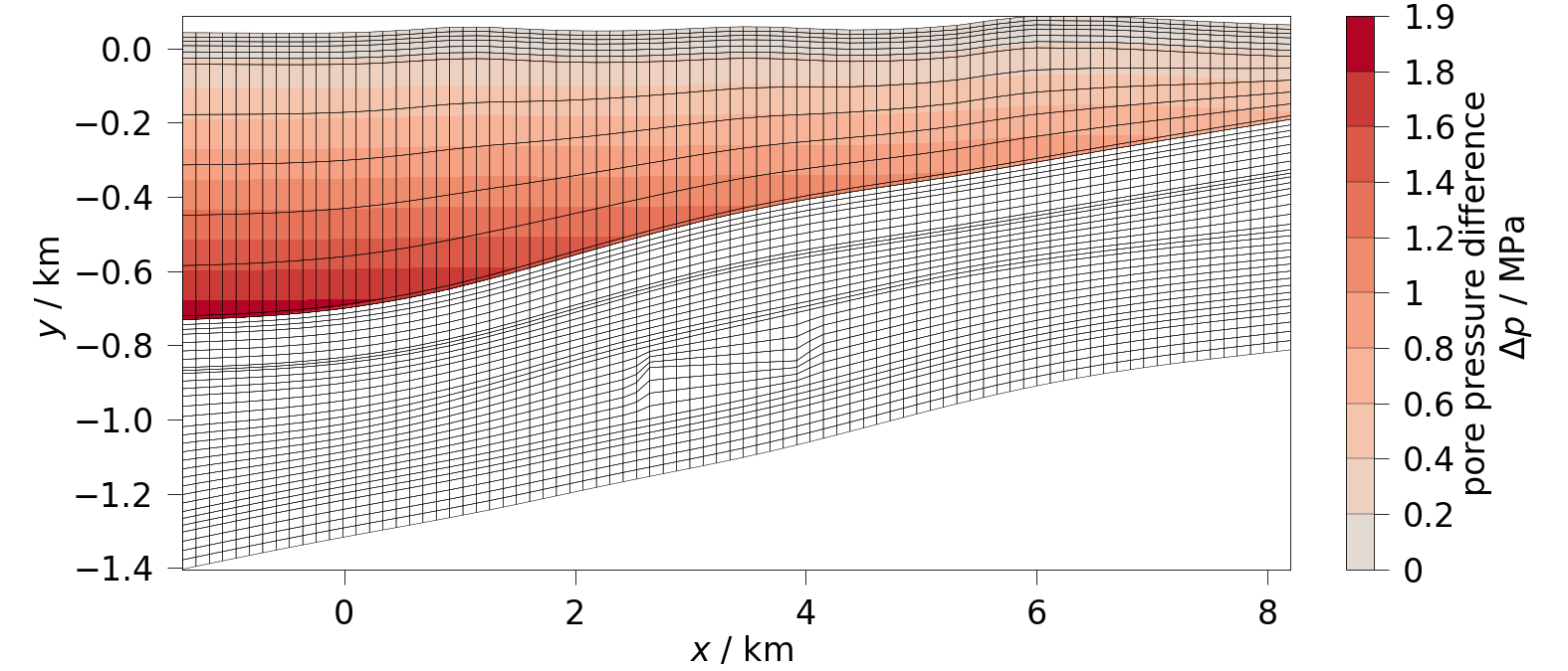

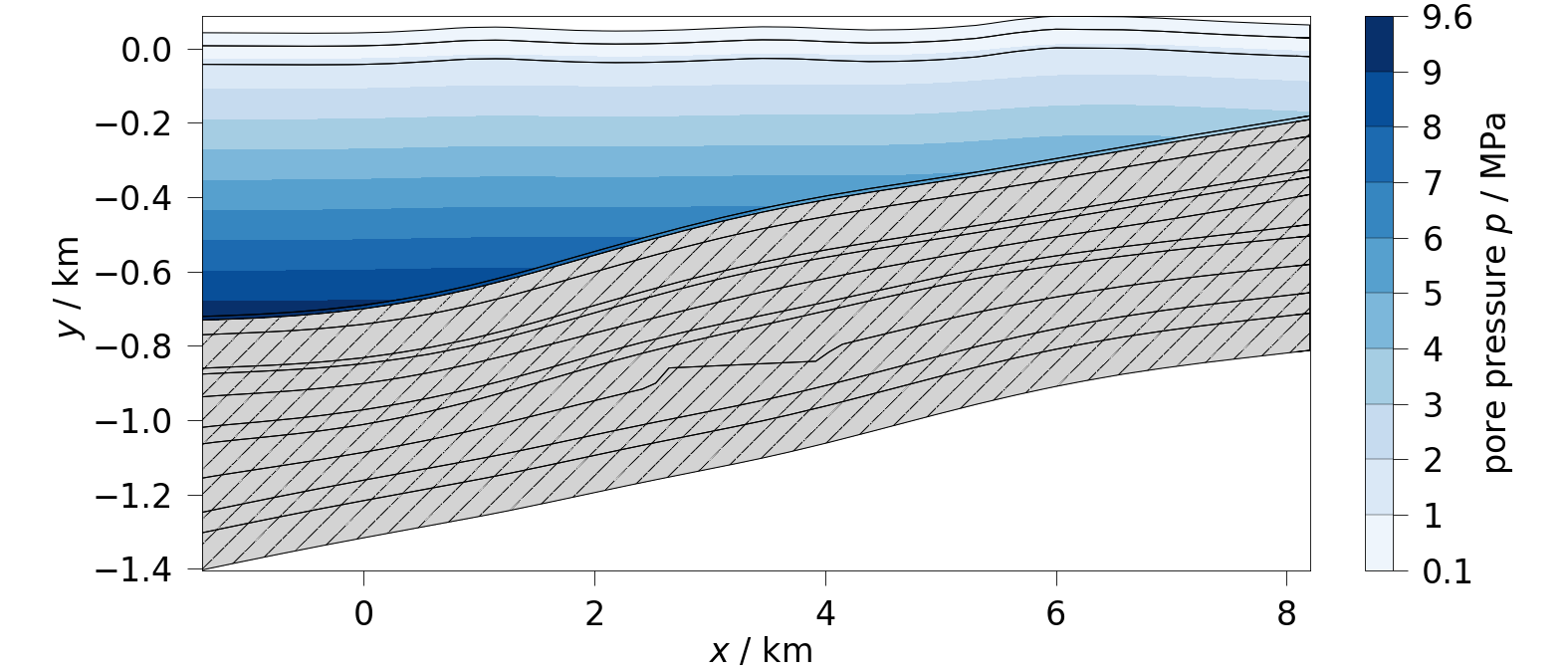

As a reference, the last steps of the original and altered MeshSeries can be plotted:
fig_T = ot.plot.contourf(ms[-1], ot.variables.pressure, show_edges=False)
plot calculate diff
fig_T_2 = ot.plot.contourf(ms2[-1], ot.variables.pressure, show_edges=False)
plot calculate diff
The MeshSeries object returned by the difference() method, can be used in the same way as any other one. However, to plot the pressure difference either use the string “pressure_difference” (see comment in the code block below) or the derived variable. ot.variable.pressure.difference.
fig_T_diff = ot.plot.contourf(
    diff_ms[-1], ot.variables.pressure.difference, show_edges=True
# fig_T_diff = ot.plot.contourf(diff_ms[-1], "pore_pressure_difference")
plot calculate diff
