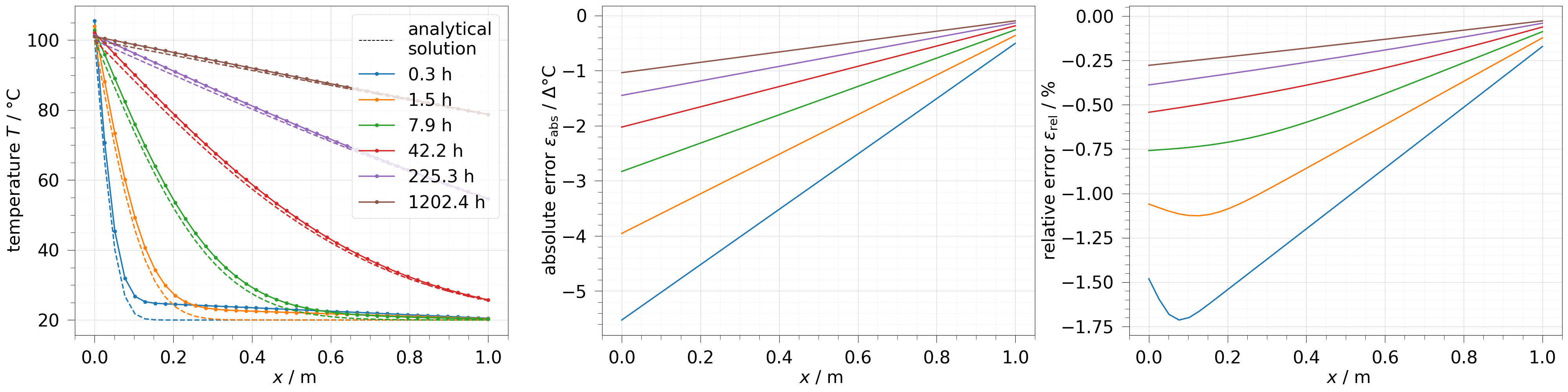

Comparing data over a line for multiple timesteps#
If the resulting data is not already one-dimensional we need to extract the points which make up the line of interest. We can do so, by using extract and the point indices or by using extract_probe and a set of points. We need to further select the timesteps we want to plot. This is done by indexing the MeshSeries object.
fig, axs = plt.subplots(1, 3, figsize=[40, 10])
# extract every second timestep and only the points on the x-axis
x_edge = results[::2].extract(
    (results[0].points[:, 1] == 0) & (results[0].points[:, 2] == 0)
labels = [f"{tv:.1f} h" for tv in x_edge.timevalues]
axs[0].plot([], [], "--k", label="analytical\nsolution")
x_edge.plot_line("x", temp, ax=axs[0], marker="o", labels=labels)
x_edge.plot_line("x", temp.anasol, ax=axs[0], ls="--")
x_edge.plot_line("x", temp.abs_error, ax=axs[1])
x_edge.plot_line("x", temp.rel_error, ax=axs[2])
plot analytical solution

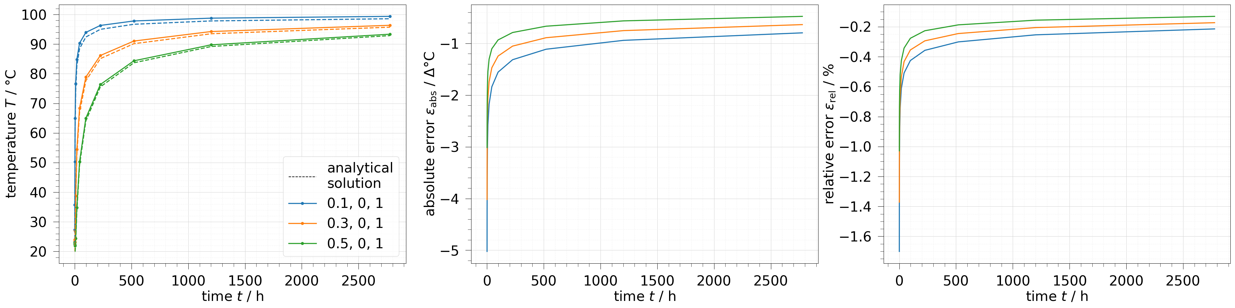

Comparing data of multiple points over time#
Here, we use the same strategy as before, but in the plot.line function, we specify, that we want to plot over the time dimension.
fig, axs = plt.subplots(1, 3, figsize=(40, 10))
pts = np.asarray([[0.1, 0, 1], [0.3, 0, 1], [0.5, 0, 1]])
probe = results.probe(pts)
labels = ot.plot.utils.justified_labels(pts)
probe.plot_line(temp, ax=axs[0], marker="o", labels=labels)
probe.plot_line(temp.anasol, ax=axs[0], ls="--")
probe.plot_line(temp.abs_error, ax=axs[1])
probe.plot_line(temp.rel_error, ax=axs[2])

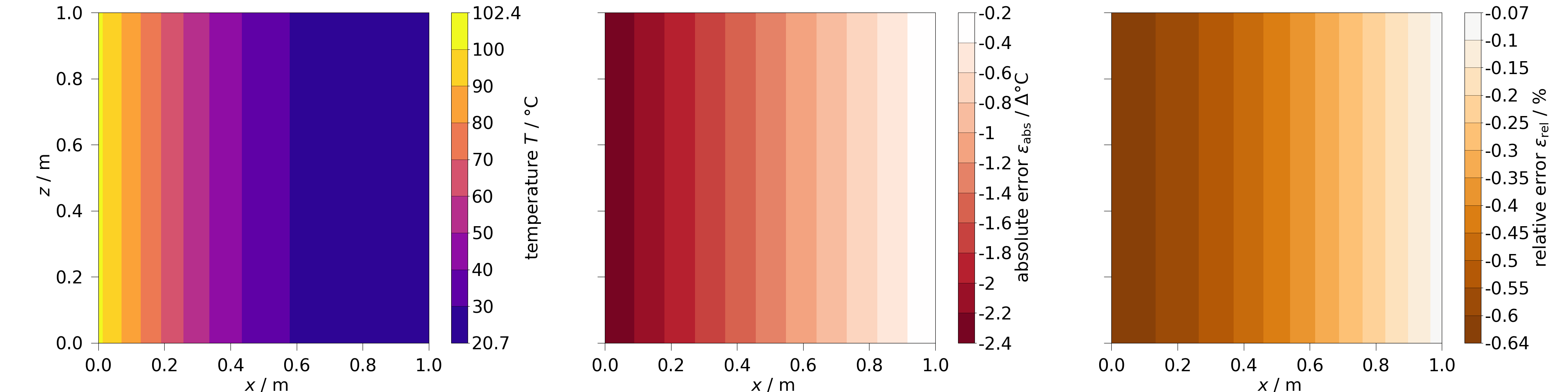

Comparing data of a 2D slice in a contourplot#
Again, we prepare the results, by extract the 2D data, we want to inspect. This can be done by slicing the original 3D results and selecting the timestep of interest.
fig, axs = plt.subplots(1, 3, figsize=[40, 10], sharey=True)
results_y_slice = results.transform(lambda mesh: mesh.slice("y"))
y_slice = results_y_slice[results.closest_timestep(20)]
ot.plot.contourf(y_slice, temp, fig=fig, ax=axs[0])
ot.plot.contourf(y_slice, temp.abs_error, fig=fig, ax=axs[1])
ot.plot.contourf(y_slice, temp.rel_error, fig=fig, ax=axs[2])

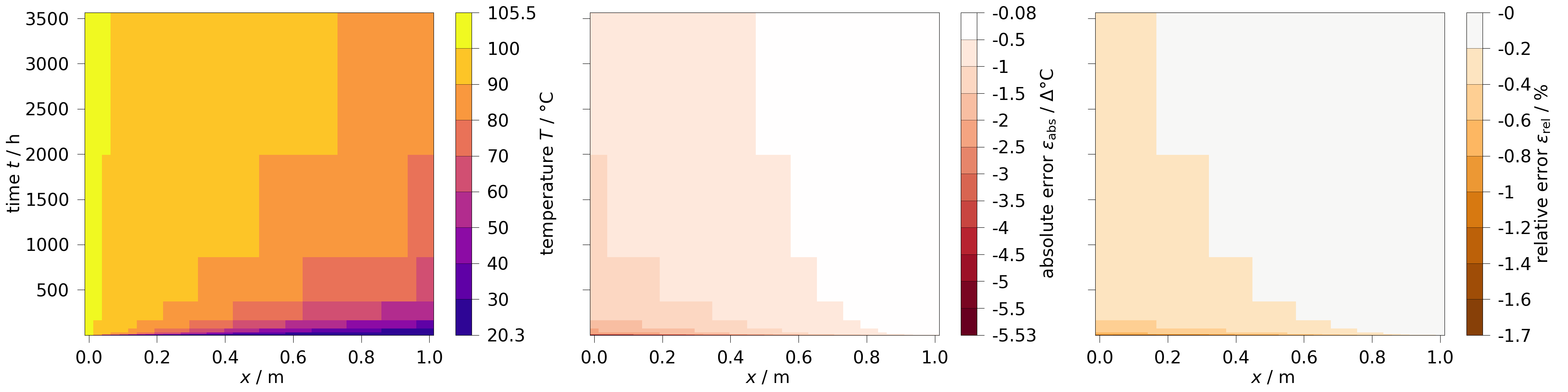

Comparing the transient data of a line#
Here, we extract a line and plot a timeslice, to evaluate the data spatially and temporally.
x_edge = results.extract(
x_edge.plot_time_slice("x", "time", temp, fig=fig, ax=axs[0])
x_edge.plot_time_slice("x", "time", temp.abs_error, fig=fig, ax=axs[1])
x_edge.plot_time_slice("x", "time", temp.rel_error, fig=fig, ax=axs[2])

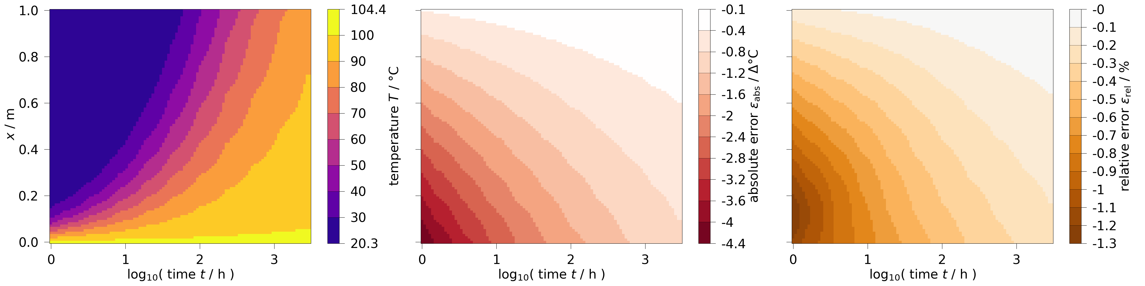

We can also increase the resolution, by using a large number of probing points and by resampling with more timesteps. Using a logarithmic scaling for the time is beneficial here, as most of the changes in the results happen in the very beginning.
line_pts = np.linspace([0, 0, 0], [1, 0, 0], num=100)
ms_line = results.probe(line_pts).resample_temporal(
    np.geomspace(1, 3000, num=100)
for i, var in enumerate([temp, temp.abs_error, temp.rel_error]):
    ms_line.plot_time_slice(
        "time", "x", var, fig=fig, ax=axs[i], time_logscale=True
