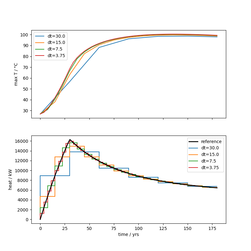

Let’s extract the temperature evolution and the applied heat via vtuIO and plot both:
time = np.append(0.0, np.geomspace(1.0, 180.0, num=100))
repo = physics.nuclearwasteheat.repo_2020_conservative
heat = repo.heat(time, time_unit="yrs", power_unit="kW")
fig, (ax1, ax2) = plt.subplots(figsize=(8, 8), nrows=2, sharex=True)
ax2.plot(time, heat, lw=2, label="reference", color="k")
for sim_result, dt in zip(sim_results, time_step_sizes, strict=False):
mesh_series = ot.MeshSeries(sim_result).scale(time=("s", "yrs"))
results = {"heat_flux": [], "temperature": []}
for ts in mesh_series.timesteps:
mesh = mesh_series.mesh(ts)
results["temperature"] += [np.max(mesh.point_data["temperature"])]
max_T = ot.variables.temperature.transform(results["temperature"])
# times 2 due to symmetry, area of repo, to kW
results["heat_flux"] += [np.max(mesh.point_data["heat_flux"][:, 0])]
tv = np.asarray(mesh_series.timevalues)
ax1.plot(tv, max_T, lw=1.5, label=f"{dt=}")
edges = np.append(0, tv)
mean_t = 0.5 * (edges[1:] + edges[:-1])
applied_heat = repo.heat(mean_t, time_unit="yrs", power_unit="kW")
ax2.stairs(applied_heat, edges, lw=1.5, label=f"{dt=}", baseline=None)
ax2.set_xlabel("time / yrs")
ax1.set_ylabel("max T / °C")
ax2.set_ylabel("heat / kW")
ax1.legend()
ax2.legend()
fig.show()

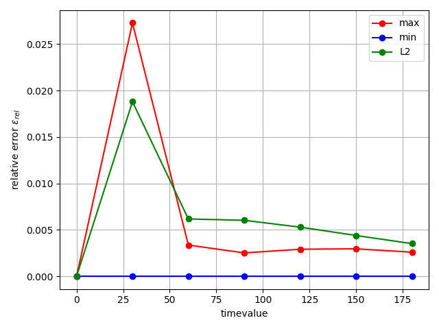

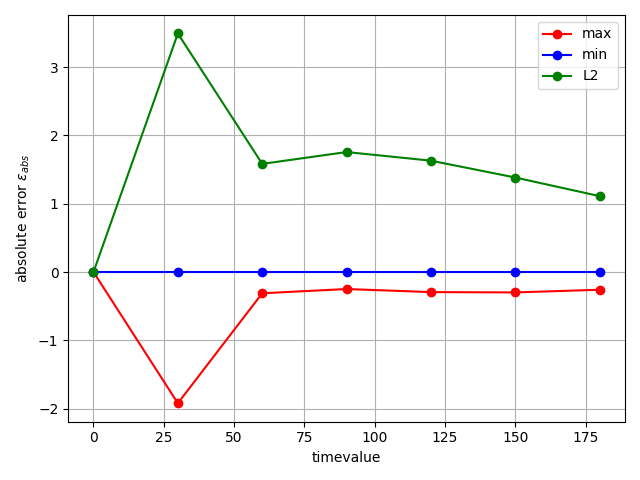

Looking at the errors, we see a higher error right at the beginning. This is likely due to the more dynamic behavior at the beginning.
fig = studies.convergence.plot_convergence_error_evolution(
evolution_metrics, error_type="absolute"
evolution_metrics, error_type="relative"

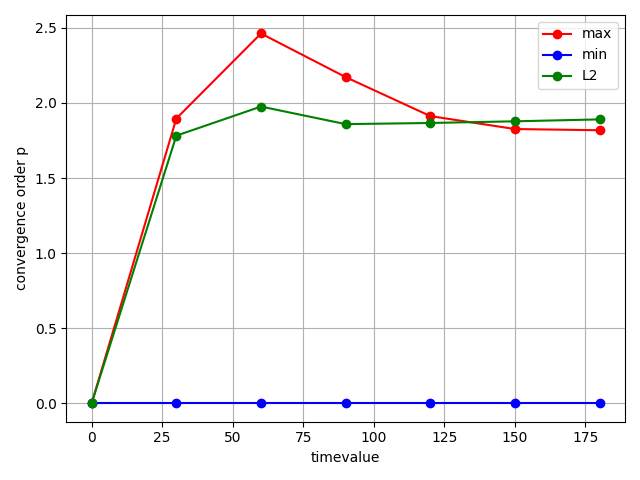

A look at the convergence order evolution shows almost quadratic convergence over the whole timeframe. For the maximum temperature we even get better than quadratic behavior, which is coincidentally and most likely model dependent.
fig = studies.convergence.plot_convergence_order_evolution(evolution_metrics)
