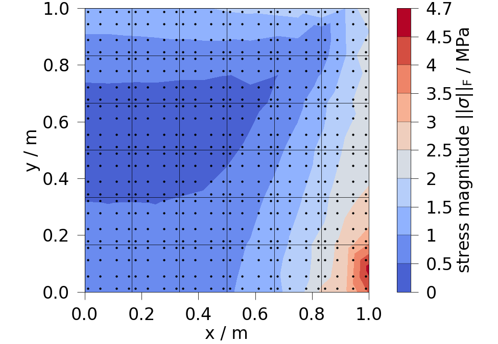

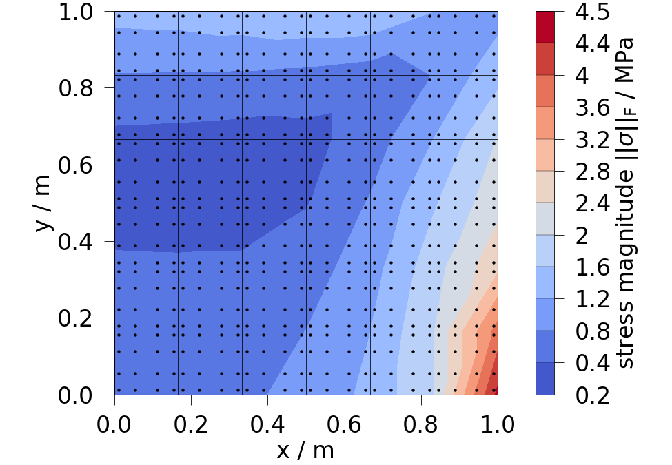

mesh = ot.MeshSeries(case_path / "mesh.pvd").mesh(-1)
int_pts = mesh.to_ip_point_cloud()

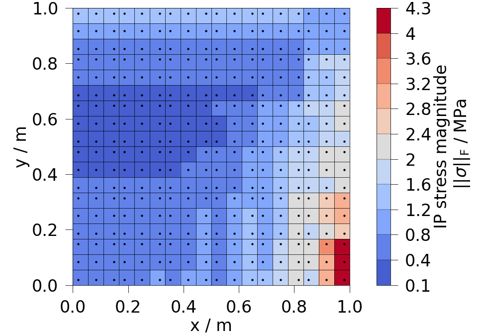

ip_mesh = mesh.to_ip_mesh()
fig = mesh.plot_contourf(ot.variables.stress)
fig.axes[0].scatter(
int_pts.points[:, 0], int_pts.points[:, 1], color="k", s=10
fig = ip_mesh.plot_contourf(sigma_ip)

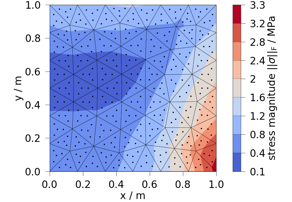

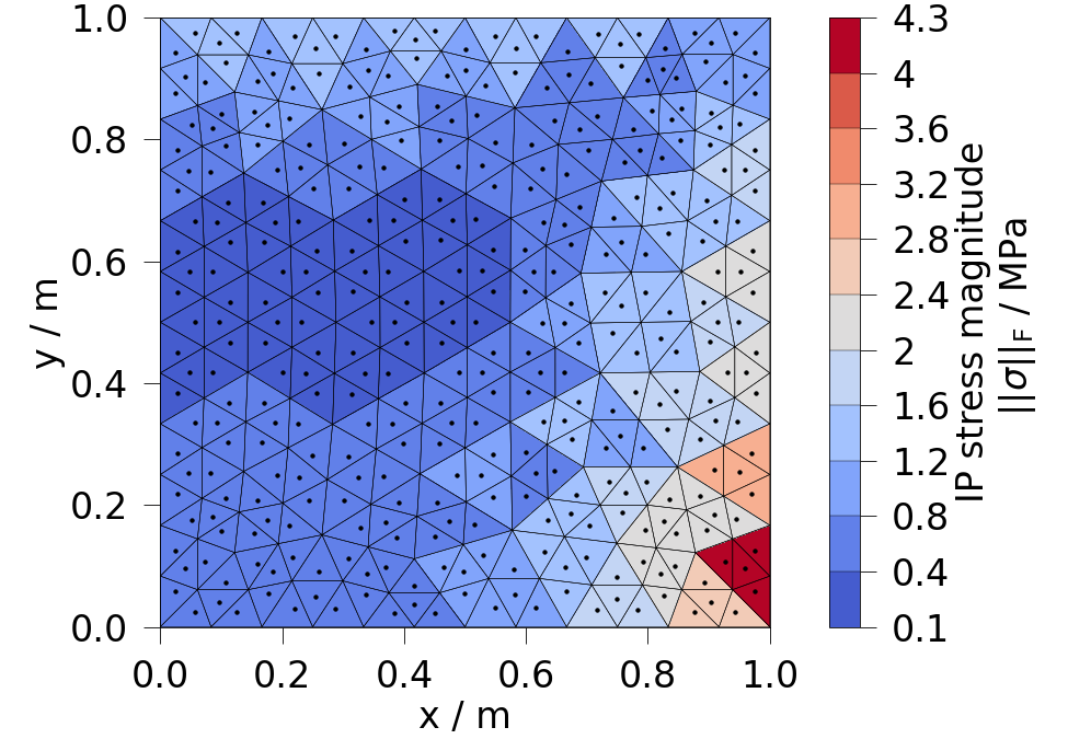

Triangles with increasing integration point order#
Why does the stress not change with the integration point order?
In linear triangular finite elements, the shape functions used to interpolate displacements are linear functions of the coordinates. As this is a linear elastic example, the displacements are linear. The strain, which is obtained by differentiating the displacement, will thus be constant throughout the element. The stress, which is related to the strain through a constitutive relationship will also be constant throughout the element. Thus, the stress is not affected by the integration point order.

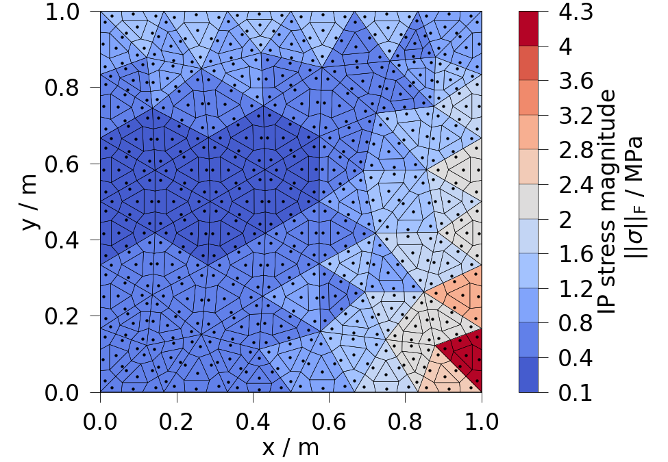

simulate_and_plot(elem_order=1, quads=False, intpt_order=3)
Simulation: /tmp/tmpx8r9u6cg/default.prj
Execution took 0.13795018196105957 s

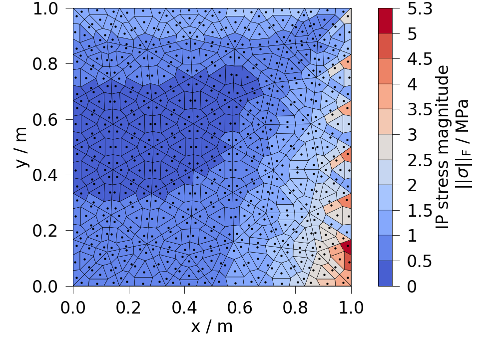

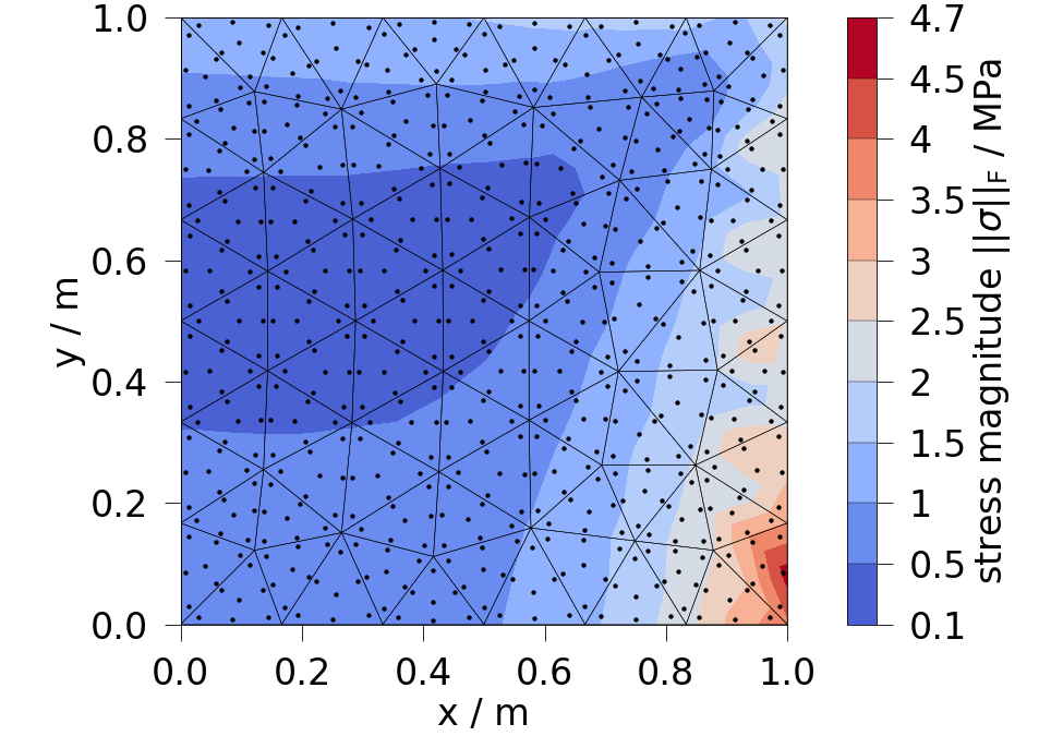

Quadratic triangles#
simulate_and_plot(elem_order=2, quads=False, intpt_order=4)
Simulation: /tmp/tmpi1cjm5z7/default.prj
Execution took 0.1482372283935547 s

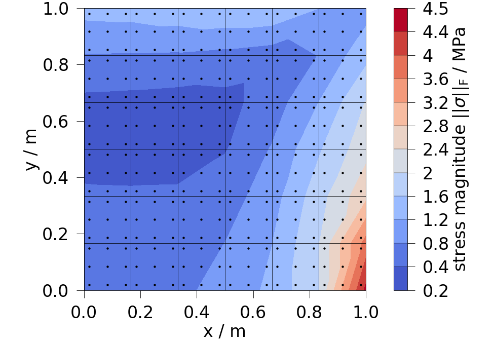

Quadrilaterals with increasing integration point order#

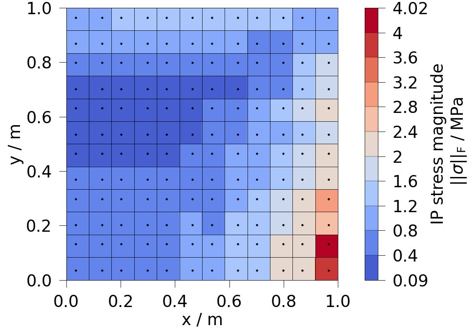

Why does the stress change here?
In contrast to triangular elements, quadrilateral elements use bilinear shape functions. Thus, the differentiation of the displacement leads to bilinear strain. The stress in turn is bilinear as well and can change within the elements. The number of integration points consequently affects the resulting stress field.
simulate_and_plot(elem_order=1, quads=True, intpt_order=2)
Simulation: /tmp/tmpn5hjrghr/default.prj
Execution took 0.13732290267944336 s

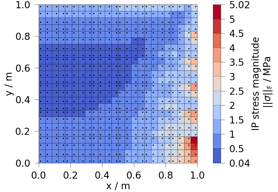

simulate_and_plot(elem_order=1, quads=True, intpt_order=4)
Simulation: /tmp/tmp8uzzm1z4/default.prj
Execution took 0.13892340660095215 s
