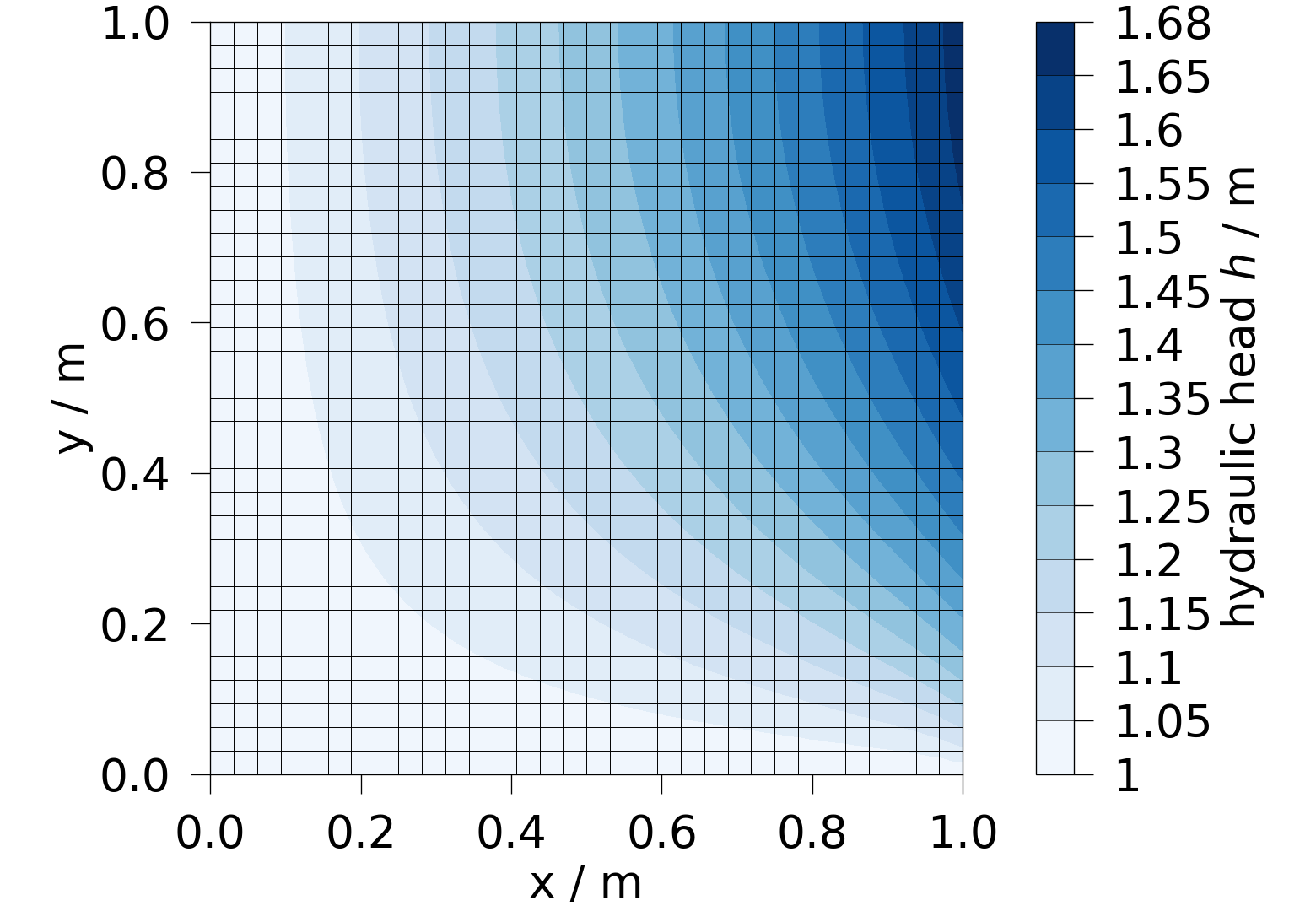

Here we calculate the analytical solution on one of the meshes:
analytical_solution_path = tmp_path / "analytical_solution.vtu"
solution = examples.anasol.diffusion_head_analytical(
ot.MeshSeries(result_paths[-1]).mesh(0)
fig = ot.plot.contourf(solution, ot.variables.hydraulic_head)
solution.save(analytical_solution_path)
