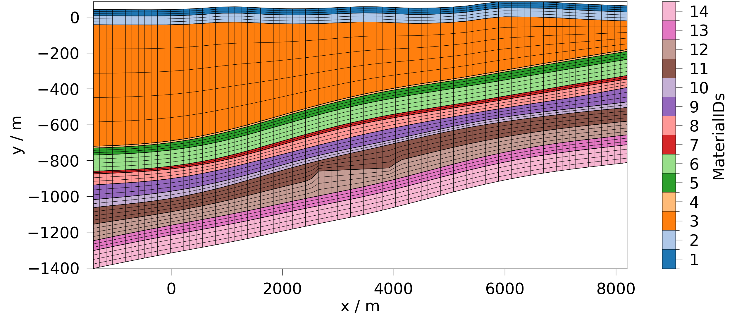

mesh = examples.load_meshseries_THM_2D_PVD().mesh(1)
elements.
fig = mesh.plot_contourf(ot.variables.material_id)

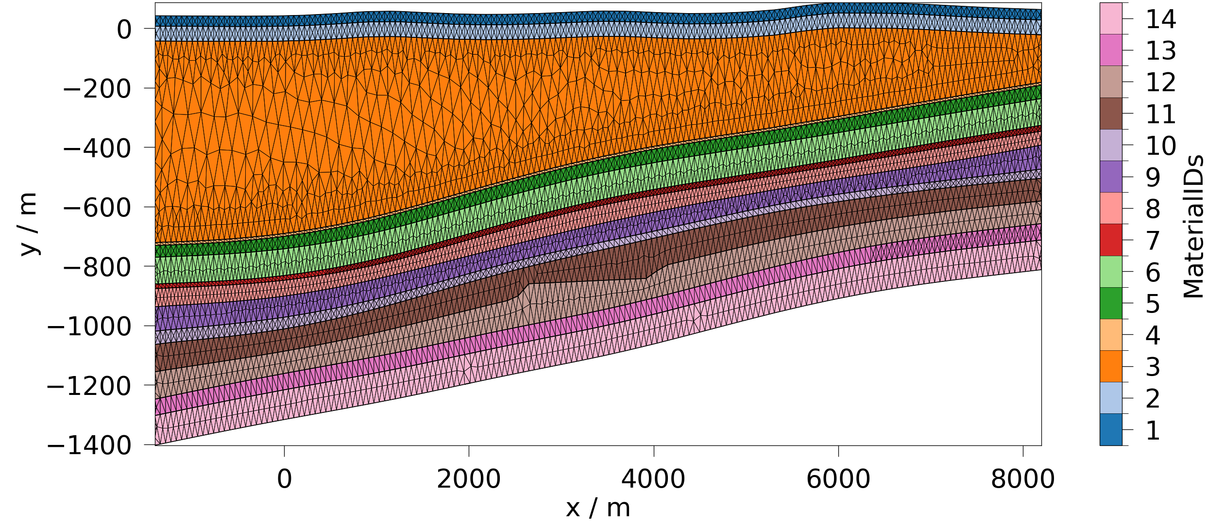

Here, we do the remeshing and convert the resulting msh file to an OGS-compatible vtu file.
temp_dir = Path(mkdtemp())
msh_path = temp_dir / "tri_mesh.msh"
ot.meshlib.gmsh_meshing.remesh_with_triangles(mesh, msh_path)
meshes = ot.Meshes.from_gmsh(msh_path, reindex=False, log=False)
fig = meshes["domain"].plot_contourf(ot.variables.material_id)
