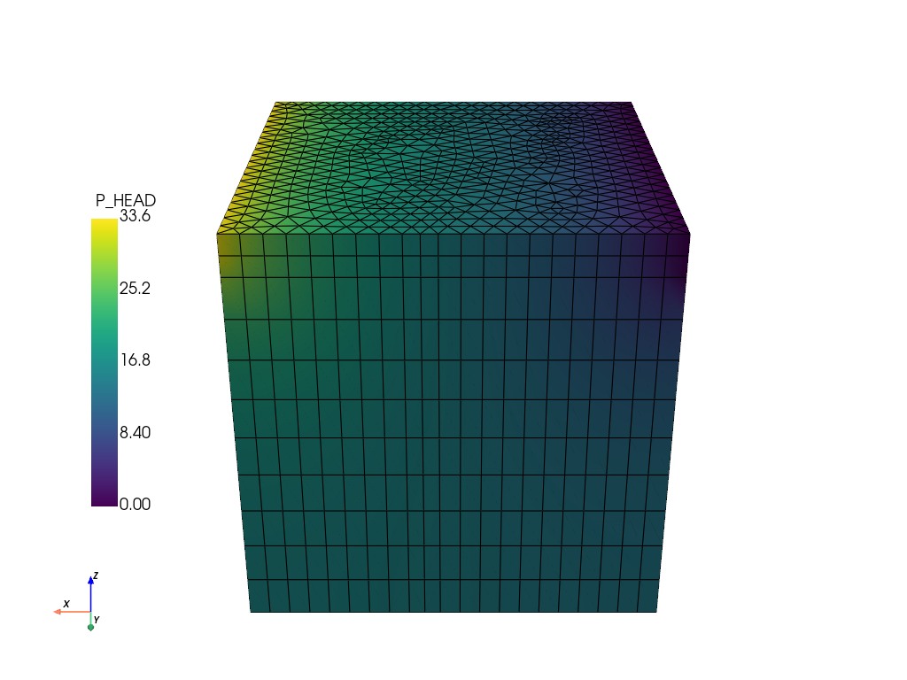

feflow_model = FeflowModel(feflow_model_box_Neumann, temp_dir / "boxNeumann")
pv.global_theme.colorbar_orientation = "vertical"
feflow_model.mesh.plot(
show_edges=True,
off_screen=True,
scalars="P_HEAD",
cpos=[0, 1, 0.5],
scalar_bar_args={"position_x": 0.1, "position_y": 0.25},
print(feflow_model.mesh)
UnstructuredGrid (0x703880c16e60)
N Cells: 11462
N Points: 6768
X Bounds: 0.000e+00, 1.000e+02
Y Bounds: 0.000e+00, 1.000e+02
Z Bounds: -1.000e+02, 0.000e+00
N Arrays: 23

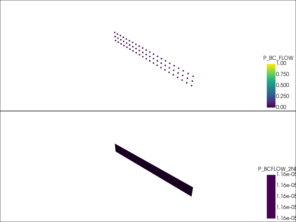

Extract the subdomains conditions.
subdomains = feflow_model.subdomains
# Since there can be multiple boundary conditions in the subdomains,
# they are plotted iteratively.
plotter = pv.Plotter(shape=(len(subdomains), 1))
for i, (name, boundary_condition) in enumerate(subdomains.items()):
# topsurface refers to a cell based boundary condition.
if name != "topsurface":
plotter.subplot(i, 0)
plotter.add_mesh(boundary_condition, scalars=name)
plotter.show()

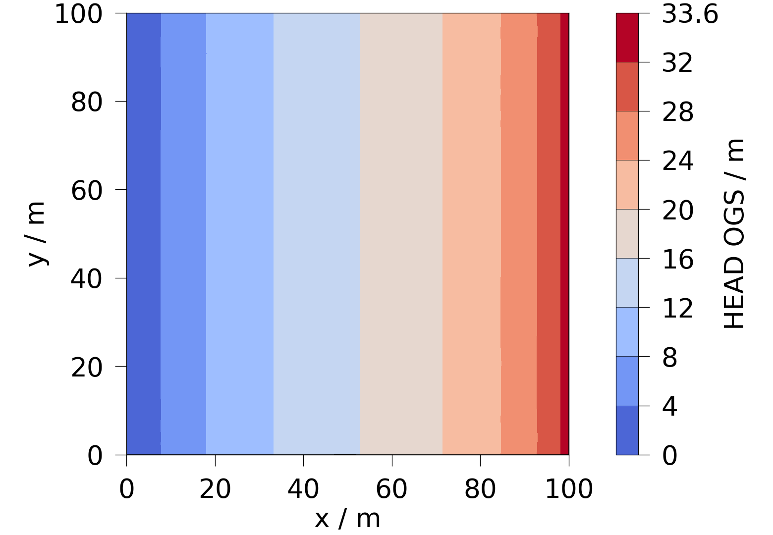

5.1 Plot the hydraulic head simulated in OGS with ogstools.plot.contourf.
head = ot.variables.Scalar(data_name="HEAD_OGS", data_unit="m", output_unit="m")
fig = ot.plot.contourf(ogs_sim_res.slice(normal="z", origin=[50, 50, 0]), head)

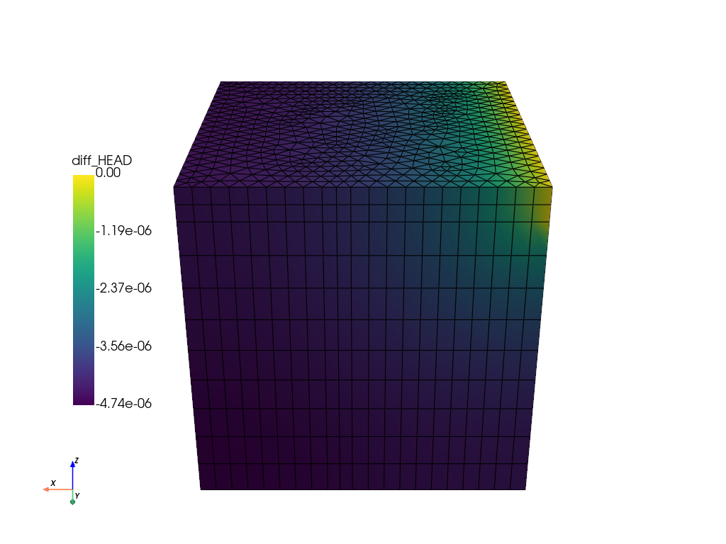

Calculate the difference to the FEFLOW simulation and plot it.
diff = feflow_model.mesh["P_HEAD"] - ogs_sim_res["HEAD_OGS"]
feflow_model.mesh["diff_HEAD"] = diff
show_edges=True,
off_screen=True,
scalars="diff_HEAD",
cpos=[0, 1, 0.5],

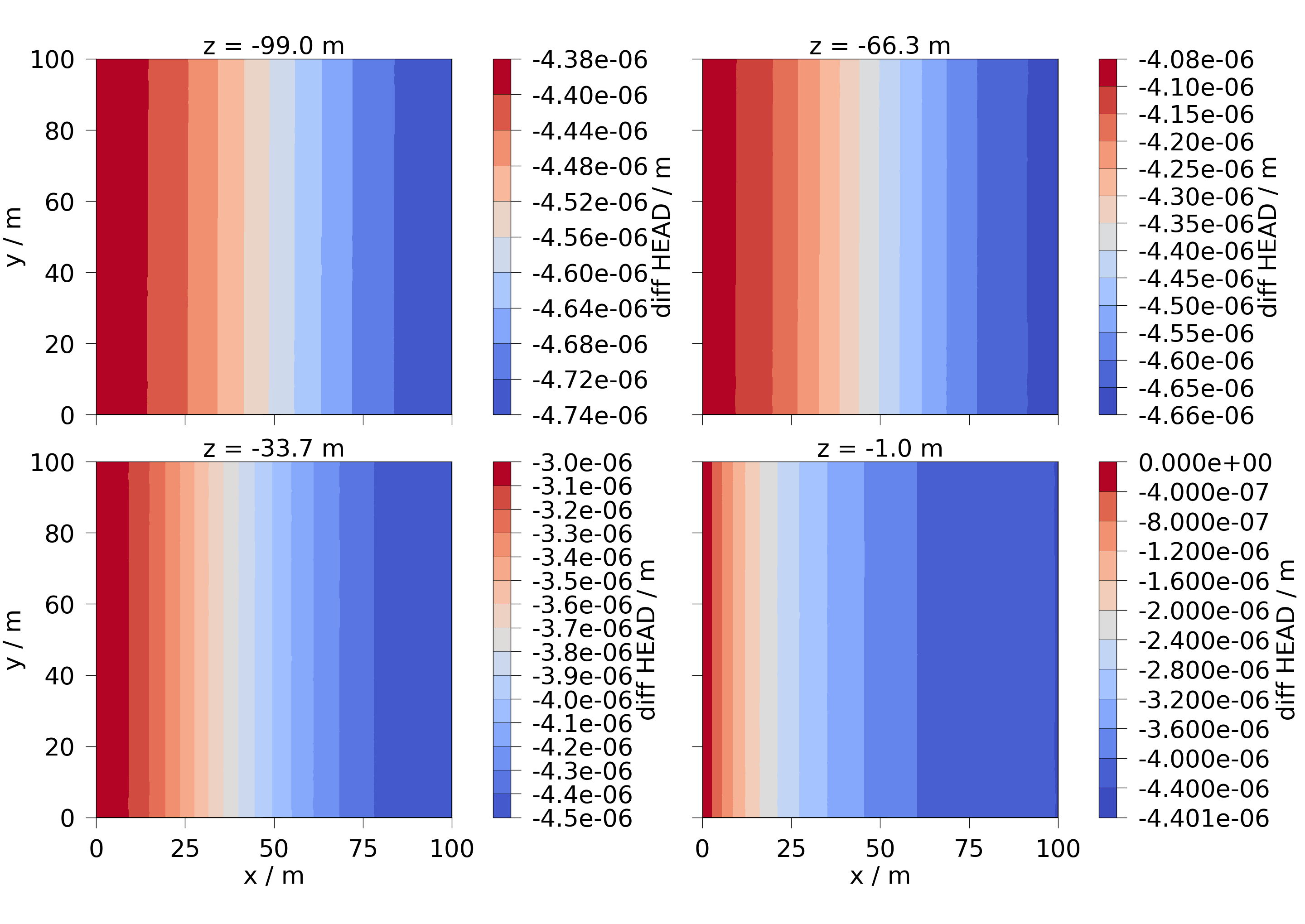

6.1 Plot the differences in the hydraulic head with ogstools.plot.contourf.
Slices are taken along the z-axis.
diff_head = ot.variables.Scalar(
data_name="diff_HEAD", data_unit="m", output_unit="m"
slices = np.reshape(
list(feflow_model.mesh.slice_along_axis(n=4, axis="z")), (2, 2)
fig = ot.plot.contourf(slices, diff_head)
for ax, slice in zip(fig.axes, np.ravel(slices), strict=False):
ax.set_title(f"z = {slice.center[2]:.1f} m", fontsize=32)

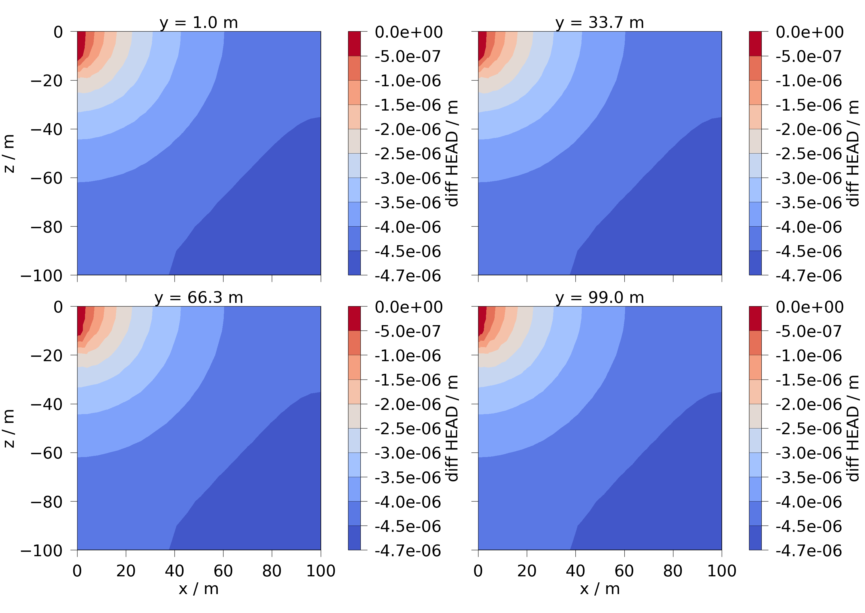

6.2 Slices are taken along the y-axis.
list(feflow_model.mesh.slice_along_axis(n=4, axis="y")), (2, 2)
ax.set_title(f"y = {slice.center[1]:.1f} m", fontsize=32)
