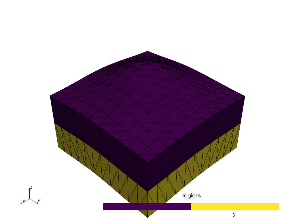

Visualize the prism mesh
mesh.plot(scalars="regions", show_edges=True)
