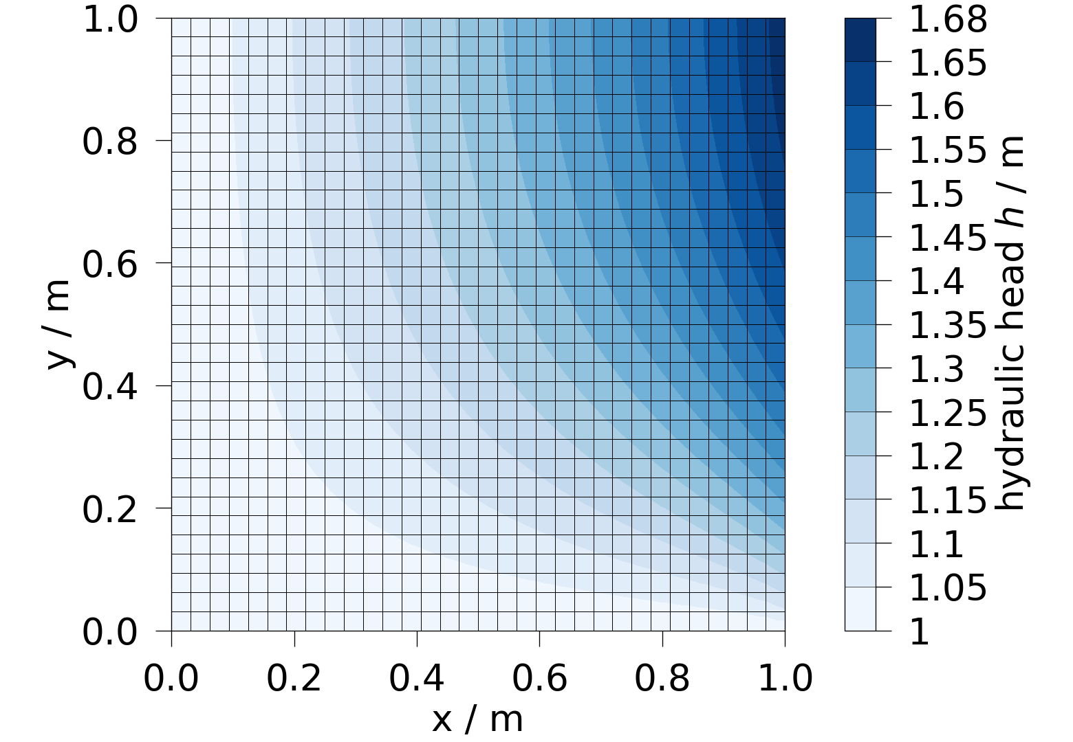

Here we calculate the analytical solution on one of the meshes:
analytical_solution_path = temp_dir / "analytical_solution.vtu"
solution = examples.anasol.diffusion_head_analytical(
ot.MeshSeries(result_paths[-1]).mesh(0)
fig = ot.plot.contourf(solution, ot.variables.hydraulic_head)
solution.save(analytical_solution_path)

The pressure field of this model is converging well. The convergence ratio is approximately 1 on the whole mesh and looking at the relative errors we see a quadratic convergence behavior.
