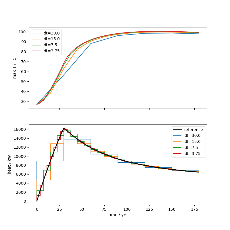

Let’s extract the temperature evolution and the applied heat via vtuIO and plot both:
time = np.append(0.0, np.geomspace(1.0, 180.0, num=100))
repo = physics.nuclearwasteheat.repo_2020_conservative
heat = repo.heat(time, time_unit="yrs", power_unit="kW")
fig, (ax1, ax2) = plt.subplots(figsize=(8, 8), nrows=2, sharex=True)
ax2.plot(time, heat, lw=2, label="reference", color="k")
for sim_result, dt in zip(sim_results, time_step_sizes, strict=False):
mesh_series = ot.MeshSeries(sim_result).scale(time=("s", "yrs"))
results = {"heat_flux": [], "temperature": []}
for ts in mesh_series.timesteps:
mesh = mesh_series.mesh(ts)
results["temperature"] += [np.max(mesh.point_data["temperature"])]
max_T = ot.variables.temperature.transform(results["temperature"])
# times 2 due to symmetry, area of repo, to kW
results["heat_flux"] += [np.max(mesh.point_data["heat_flux"][:, 0])]
tv = np.asarray(mesh_series.timevalues)
ax1.plot(tv, max_T, lw=1.5, label=f"{dt=}")
edges = np.append(0, tv)
mean_t = 0.5 * (edges[1:] + edges[:-1])
applied_heat = repo.heat(mean_t, time_unit="yrs", power_unit="kW")
ax2.stairs(applied_heat, edges, lw=1.5, label=f"{dt=}", baseline=None)
ax2.set_xlabel("time / yrs")
ax1.set_ylabel("max T / °C")
ax2.set_ylabel("heat / kW")
ax1.legend()
ax2.legend()
fig.show()

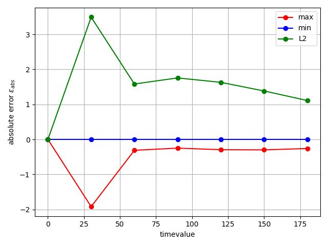

We can also run the convergence evaluation on all timesteps and look at the relative errors (between finest discretization and Richardson extrapolation) and the convergence order over time to get a better picture of the transient model behavior.
mesh_series = [ot.MeshSeries(sim_result) for sim_result in sim_results]
evolution_metrics = studies.convergence.convergence_metrics_evolution(
mesh_series, ot.variables.temperature, units=["s", "yrs"]
0%| | 0/7 [00:00<?, ?it/s]
43%|████▎ | 3/7 [00:00<00:00, 21.58it/s]
86%|████████▌ | 6/7 [00:00<00:00, 20.34it/s]
100%|██████████| 7/7 [00:00<00:00, 20.35it/s]

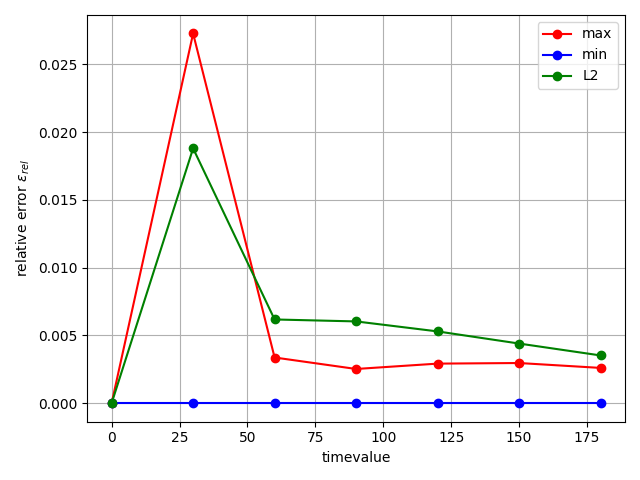

Looking at the errors, we see a higher error right at the beginning. This is likely due to the more dynamic behavior at the beginning.
fig = studies.convergence.plot_convergence_error_evolution(
evolution_metrics, error_type="absolute"
evolution_metrics, error_type="relative"

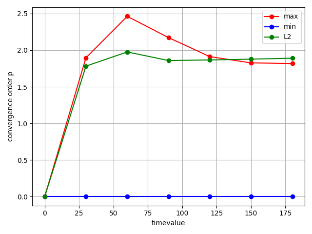

A look at the convergence order evolution shows almost quadratic convergence over the whole timeframe. For the maximum temperature we even get better than quadratic behavior, which is coincidentally and most likely model dependent.
fig = studies.convergence.plot_convergence_order_evolution(evolution_metrics)
