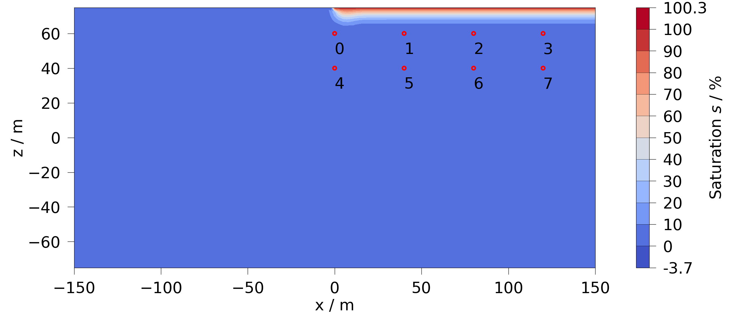

Let’s define 4 observation points and plot them on the mesh.
rows = np.array([np.linspace([0, 0, z], [120, 0, z], 4) for z in [60, 40]])
fig = mesh_series.mesh(0).plot_contourf(si)
fig.axes[0].scatter(rows[..., 0], rows[..., 2], s=50, fc="none", ec="r", lw=3)
for i, pt in enumerate(rows.reshape(-1, 3)):
fig.axes[0].annotate(str(i), (pt[0], pt[2] - 5), va="top", fontsize=32)

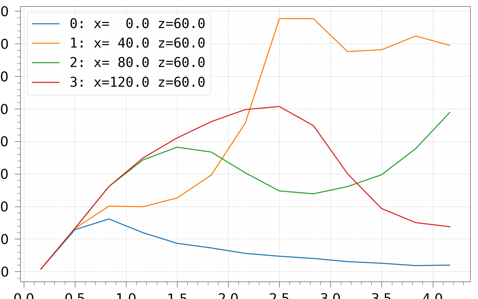

And now probe the points and plot the values over time.
labels = [
[f"{i}: x={pt[0]: >5} z={pt[2]}" for i, pt in enumerate(pts)]
for pts in rows
ms_pts = [ot.MeshSeries.extract_probe(mesh_series, pts) for pts in rows]
fig = ot.plot.line(ms_pts[0], "time", si, labels=labels[0], monospace=True)

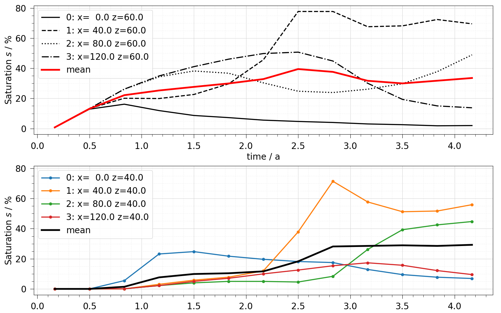

You can also pass create your own matplotlib figure and pass the axes object. Additionally, you can pass any keyword arguments which are known by matplotlibs plot function to further customize the curves. To show, how to customize a plot afterwards, we add the mean saturation of the 4 observation points per row to each subplot.
fig, axs = plt.subplots(nrows=2, figsize=[16, 10], sharey=True)
ot.plot.line(ms_pts[0], "time", si, ax=axs[0], color="k", fontsize=20)
ot.plot.line(ms_pts[1], "time", si, ax=axs[1], marker="o", fontsize=20)
# add the mean of the observation point timeseries
for index in range(2):
values = si.transform(ms_pts[index])
mean_values = np.mean((values), axis=-1)
ts = ms_pts[index].timevalues
fig.axes[index].plot(ts, mean_values, "rk"[index], lw=4)
fig.axes[index].legend(labels[index] + ["mean"], fontsize=20)
