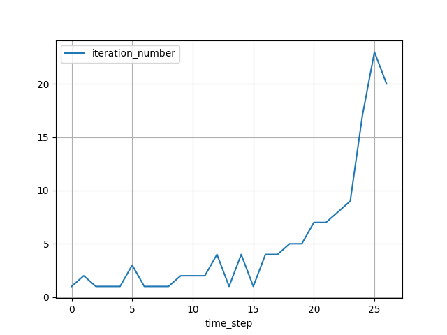

Here we are interested in every time step of the simulation and how many
iterations have been needed.
The predefined analyses only work with logs from ogs run with level info or finer (debug), like ogs -l info or ogs - l debug.
(see
OGS Developer Guide - log and debug output
# The result is a pandas.DataFrame. You may manipulate the dataframe to your
# needs with pandas functionality.
pd.set_option("display.max_rows", 8) # for visualization only
df_ts_it
Pandas to plot#
You can directly use
plot
<https://pandas.pydata.org/pandas-docs/stable/reference/api/pandas.DataFrame.plot.html>`_ from pandas.
df_ts_it.plot(grid=True)
<Axes: xlabel='time_step'>
