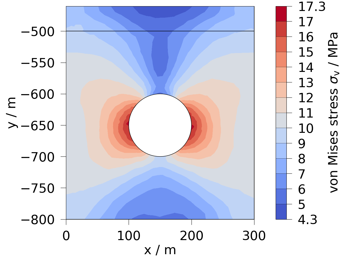

These can be reused in different kind of post processing. When plotting
with ogstools.plot we can use these presets to simplify the
task of processing the data (e.g. calculate the von Mises stress):
fig = ot.plot.contourf(
examples.load_mesh_mechanics_2D(), ot.variables.stress.von_Mises
Have a look at Plotting the data for more examples.
