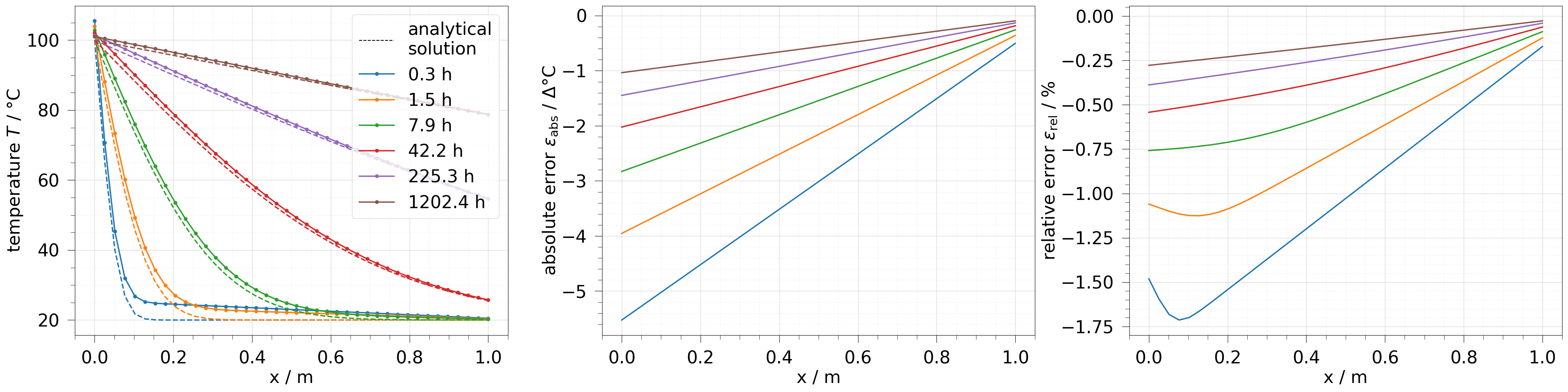

Comparing data over a line for multiple timesteps#
If the resulting data is not already one-dimensional we need to extract the
points which make up the line of interest. We can do so, by using extract
and the point indices or by using extract_probe and a set of points.
We need to further select the timesteps we want to plot. This is done by
indexing the MeshSeries object.
fig, axs = plt.subplots(1, 3, figsize=[40, 10])
# extract every second timestep and only the points on the x-axis
x_edge = results[::2].extract(
(results[0].points[:, 1] == 0) & (results[0].points[:, 2] == 0)
labels = [f"{tv:.1f} h" for tv in x_edge.timevalues]
axs[0].plot([], [], "--k", label="analytical\nsolution")
ot.plot.line(x_edge, temp, ax=axs[0], marker="o", labels=labels)
ot.plot.line(x_edge, temp.anasol, ax=axs[0], ls="--")
ot.plot.line(x_edge, temp.abs_error, ax=axs[1])
ot.plot.line(x_edge, temp.rel_error, ax=axs[2])

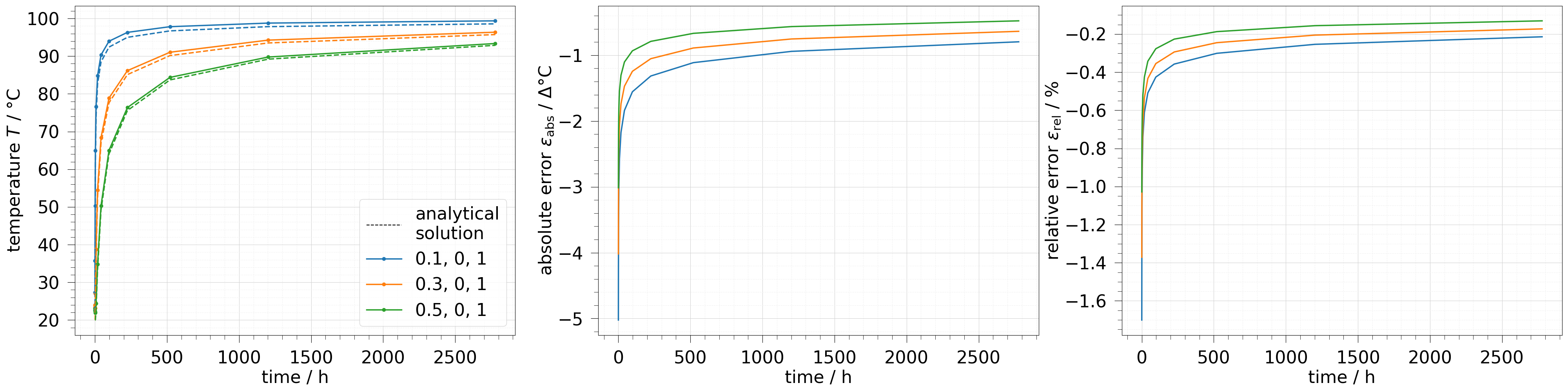

Comparing data of multiple points over time#
Here, we use the same strategy as before, but in the plot.line function,
we specify, that we want to plot over the time dimension.
fig, axs = plt.subplots(1, 3, figsize=(40, 10))
pts = np.asarray([[0.1, 0, 1], [0.3, 0, 1], [0.5, 0, 1]])
probe = ot.MeshSeries.extract_probe(results, pts)
labels = ot.plot.utils.justified_labels(pts)
ot.plot.line(probe, "time", temp, ax=axs[0], marker="o", labels=labels)
ot.plot.line(probe, "time", temp.anasol, ax=axs[0], ls="--")
ot.plot.line(probe, "time", temp.abs_error, ax=axs[1])
ot.plot.line(probe, "time", temp.rel_error, ax=axs[2])

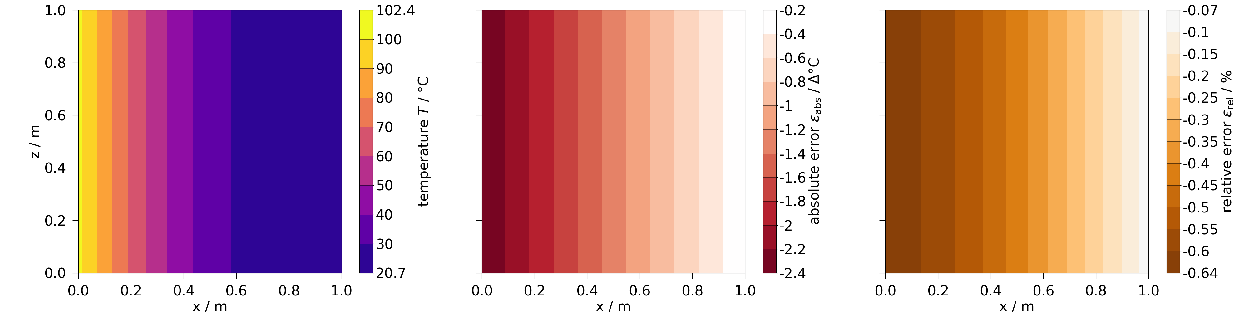

Comparing data of a 2D slice in a contourplot#
Again, we prepare the results, by extract the 2D data, we want to inspect. This can be done by slicing the original 3D results and selecting the timestep of interest.
fig, axs = plt.subplots(1, 3, figsize=[40, 10], sharey=True)
results_y_slice = results.transform(lambda mesh: mesh.slice("y"))
y_slice = results_y_slice[results.closest_timestep(20)]
y_slice.plot_contourf(temp, fig=fig, ax=axs[0])
y_slice.plot_contourf(temp.abs_error, fig=fig, ax=axs[1])
y_slice.plot_contourf(temp.rel_error, fig=fig, ax=axs[2])

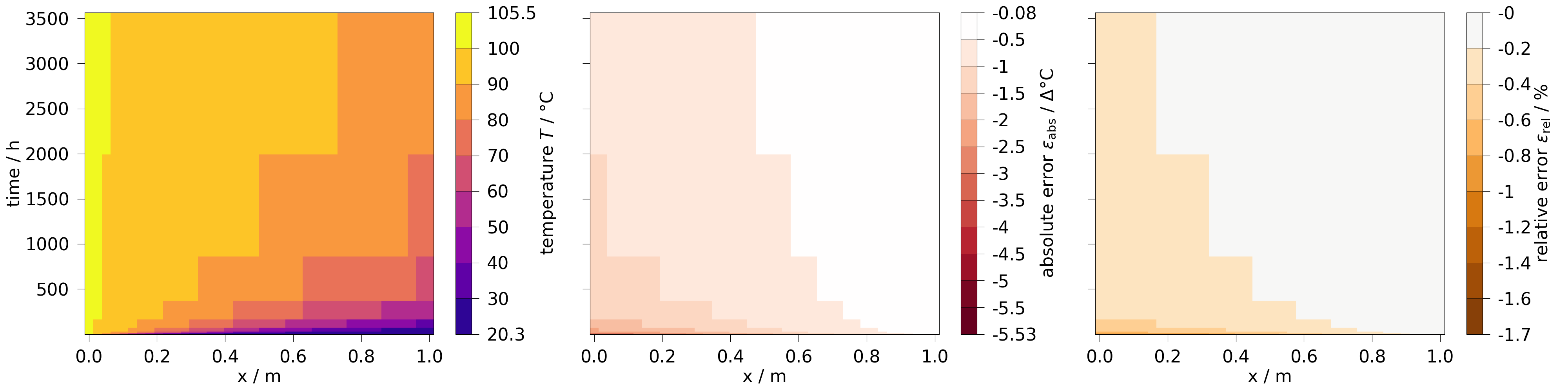

Comparing the transient data of a line#
Here, we extract a line and plot a timeslice, to evaluate the data spatially and temporally.
x_edge = results.extract(
x_edge.plot_time_slice("x", "time", temp, fig=fig, ax=axs[0])
x_edge.plot_time_slice("x", "time", temp.abs_error, fig=fig, ax=axs[1])
x_edge.plot_time_slice("x", "time", temp.rel_error, fig=fig, ax=axs[2])

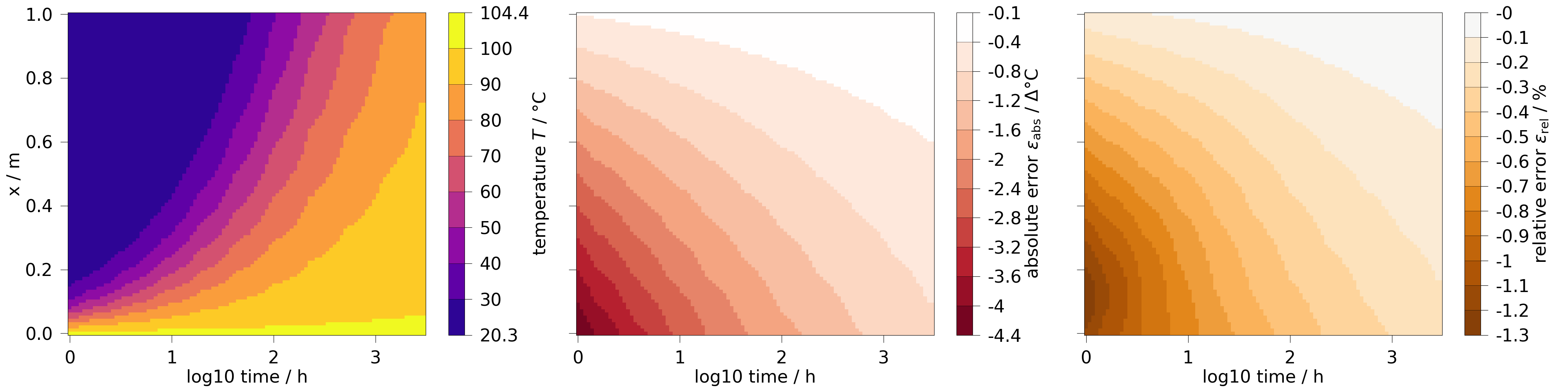

We can also increase the resolution, by using a large number of probing points and by resampling with more timesteps. Using a logarithmic scaling for the time is beneficial here, as most of the changes in the results happen in the very beginning.
line_pts = np.linspace([0, 0, 0], [1, 0, 0], num=100)
ms_line = ot.MeshSeries.extract_probe(results, line_pts)
ms_line = ot.MeshSeries.resample(ms_line, np.geomspace(1, 3000, num=100))
for i, var in enumerate([temp, temp.abs_error, temp.rel_error]):
ms_line.plot_time_slice(
"time", "x", var, fig=fig, ax=axs[i], time_logscale=True
