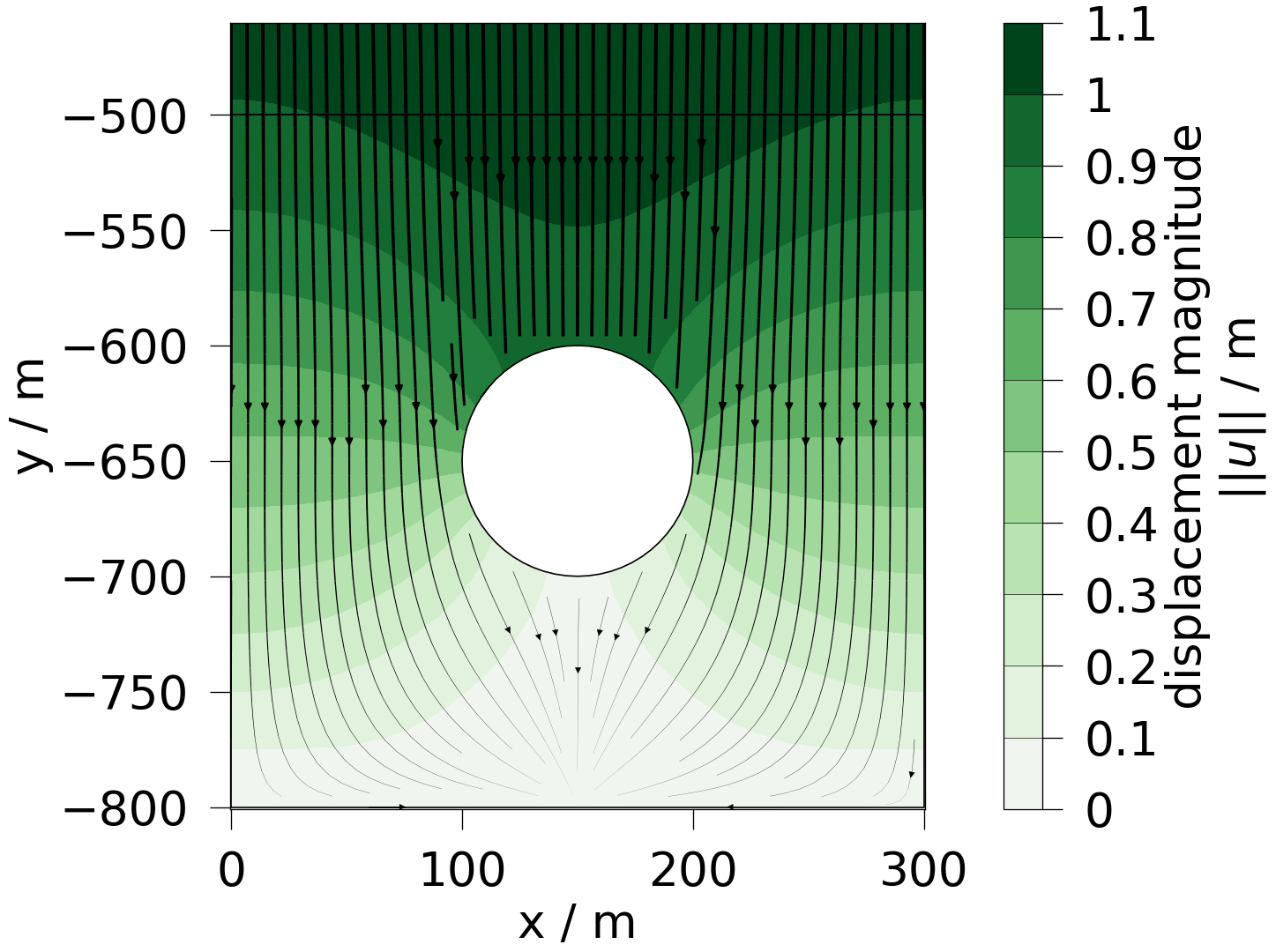

fig = mesh.plot_contourf(ot.variables.displacement)

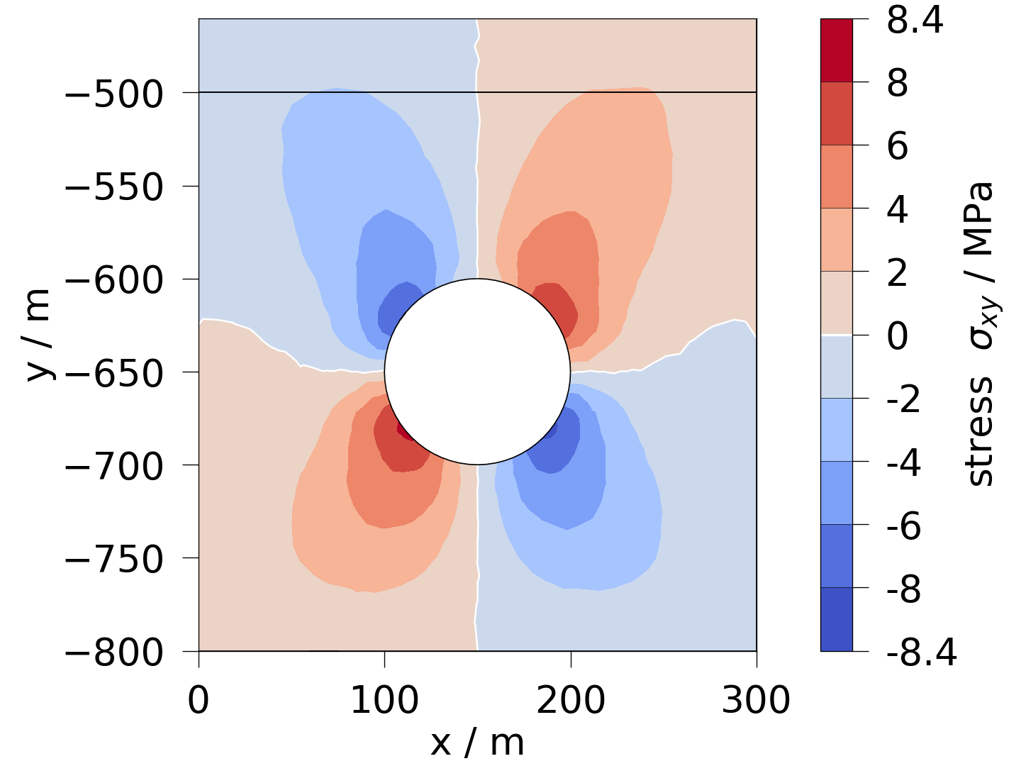

fig = mesh.plot_contourf(ot.variables.stress["xx"])
fig = mesh.plot_contourf(ot.variables.stress["xy"])

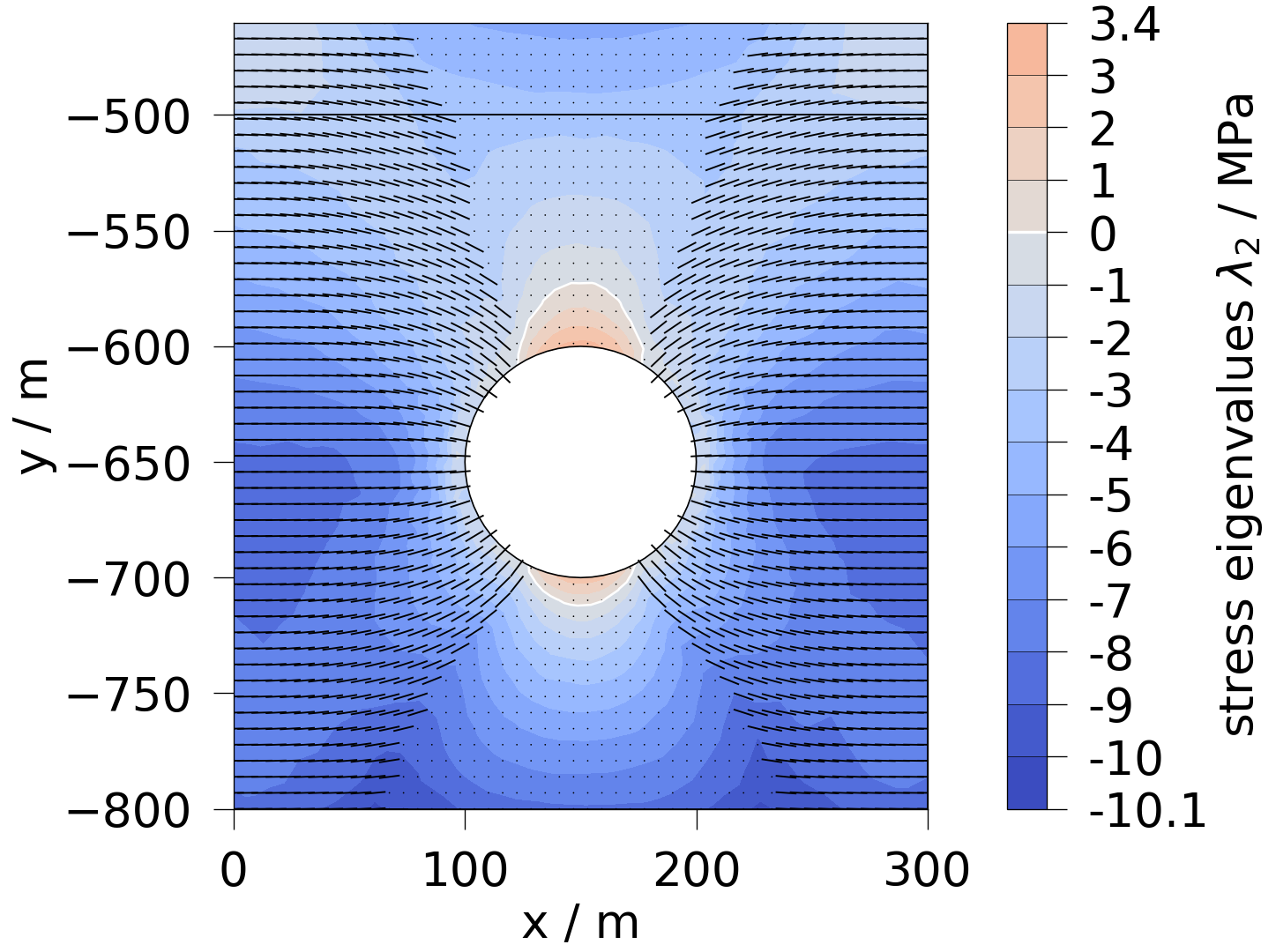

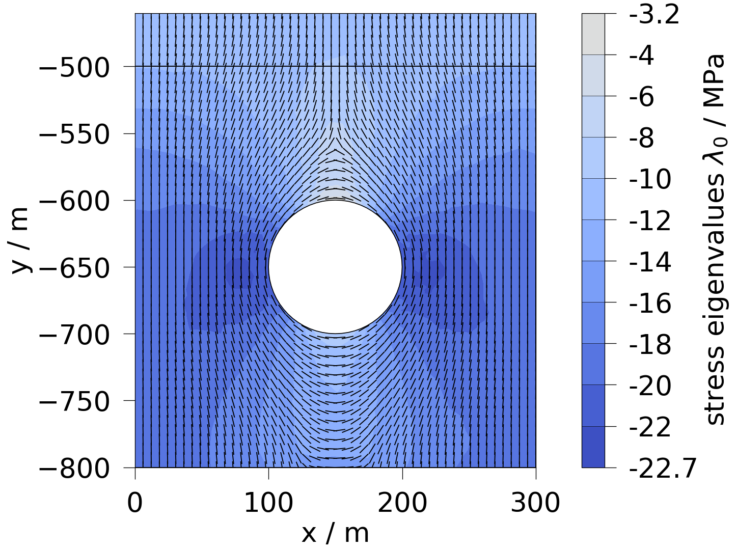

Principal stresses#
Let’s plot the the principal stress components and also overlay the direction of the corresponding eigenvector in the plot. Note: the eigenvalues are sorted by increasing order, i.e. eigenvalue[0] is the most negative / largest compressive principal stress.
eigvecs = ot.variables.stress.eigenvectors
fig = mesh.plot_contourf(variable=ot.variables.stress.eigenvalues[0])
mesh.plot_quiver(ax=fig.axes[0], variable=eigvecs[0], glyph_type="line")

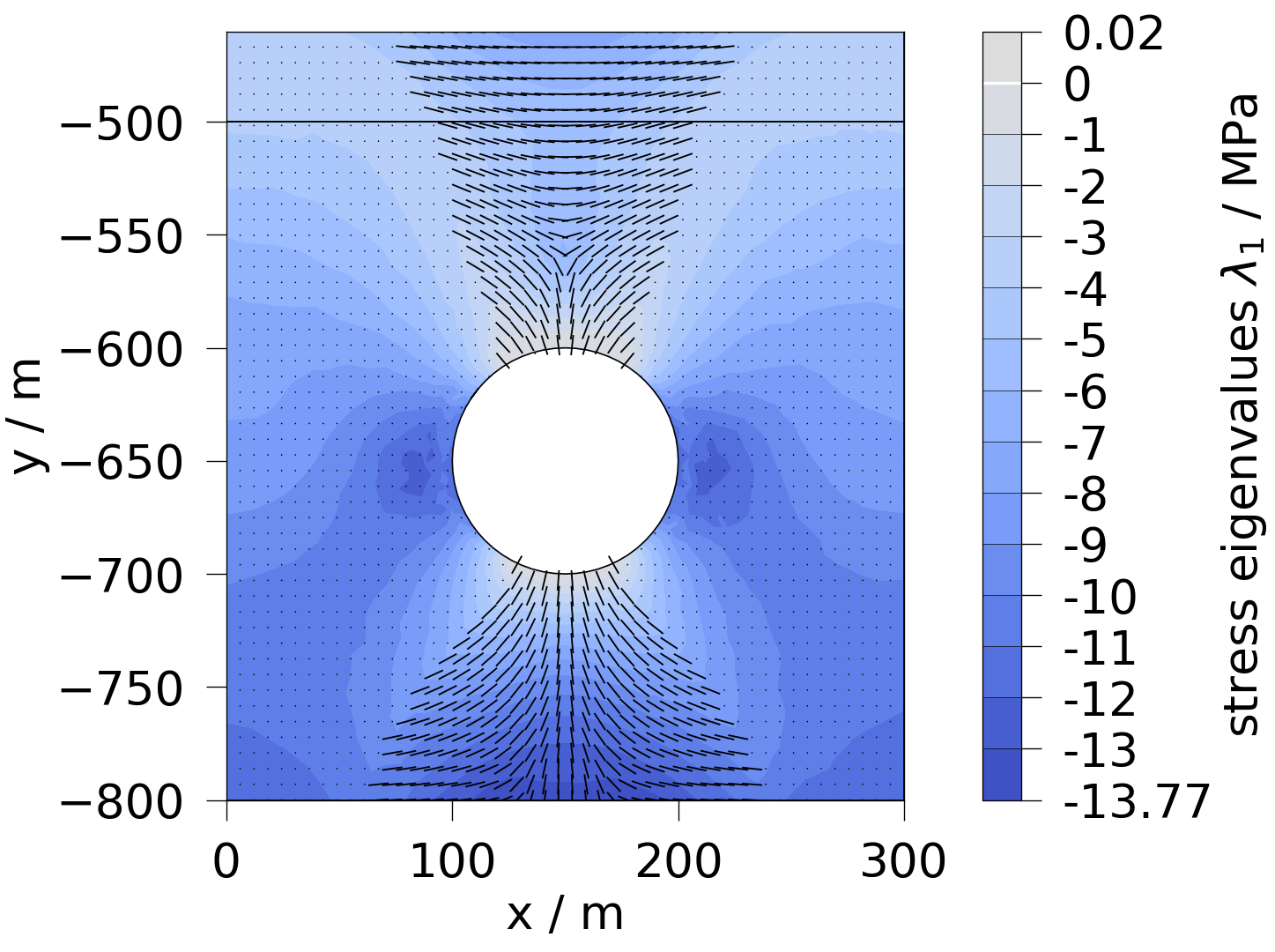

fig = mesh.plot_contourf(variable=ot.variables.stress.eigenvalues[1])
mesh.plot_quiver(ax=fig.axes[0], variable=eigvecs[1], glyph_type="line")
fig = mesh.plot_contourf(variable=ot.variables.stress.eigenvalues[2])
mesh.plot_quiver(ax=fig.axes[0], variable=eigvecs[2], glyph_type="line")

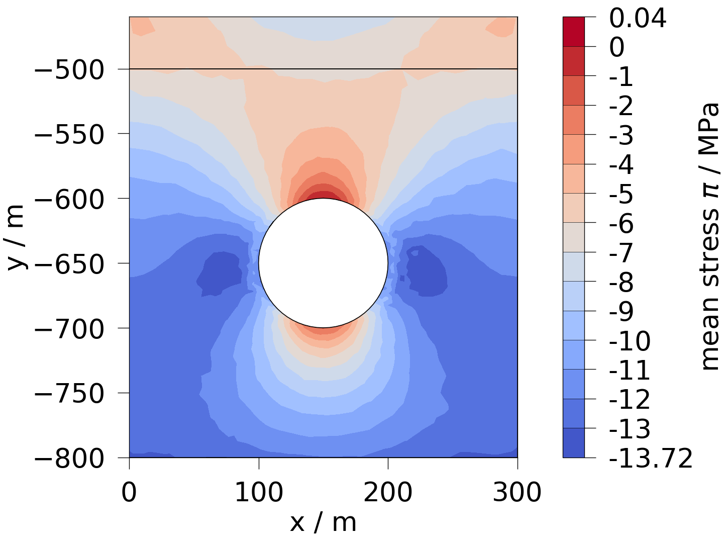

We can also plot the mean of the principal stress, i.e. the magnitude of the
hydrostatic component of the stress tensor.
see: ogstools.variables.tensor_math.mean()
fig = mesh.plot_contourf(ot.variables.stress.mean)

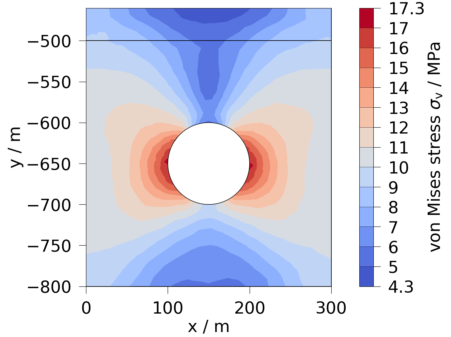

Von Mises stress#
see: ogstools.variables.tensor_math.von_mises()
fig = mesh.plot_contourf(ot.variables.stress.von_Mises)

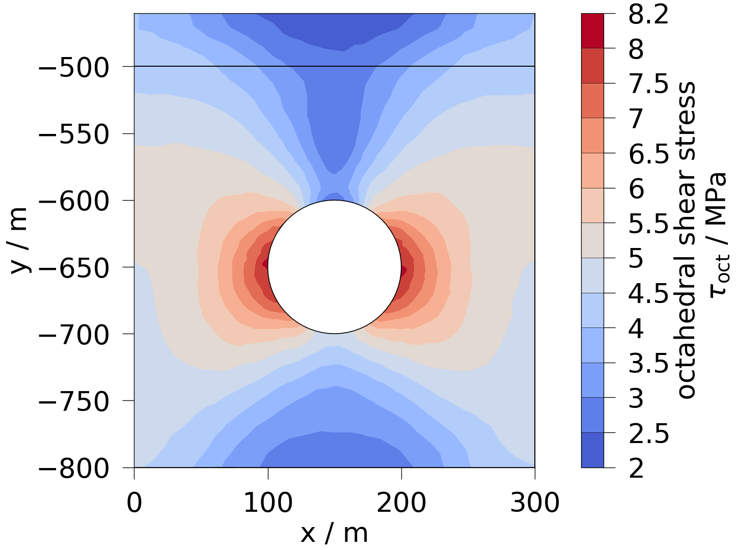

octahedral shear stress#
see: ogstools.variables.tensor_math.octahedral_shear()
fig = mesh.plot_contourf(ot.variables.stress.octahedral_shear)

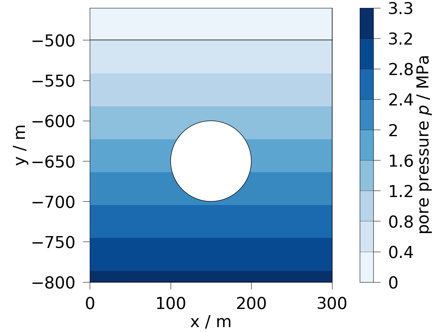

The hypothetical water column used in the integrity criteria would initially use existing “pressure” data in the mesh, otherwise it is automatically calculated as the following:
mesh["pressure"] = mesh.p_fluid()
fig = mesh.plot_contourf(ot.variables.pressure)

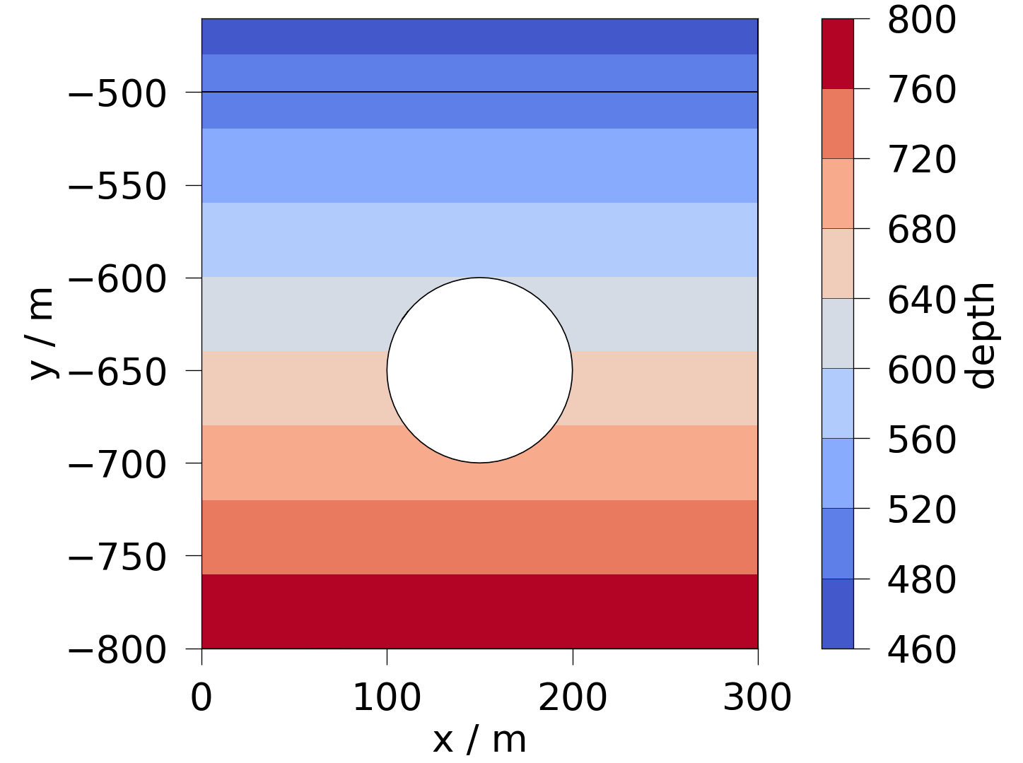

But since this assumes that the top of the model is equal to the ground surface, the resulting pressure is underestimated. In this case we have to correct the depth manually. Then the pressure is calculated correctly:
mesh["depth"] = mesh.depth(use_coords=True)
fig = mesh.plot_contourf("depth")

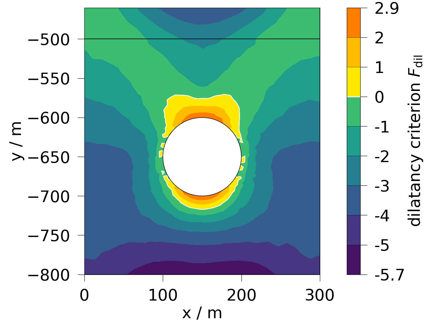

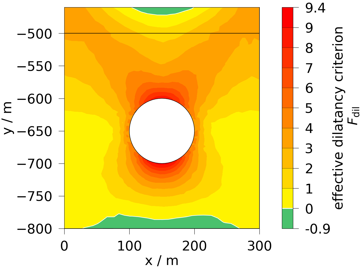

Dilantancy criterion#
see: ogstools.variables.mesh_dependent.dilatancy_critescu()
fig = mesh.plot_contourf(ot.variables.dilatancy_critescu_tot)
fig = mesh.plot_contourf(ot.variables.dilatancy_critescu_eff)

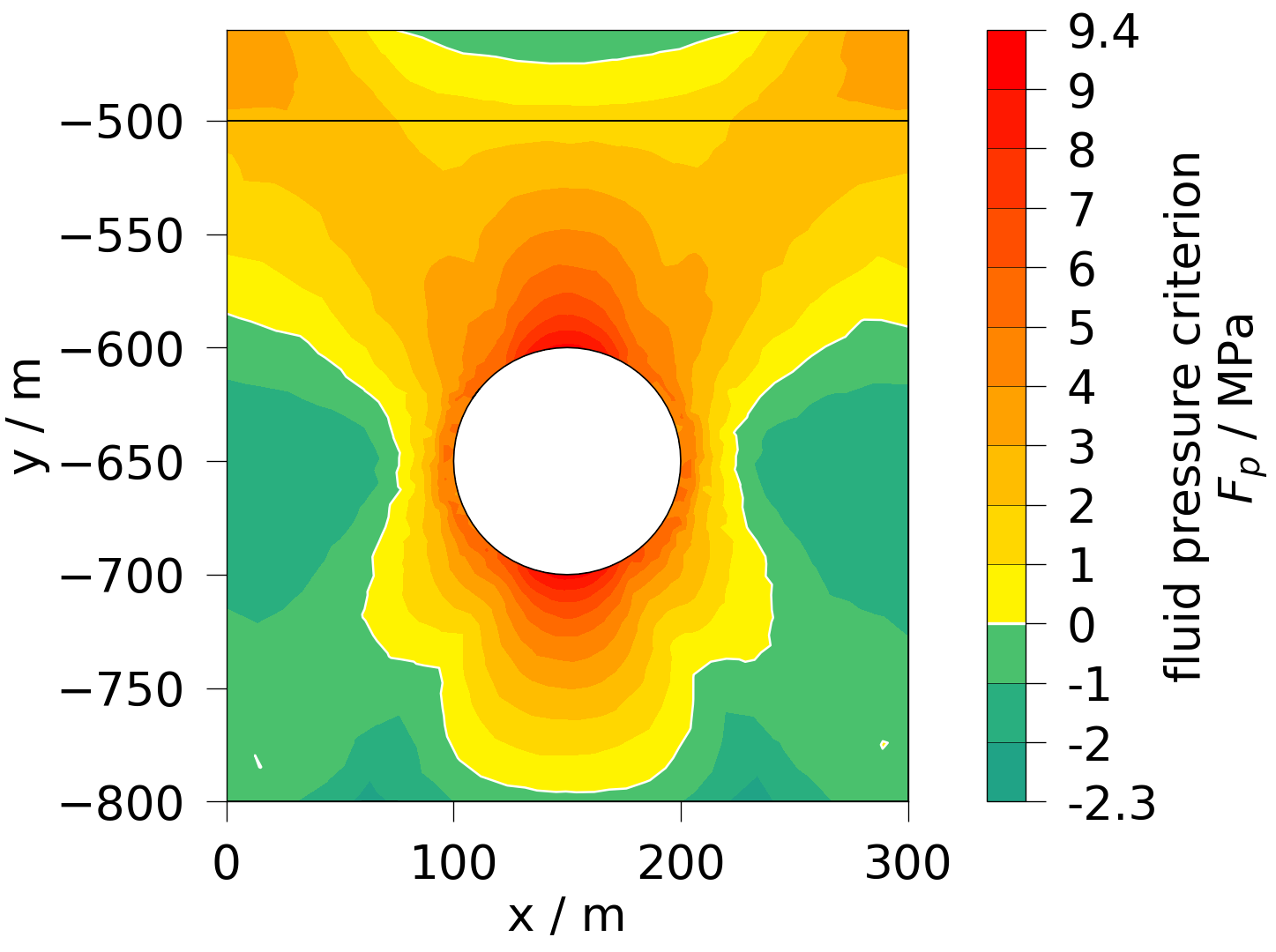

Fluid pressure criterion#
see: ogstools.variables.mesh_dependent.fluid_pressure_criterion()
fig = mesh.plot_contourf(ot.variables.fluid_pressure_crit)
