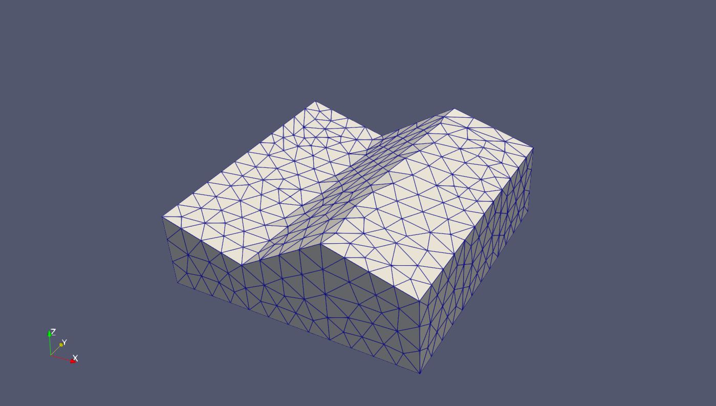

python -m ogstools.examples.mesh_terrain.pyvista_mesh
reads in relief.stl and meshes the volume between the relief and a z-coordinate specified in the script. In addition it creates physical groups for all bounding surfaces.

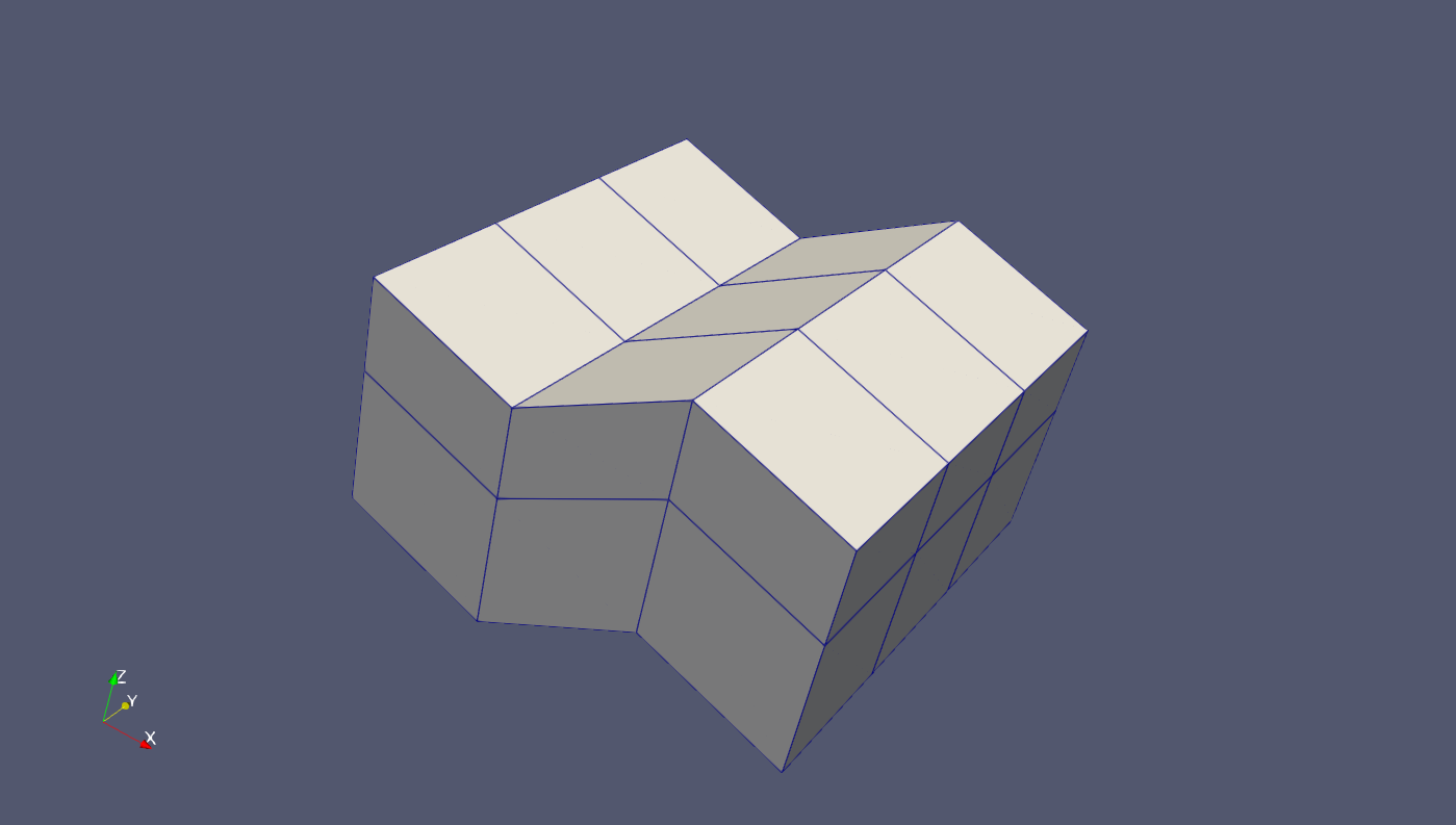

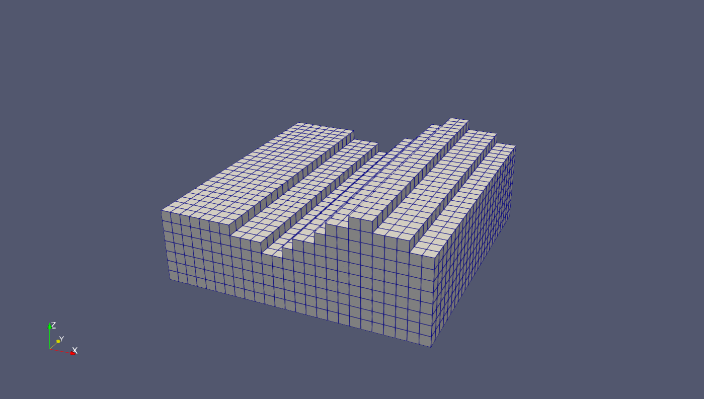

OGS comes with some utilities for meshing. Required are raster files (.grd) and a file specifying their sequence (here layer_file_list). The following commands create a 2D mesh, extrude it to 3D-wedge elements and then fit in a structured hex mesh.
generateStructuredMesh -e tri --lx 10 --nx 20 --ly 10 --ny 20 -o tri2d_mesh.vtu
createLayeredMeshFromRasters -i tri2d_mesh.vtu -o wedge3d_mesh.vtu -r layer_file_list
Vtu2Grid -i wedge3d_mesh.vtu -o hex3d_mesh.vtu -x 0.4

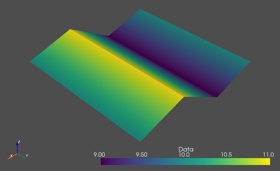

PyVista is mainly made for visualization, but brings some meshing functionality. It has a grid reader to read relief.grd and a meshio-interface to write to relief.vtu. Running:
generates a structured mesh on the relief and extrudes it downwards to 3D.
