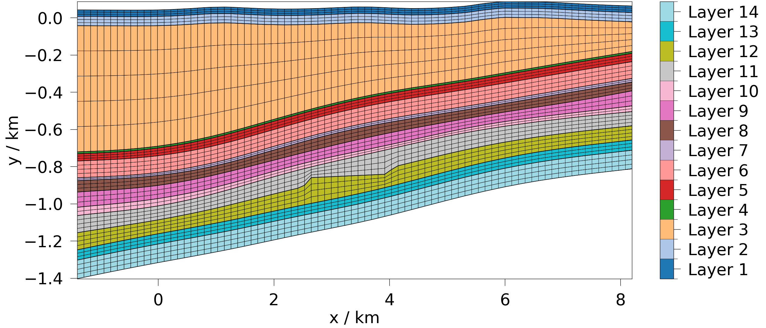

the setup, this will automatically show the element edges.
fig = mesh.plot_contourf(ot.variables.material_id)

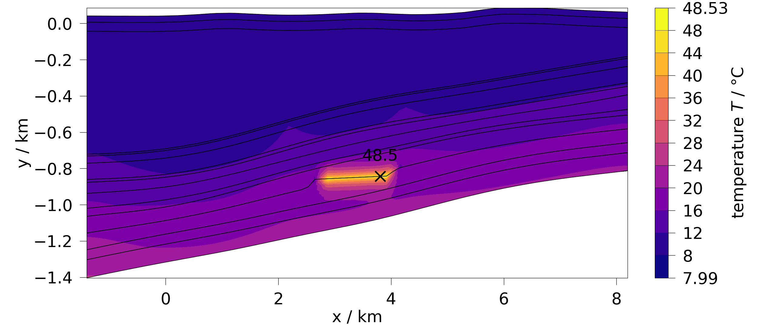

Now, let’s plot the temperature field (point_data) at the first timestep.
The default temperature variable from the variables reads the temperature
data as Kelvin and converts them to degrees Celsius.
fig = mesh.plot_contourf(ot.variables.temperature, show_max=True)

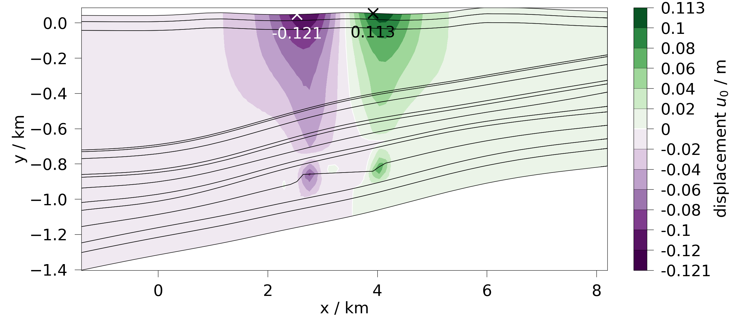

We can also plot components of vector variables:
ot.variables.displacement[0], show_min=True, show_max=True
ot.variables.displacement[1], show_max=True, show_edges=True

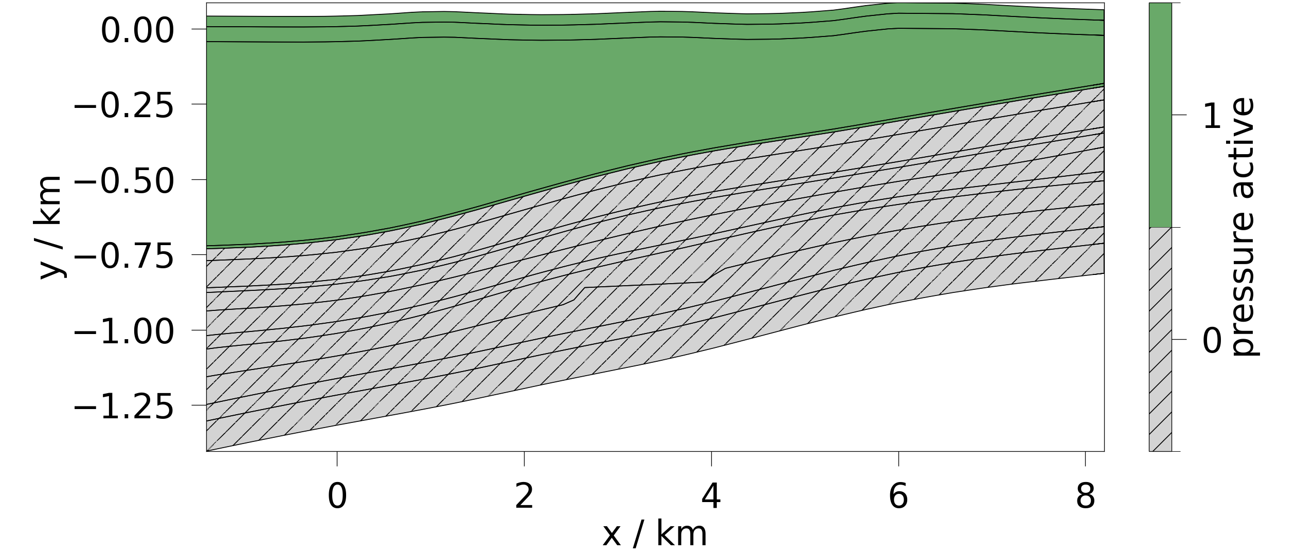

This example has hydraulically deactivated subdomains:
fig = mesh.plot_contourf(ot.variables.pressure.get_mask(), fontsize=40)

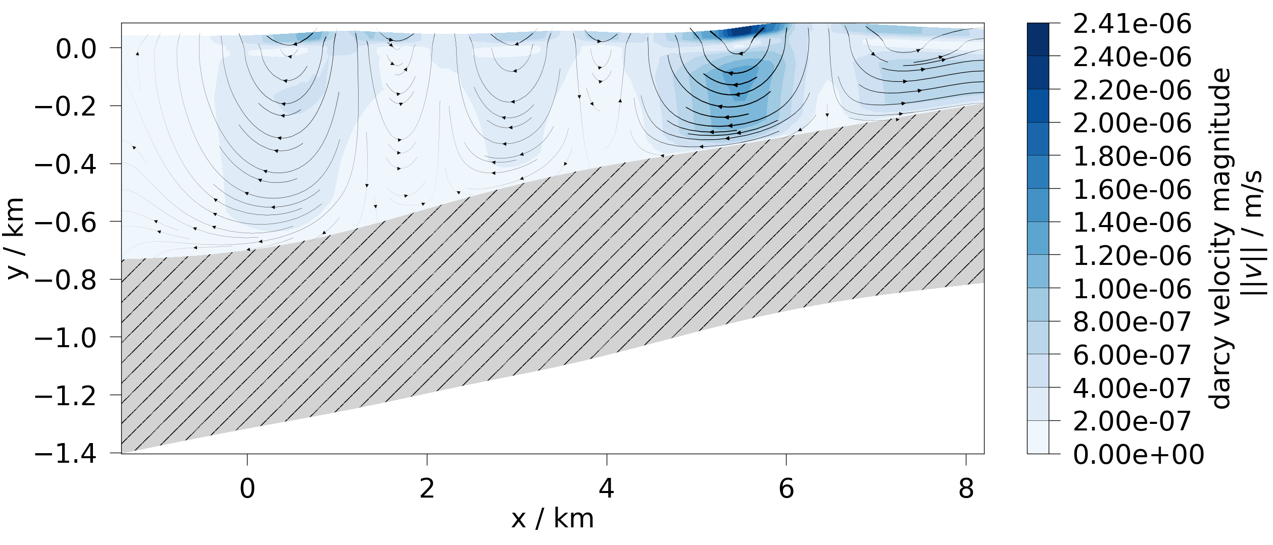

Let’s plot the fluid velocity field.
fig = mesh.plot_contourf(ot.variables.velocity, show_region_bounds=False)

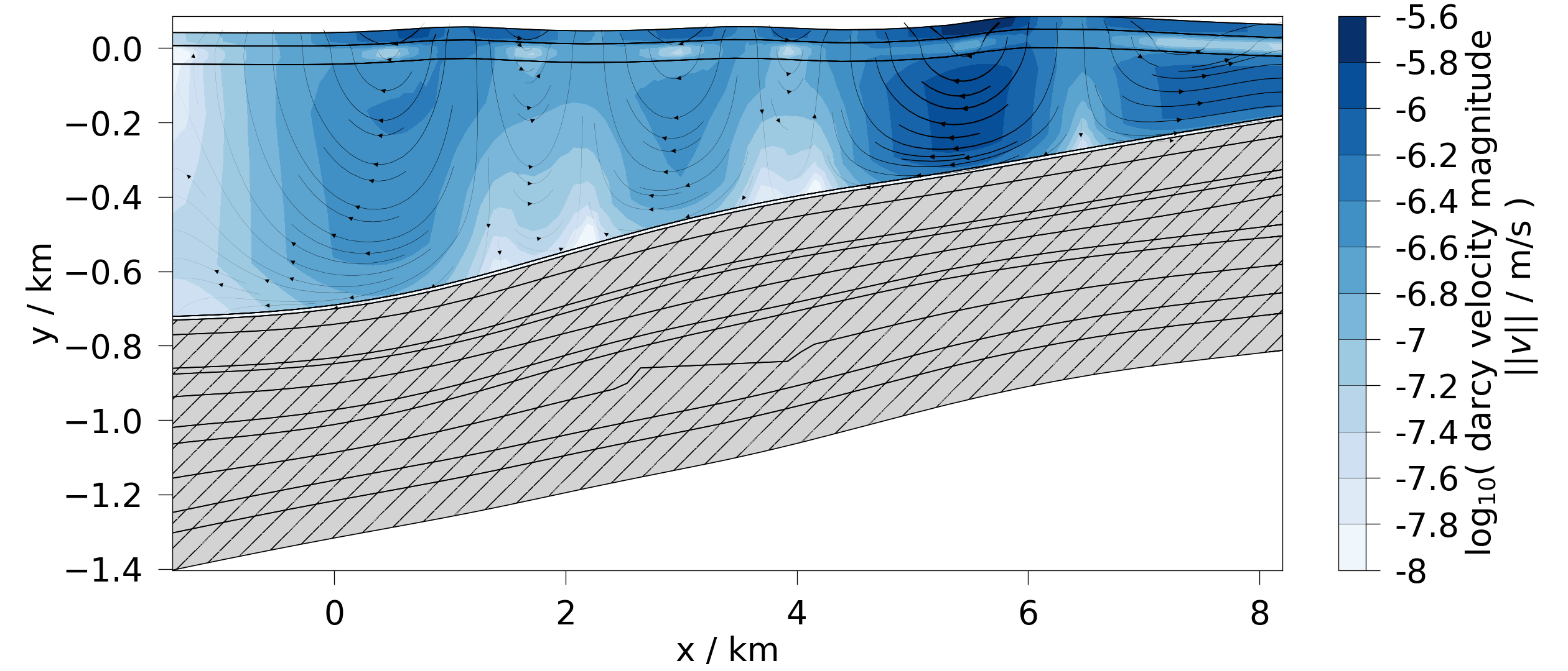

Let’s plot it again, this time log-scaled.
fig = mesh.plot_contourf(ot.variables.velocity, log_scaled=True, vmin=-8)
