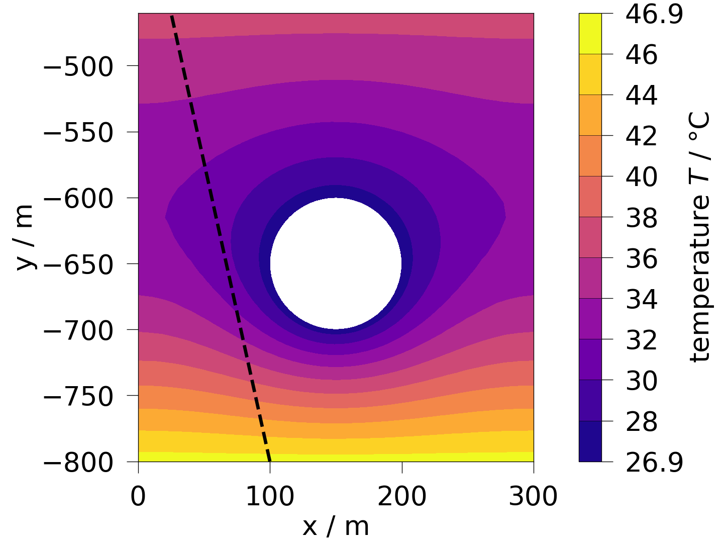

We use the pyvista function sample_over_line and use two points to
define the line and get a Mesh with the sampled data. Let’s plot the Mesh and
the line together.
sample = mesh.sample_over_line([25, -460, 0], [100, -800, 0])
fig = mesh.plot_contourf(ot.variables.temperature)
fig = ot.plot.line(sample, ax=fig.axes[0], linestyle="--")

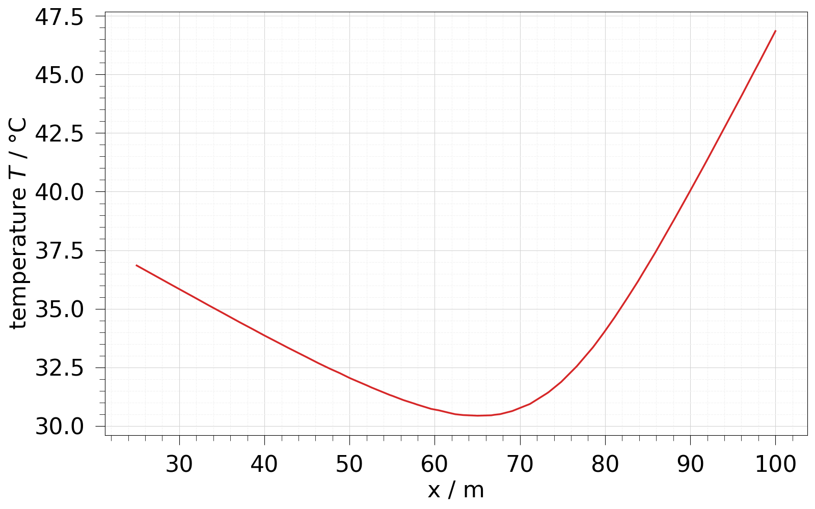

Now we plot the temperature data. The spatial coordinate for the x-axis is automatically detected here.
fig = ot.plot.line(sample, ot.variables.temperature)

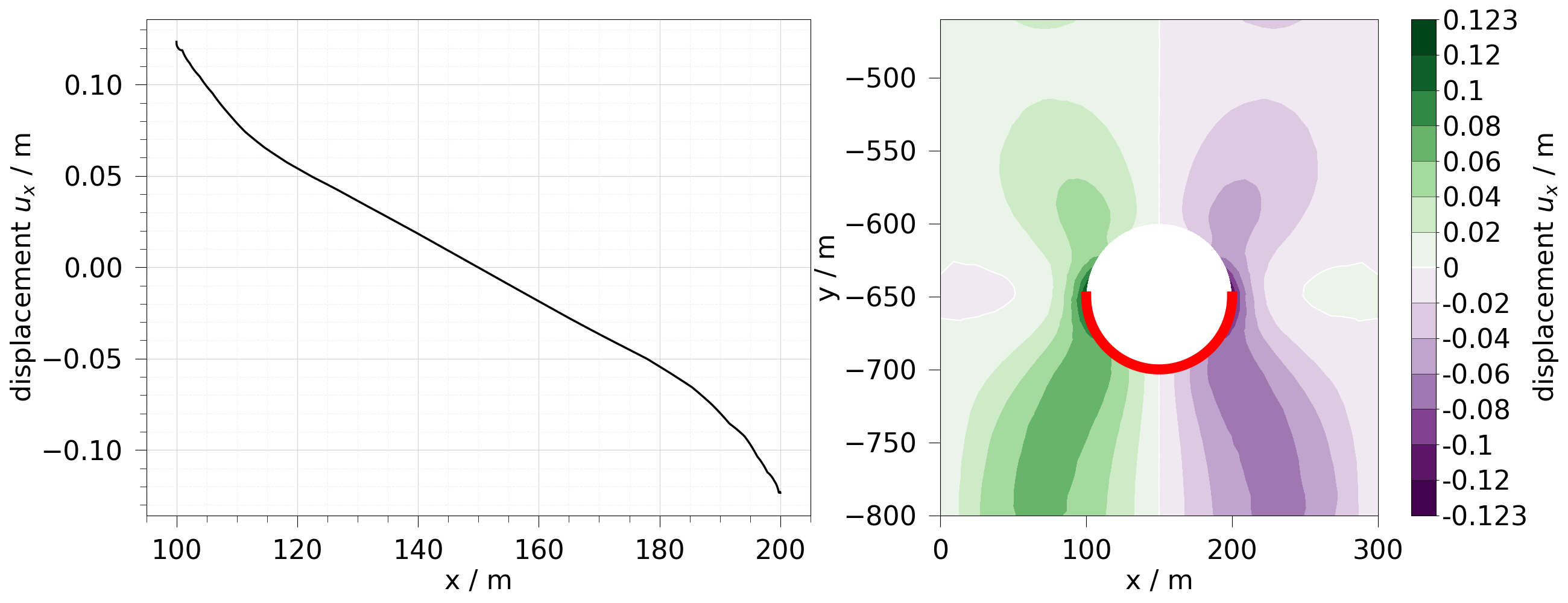

Simple case: circular arc#
With 3 points we can define an arc over which to sample the data. Having the arc directly on a boundary might result in some gaps in the sampled data, thus we extend the arc by a small margin.
sample = mesh.sample_over_circular_arc(
pointa=[100 - 1e-4, -650, 0],
pointb=[200 + 1e-4, -650, 0],
center=[150, -650, 0],
fig, axs = plt.subplots(ncols=2, figsize=[26, 10])
mesh.plot_contourf(ot.variables.displacement["x"], fig=fig, ax=axs[1])
ot.plot.line(sample, ax=axs[1], lw=3, color="red")
ot.plot.line(sample, ot.variables.displacement["x"], ax=axs[0])

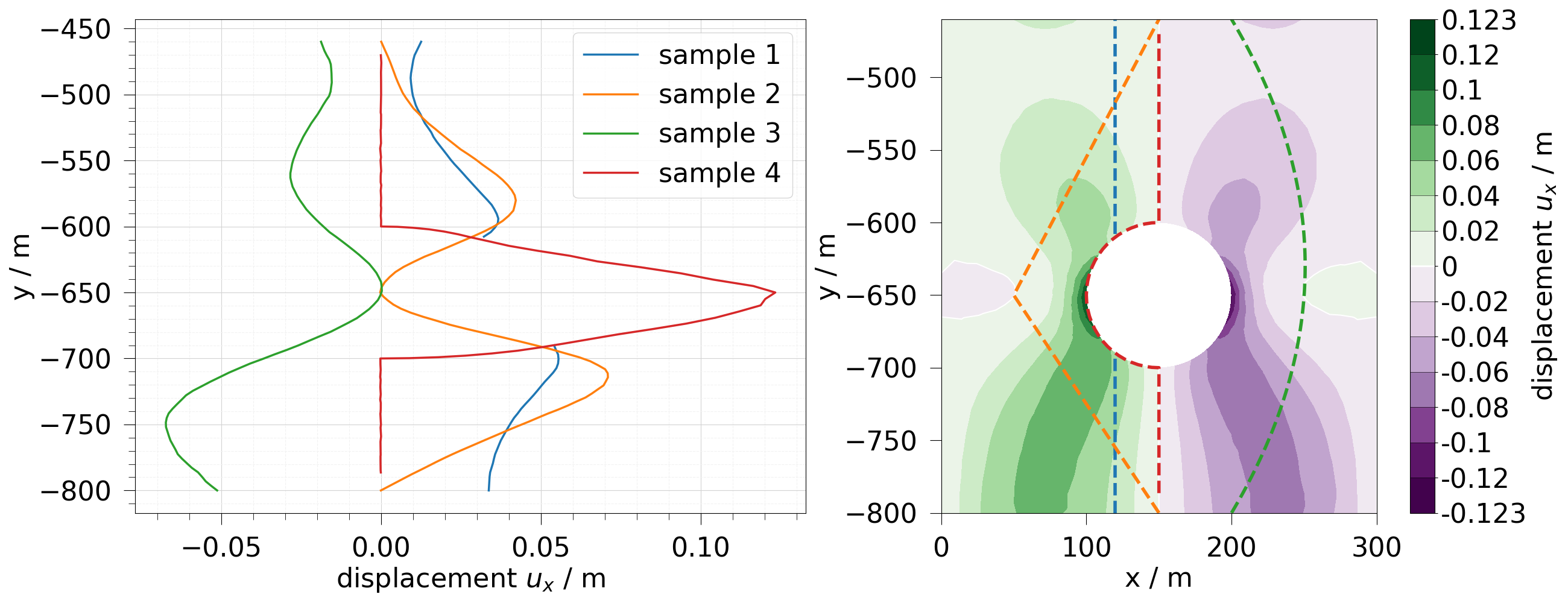

Other methods to setup the sampling line#
The following section shows different methods of creating sampling lines.
Linear spaced points#
This basically does the same as the pyvista function sample_over_line.
pts = np.linspace([120, -460, 0], [120, -800, 0], 100)
sample_1 = pv.PolyData(pts).sample(mesh)
Mutilsegmented line from list of points#
The following code allows you to have a line connecting multiple observation points.
obs_pts = np.asarray([[150, -460, 0], [50, -650, 0], [150, -800, 0]])
pts = np.vstack([np.linspace(pt1, pt2, 50) for pt1, pt2 in pairwise(obs_pts)])
sample_2 = pv.PolyData(pts).sample(mesh)
Spline from list of points#
You can also create smooth sampling lines by using a fitting function. The following creates a second order polynomial fit for the x-coordinates in dependence of the y-coordinates.
pts = np.asarray([[200, -460, 0], [250, -650, 0], [200, -800, 0]])
fit = np.poly1d(np.polyfit(pts[:, 1], pts[:, 0], 2))
y = np.linspace(-460, -800, 100)
pts = np.transpose([fit(y), y, y * 0])
sample_3 = pv.PolyData(pts).sample(mesh)
Use existing geometry#
Another way to setup the sampling line is to extract points from the domain
mesh. Here, we use the clip function from pyvista and some boolean logic,
to extract a vertical line through the center, which follows the boundary of
the hole.
edges = mesh.clip("x").extract_feature_edges()
is_top_bot = np.isin(edges.points[:, 1], [-800, -460])
is_left = edges.points[:, 0] == 0
pts = edges.points[np.invert(is_top_bot | is_left)]
sample_4 = pv.PolyData(pts).sample(mesh)
Now we plot all samples for comparison.
u_x = ot.variables.displacement["x"]
mesh.plot_contourf(u_x, fig=fig, ax=axs[1])
for i, sample in enumerate([sample_1, sample_2, sample_3, sample_4]):
c = f"C{i}" # cycle through default color cycle
ot.plot.line(sample, ax=axs[1], linestyle="--", color=c)
ot.plot.line(sample, u_x, "y", ax=axs[0], label=f"sample {i + 1}", color=c)
