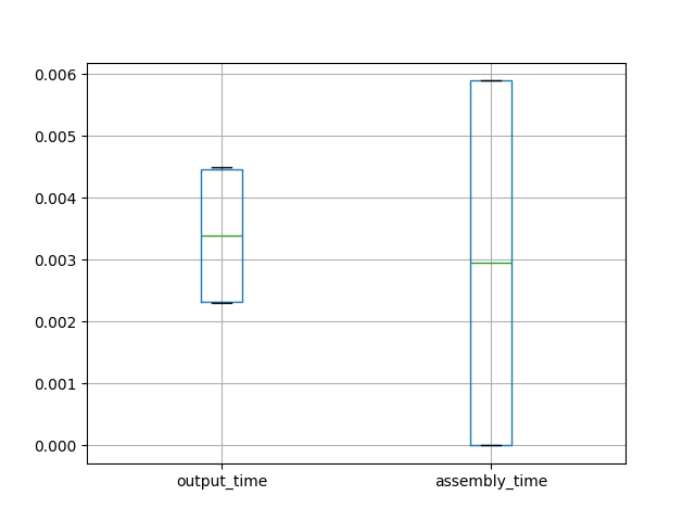

Aggregate measurements over all MPI processes#
If you are not particularly interested in the performance of each MPI_process pandas gives you all you need to further process data. However, for performance measurement it is recommended to consider always the slowest MPI_process for meaningful interpretation of overall performance (because of synchronization barriers in the evaluation scheme of OGS). Then the resulting DataFrame has the same structure like a DataFrame gained from serial OGS log.
df_ts.groupby("time_step").max()
df_ts[["output_time", "assembly_time"]].boxplot()
<Axes: >
