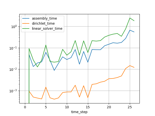

Selecting specific metrics (3) and plotting using pandas plot function.
df_ts[["assembly_time", "dirichlet_time", "linear_solver_time"]].plot(
logy=True, grid=True

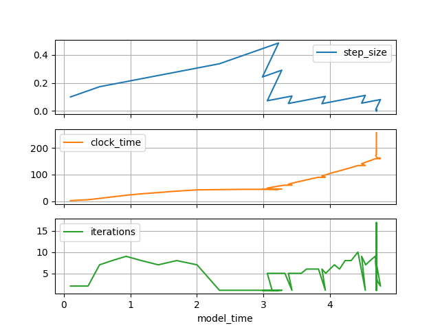

Analysis of model time and clock time#
The ogstools.logparser.model_and_clock_time function allows to
examine needed iterations, clock time, and step size over model time per
attempted time step. This is especially useful to analyze the runtime
behaviour of a simulation which employs adaptive time stepping. The following
example failed as the simulation reached the minimal allowed time step size.
records = ot.logparser.parse_file(log_adaptive_timestepping)
df_t = ot.logparser.model_and_clock_time(df_log)
df_t[["step_size", "clock_time", "iterations"]].plot(grid=True, subplots=True)

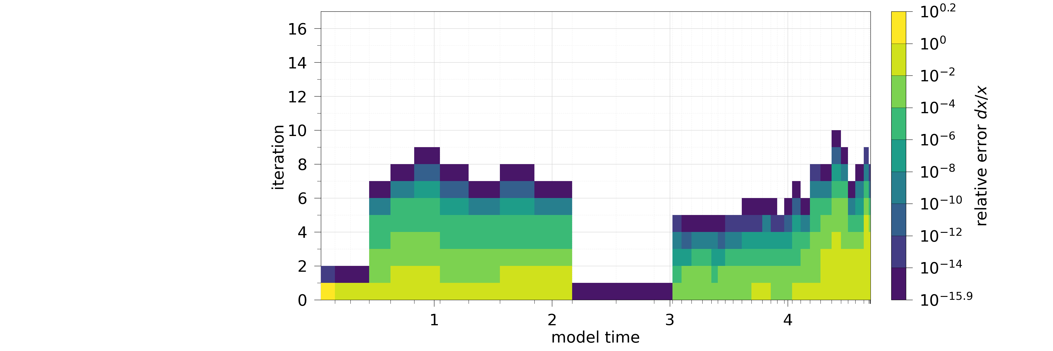

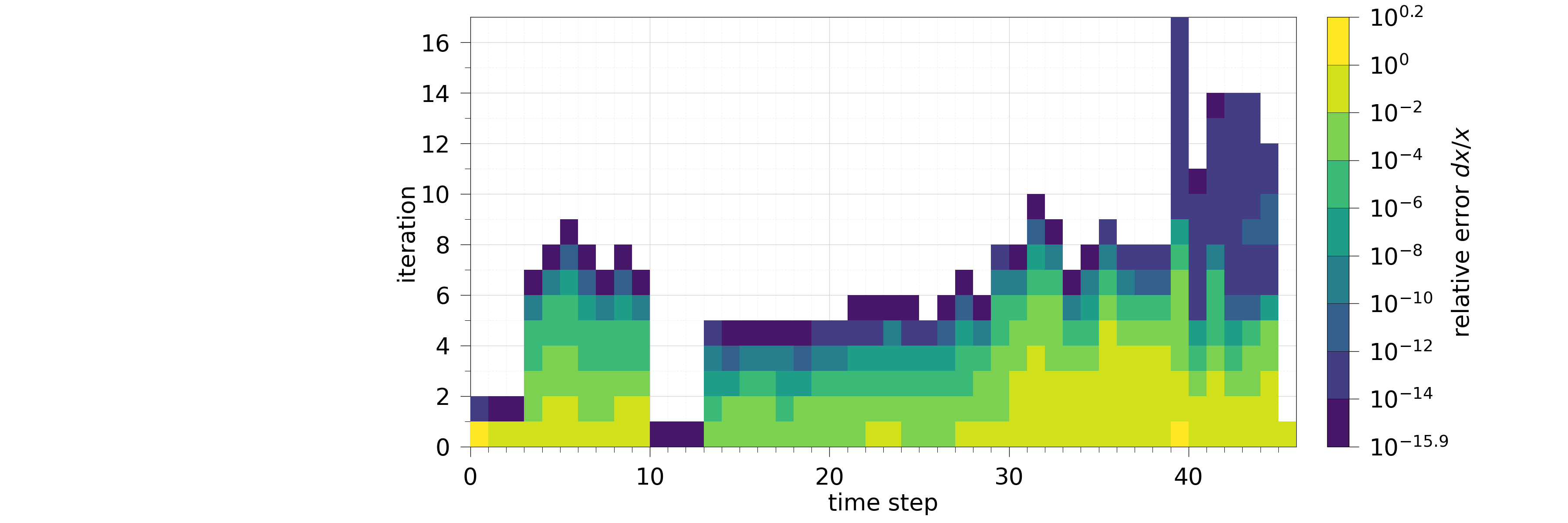

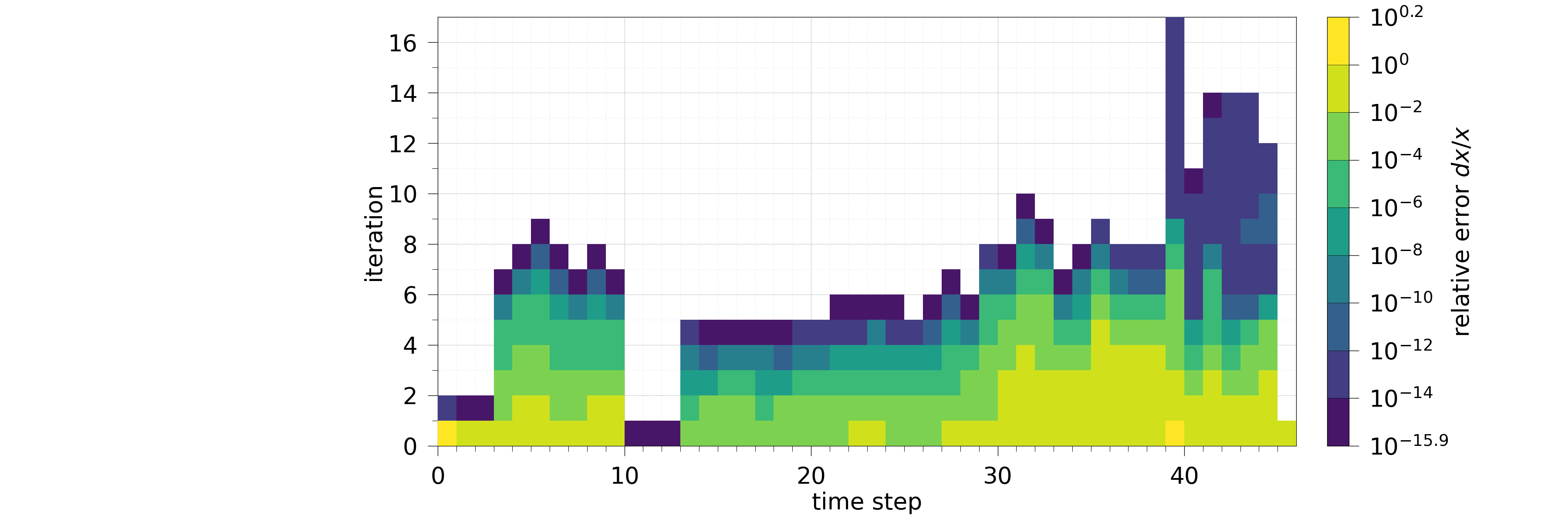

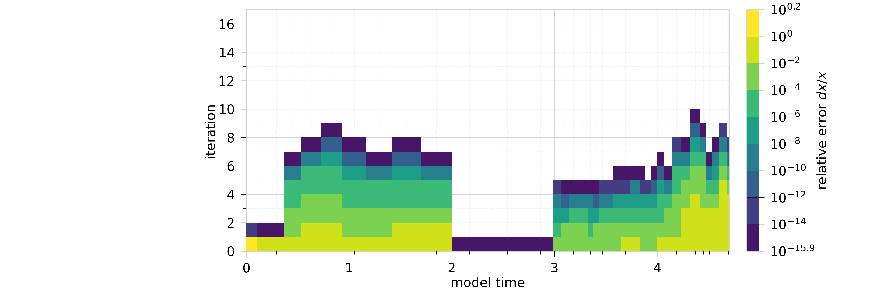

To get an overview of the convergence behavior of the nonlinear solver over the entire simulation we can plot the relative error as a heatmap.
fig = ot.logparser.plot_convergence(df_log, "dx_x")
We can also plot this data over the model time. Note, that the last timesteps are so small, that they are not visible anymore here:
fig = ot.logparser.plot_convergence(df_log, "dx_x", x_metric="model_time")

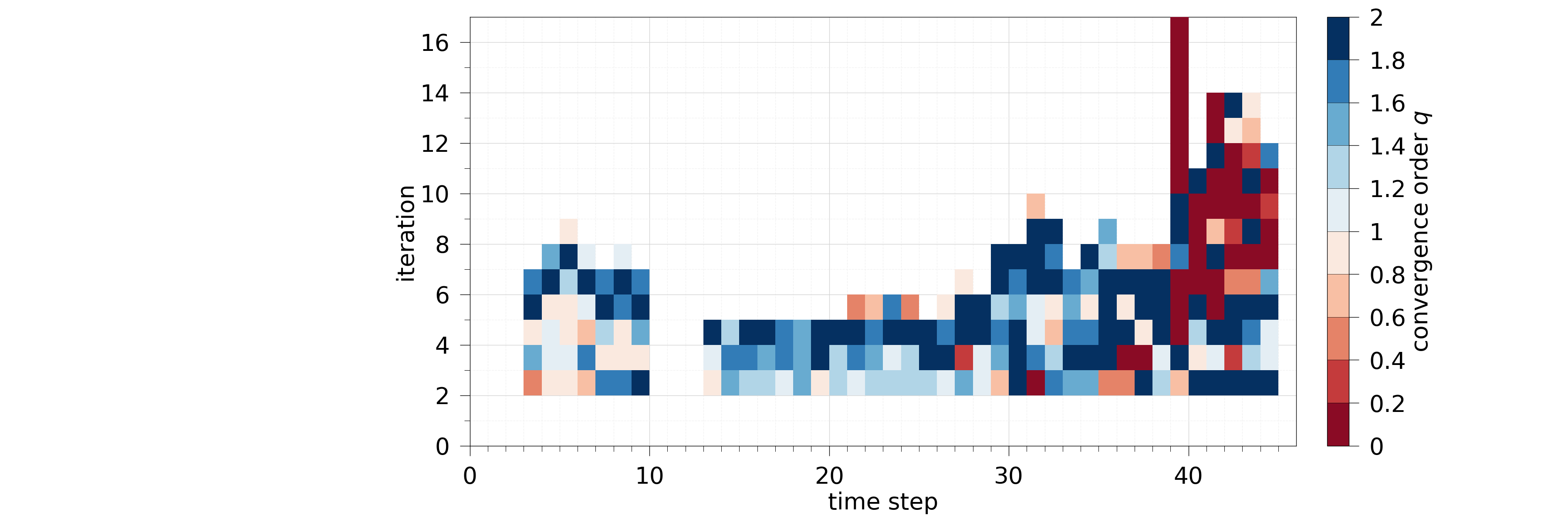

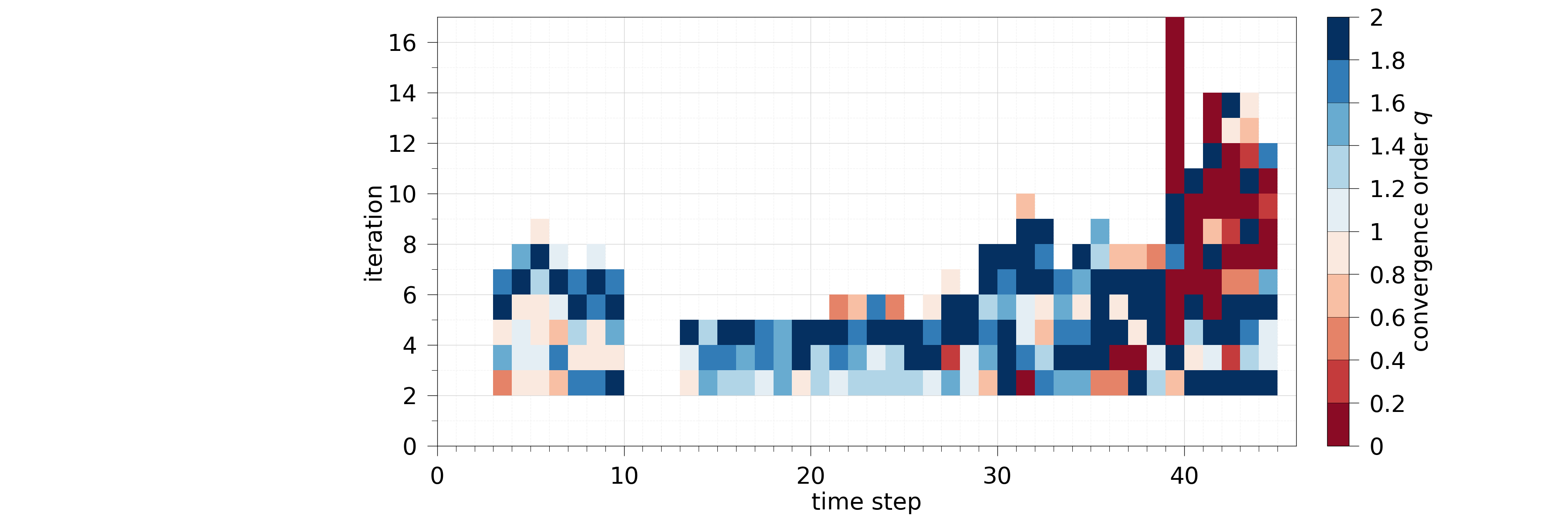

Further we can calculate the convergence order and plot it in the same manner.
In order to estimate the convergence order we need to take into account
multiple values and thus cannot assign each iteration a convergence order.
Only for iterations i of i >= n an order is calculated and plotted.
See: convergence_order_per_ts_iteration()
for more info.
fig = ot.logparser.plot_convergence_order(df_log)
