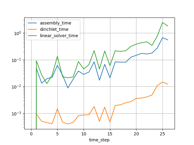

Selecting specific metrics (3) and plotting using pandas plot function.
df_ts[["assembly_time", "dirichlet_time", "linear_solver_time"]].plot(
    logy=True, grid=True
plot 101 logparser analyses
<Axes: xlabel='time_step'>

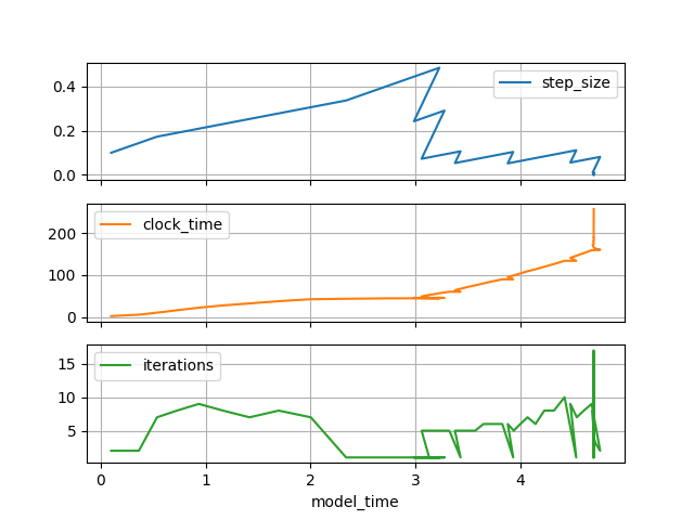

The ogstools.logparser.model_and_clock_time function allows to examine needed iterations, clock time, and step size over model time per attempted time step. This is especially useful to analyze the runtime behaviour of a simulation which employs adaptive time stepping. The following example failed as the simulation reached the minimal allowed time step size.
records = ot.logparser.parse_file(log_adaptive_timestepping)
df_t = ot.logparser.model_and_clock_time(df_log)
df_t[["step_size", "clock_time", "iterations"]].plot(grid=True, subplots=True)
array([<Axes: xlabel='model_time'>, <Axes: xlabel='model_time'>,
       <Axes: xlabel='model_time'>], dtype=object)

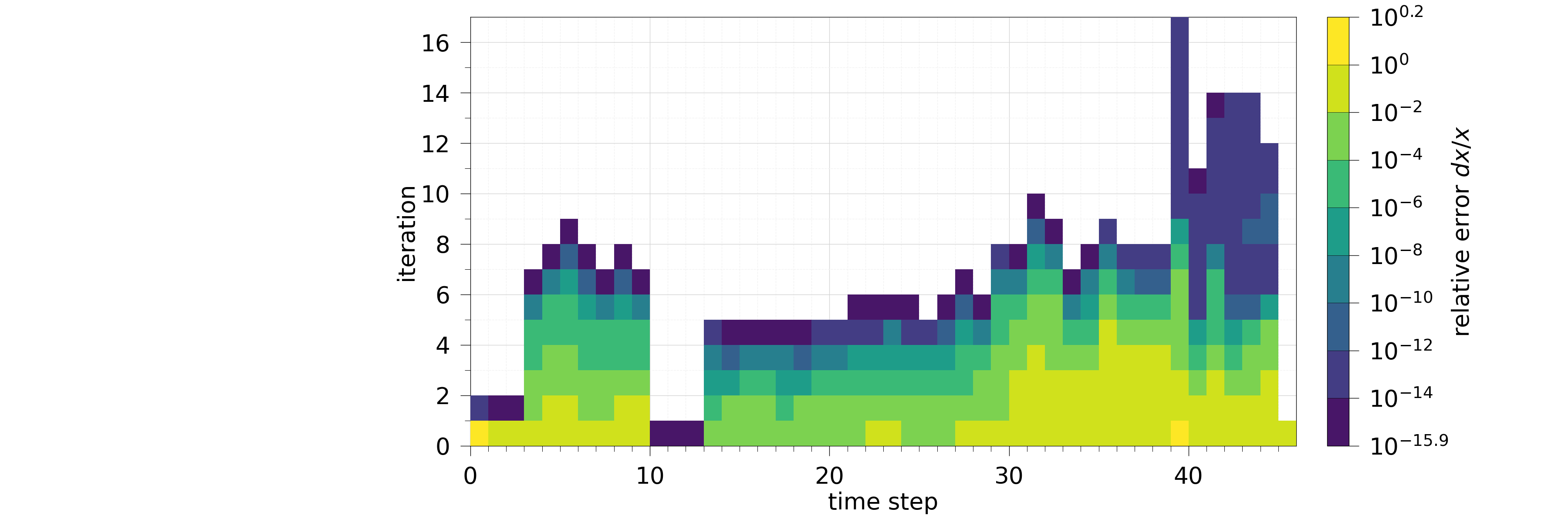

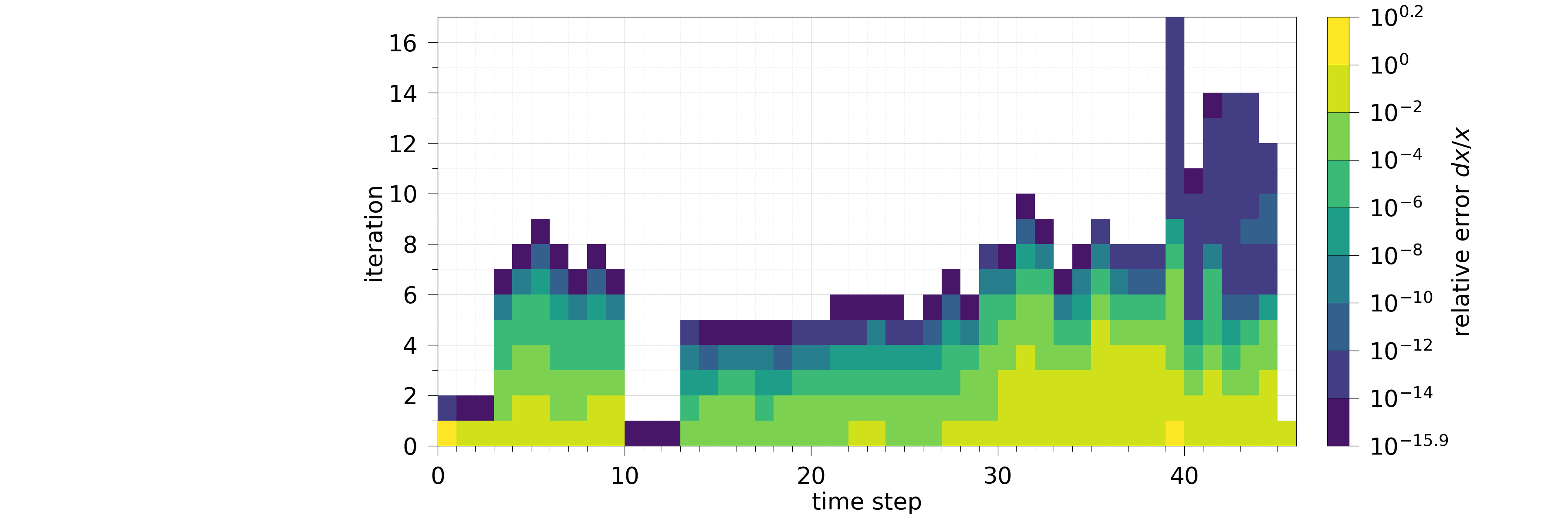

To get an overview of the convergence behavior of the nonlinear solver over the entire simulation we can plot the relative error as a heatmap.
fig = ot.logparser.plot_convergence(df_log, "dx_x")

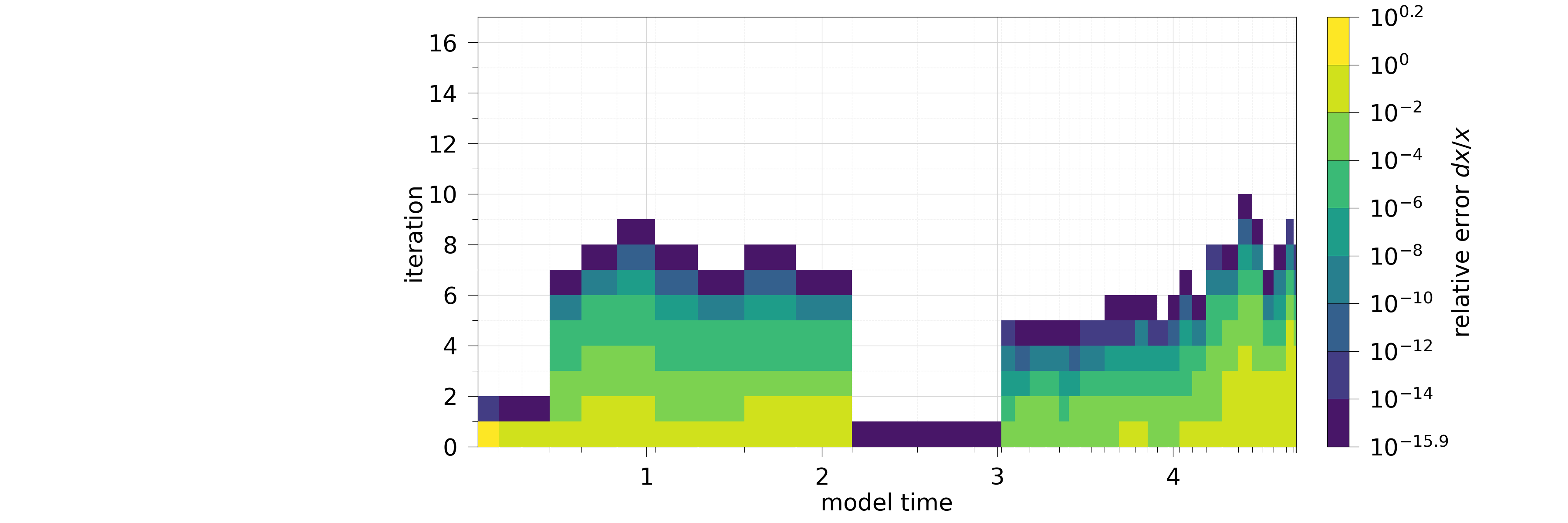

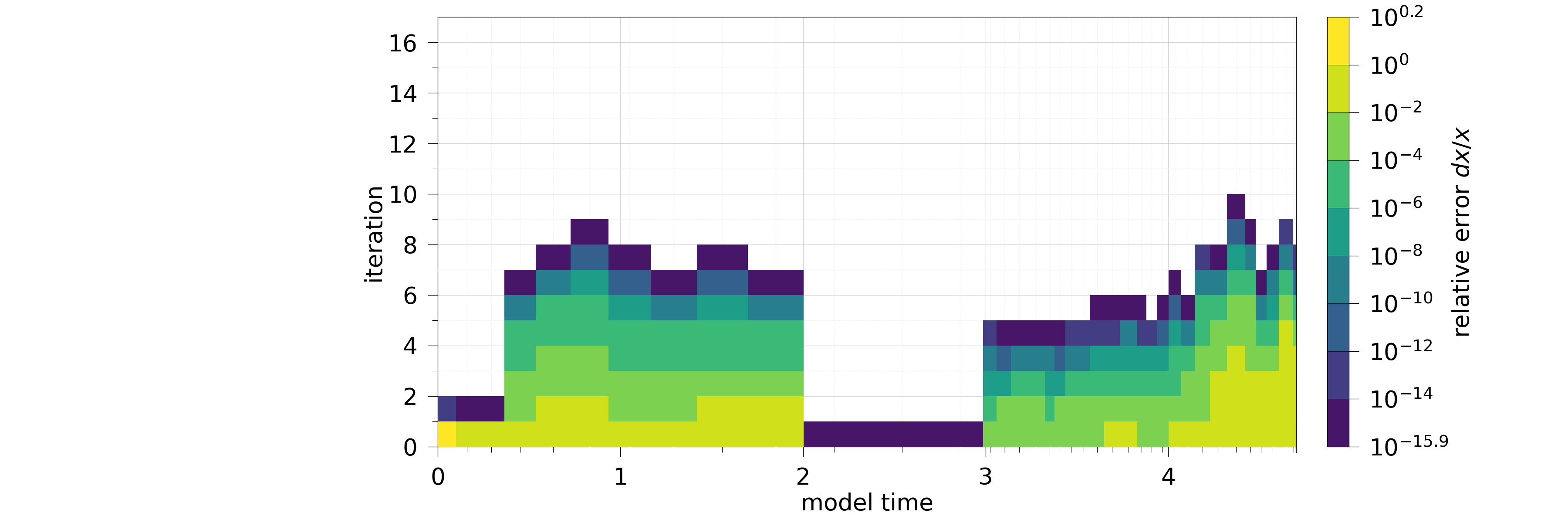

We can also plot this data over the model time. Note, that the last timesteps are so small, that they are not visible anymore here:
fig = ot.logparser.plot_convergence(df_log, "dx_x", x_metric="model_time")

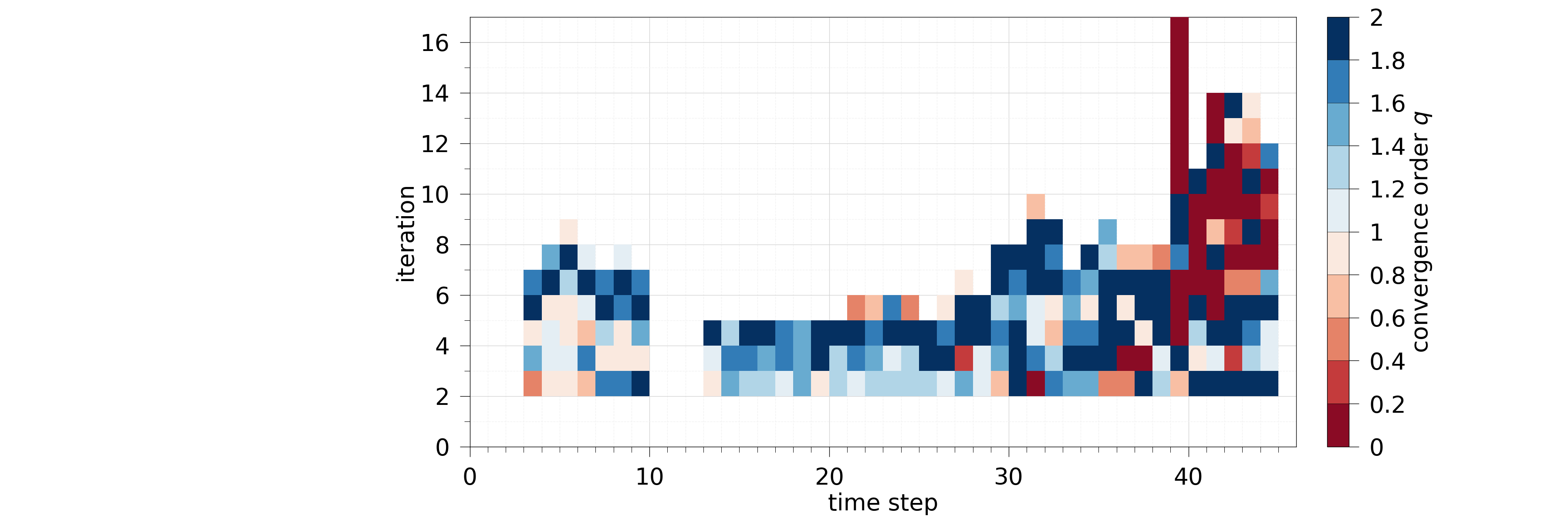

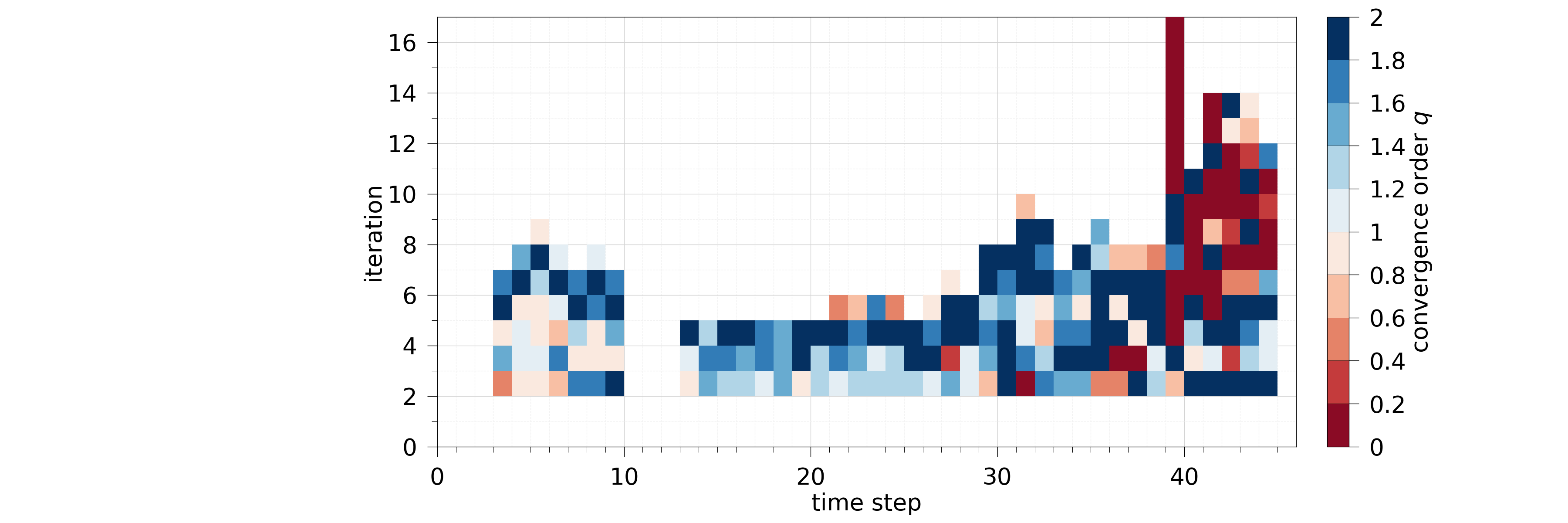

Further we can calculate the convergence order and plot it in the same manner. In order to estimate the convergence order we need to take into account multiple values and thus cannot assign each iteration a convergence order. Only for iterations i of i >= n an order is calculated and plotted. See: convergence_order_per_ts_iteration() for more info.
fig = ot.logparser.plot_convergence_order(df_log)
