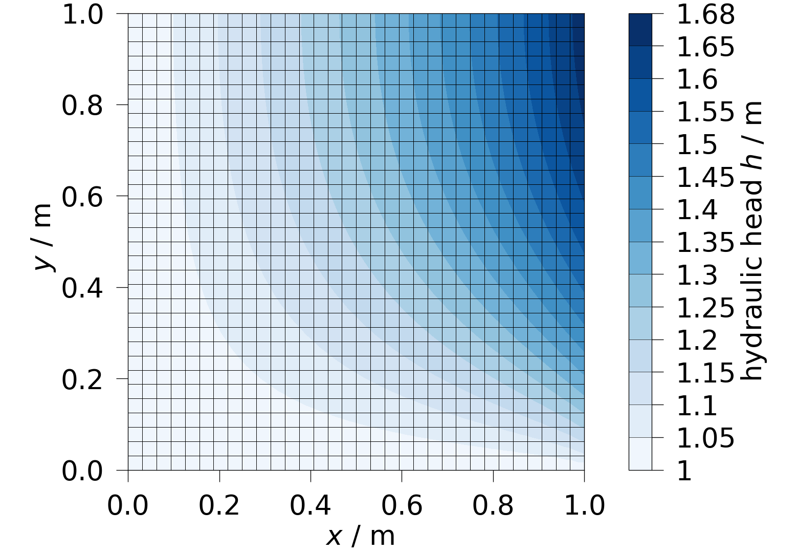

Here we calculate the analytical solution on one of the meshes:
analytical_solution_path = tmp_path / "analytical_solution.vtu"
sim_last: ot.Simulation = simulations[-1]
solution = examples.anasol.diffusion_head_analytical(
    simulations[-1].meshseries[0]
fig = ot.plot.contourf(solution, ot.variables.hydraulic_head)
analytical_solution_path = ot.mesh.save(solution)
plot convergence study steady state diffusion
