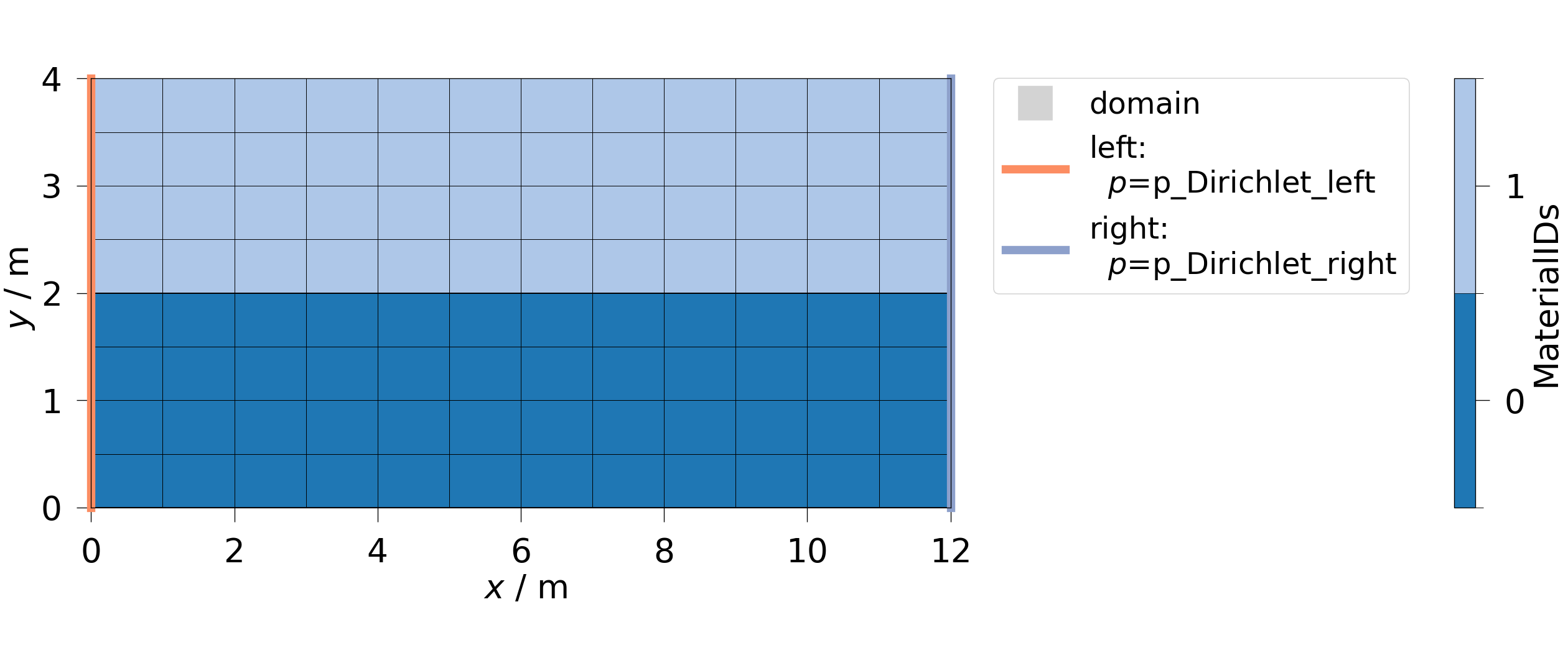

model = ot.Model(project=project, meshes=meshes)
# Visualize setup with boundary conditions
fig = model.plot_constraints()
plot framework short

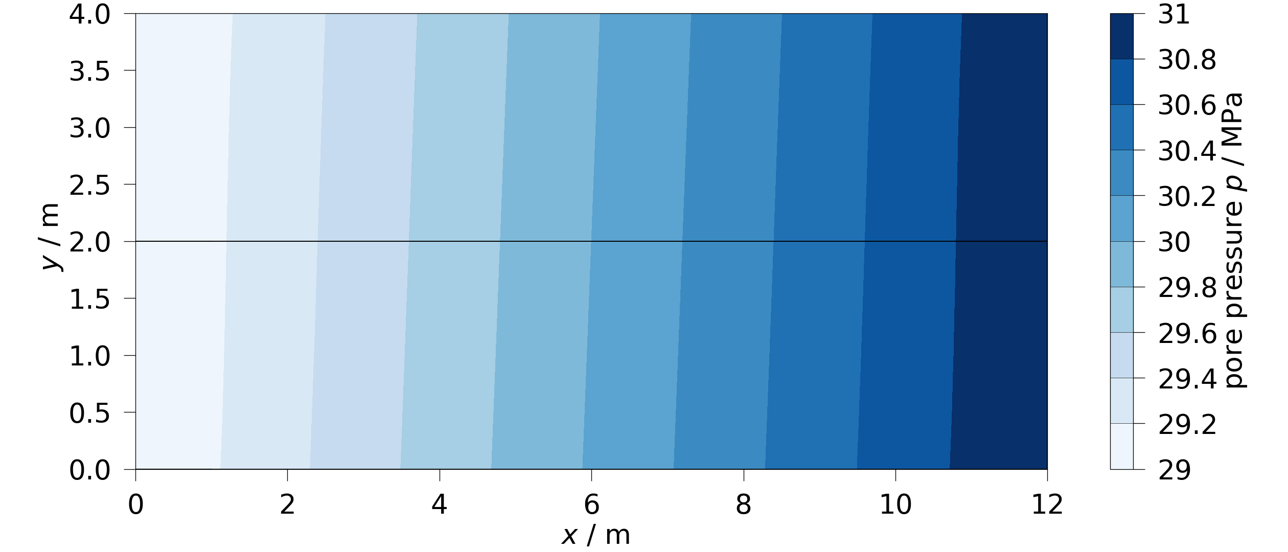

3. Analyze: Visualize Results#
# Plot final pressure distribution
fig = ot.plot.contourf(sim.meshseries[-1], "pressure")

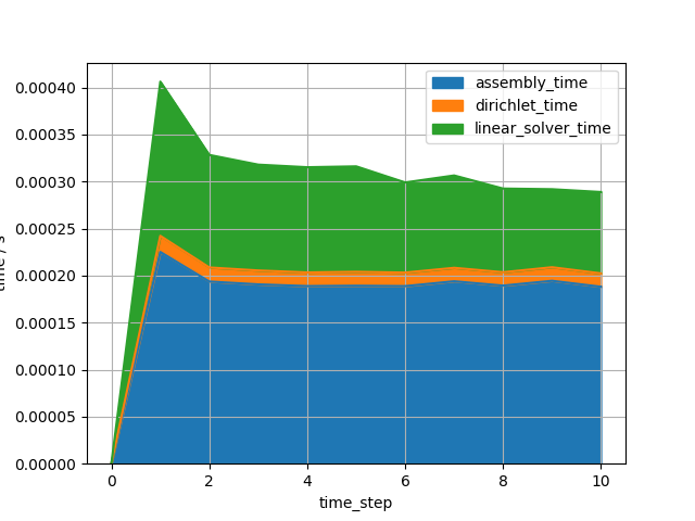

Plot simulation time
df_ts = ot.logparser.analysis_time_step(sim.log.df_log).reset_index()
times = ["assembly_time", "dirichlet_time", "linear_solver_time"]
df_ts.plot.area(x="time_step", y=times, ylabel="time / s", grid=True)
<Axes: xlabel='time_step', ylabel='time / s'>
