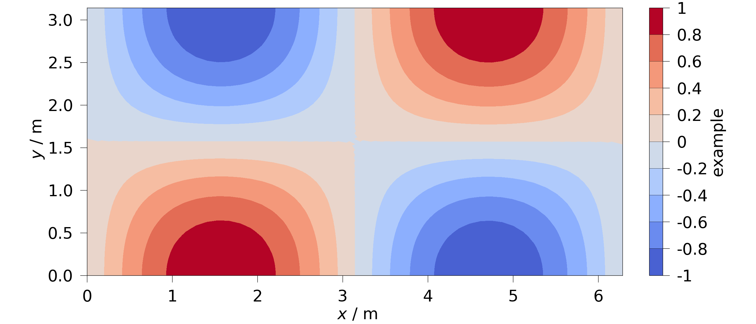

The following fits inside the defined limits and gets displayed with true proportions.
fig = ot.plot.contourf(custom_mesh(np.pi * 2, np.pi), "example")

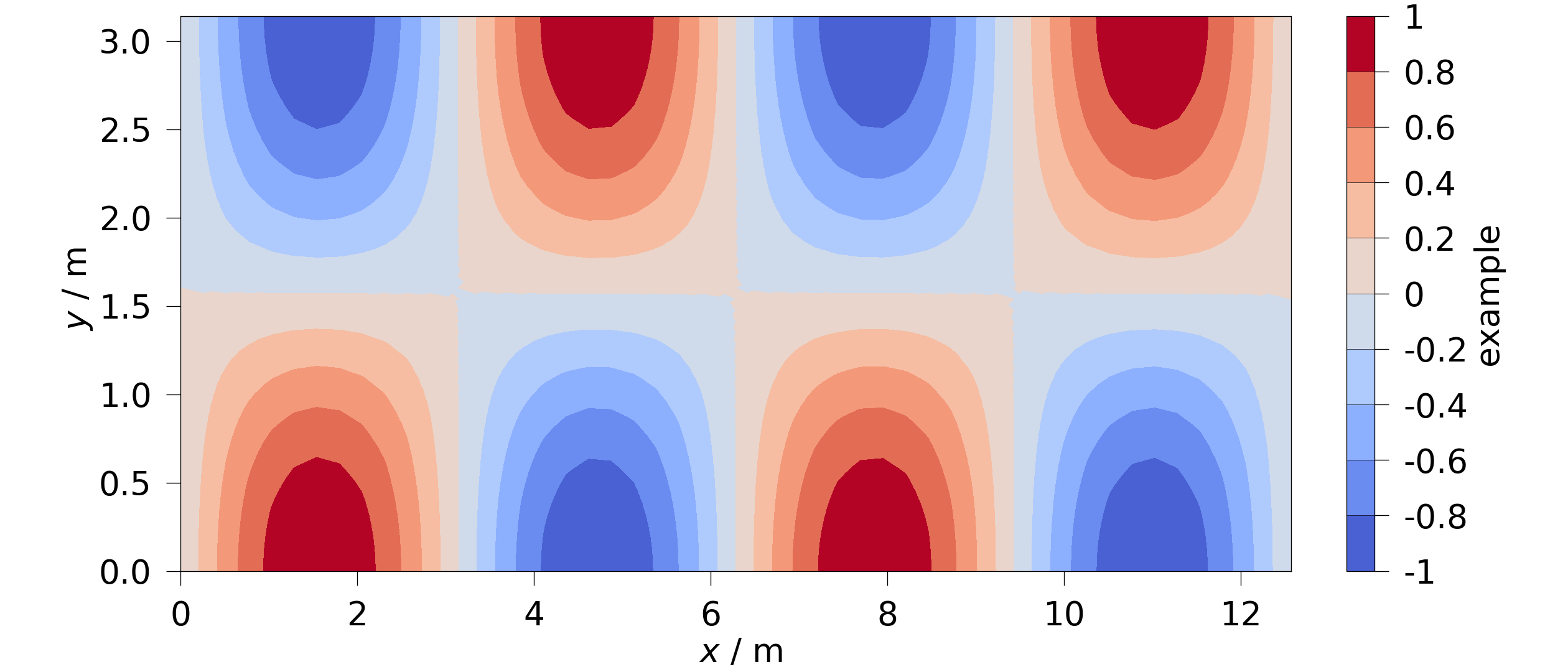

This one would be too wide and thus and gets compressed to fit the maximum aspect ratio.
fig = ot.plot.contourf(custom_mesh(np.pi * 4, np.pi), "example")

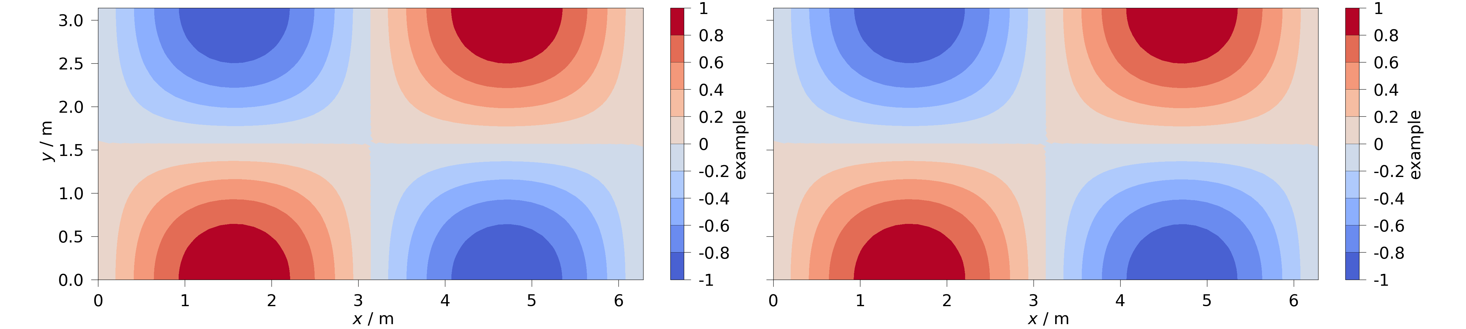

When plotting multiple meshes together, this applies to each subplot. So here each subplot has true proportions again since each one fits the limits.
    [custom_mesh(np.pi * 2, np.pi), custom_mesh(np.pi * 2, np.pi)], "example"
plot aspect ratios

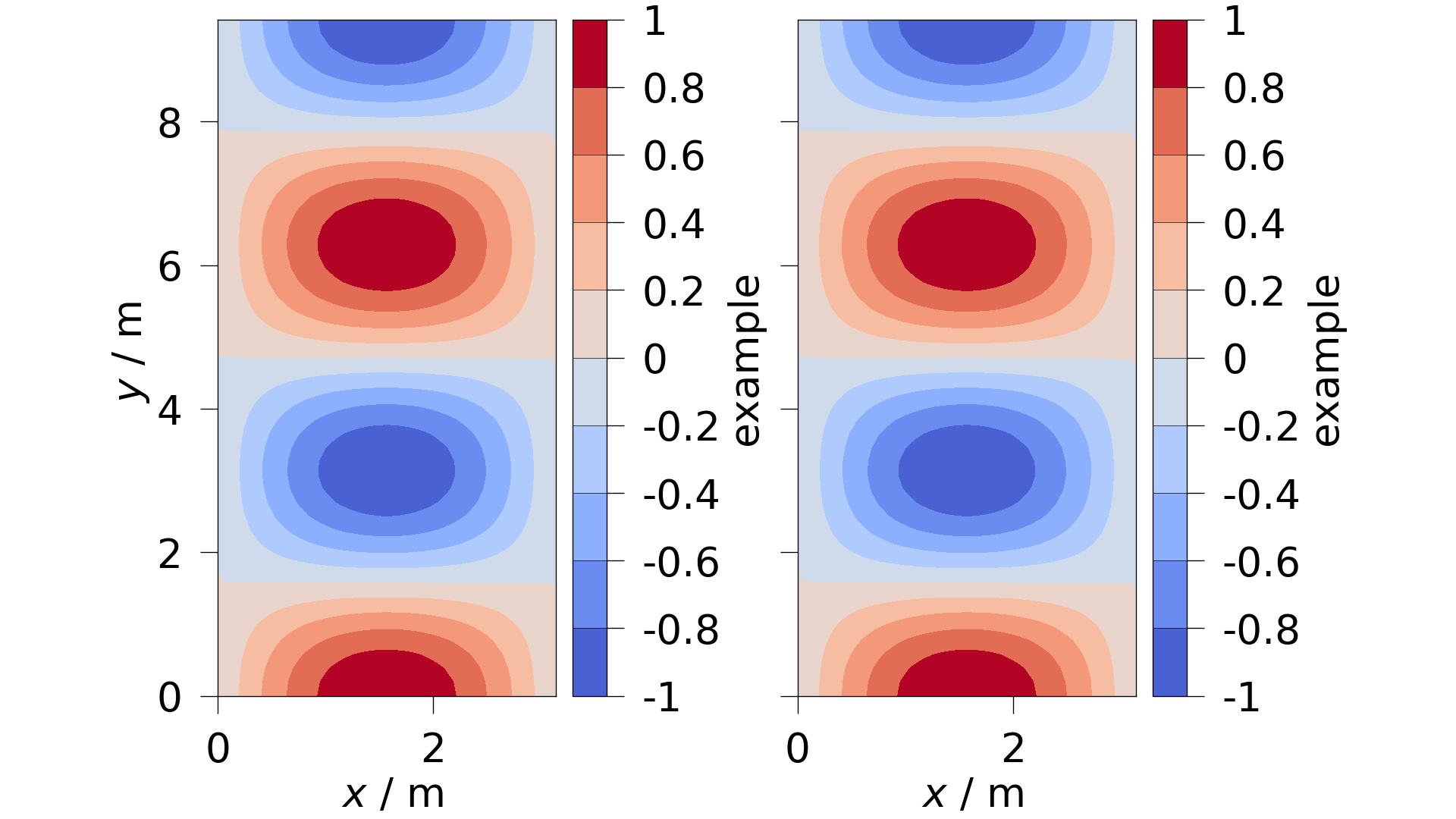

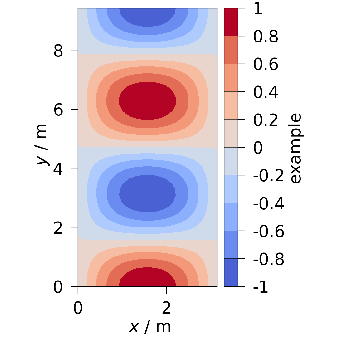

The following figure would be to tall and is clipped to the minimum aspect ratio.
fig = ot.plot.contourf(custom_mesh(np.pi, np.pi * 3), "example")
plot aspect ratios
The same is true here:
    [custom_mesh(np.pi, np.pi * 3), custom_mesh(np.pi, np.pi * 3)], "example"
plot aspect ratios

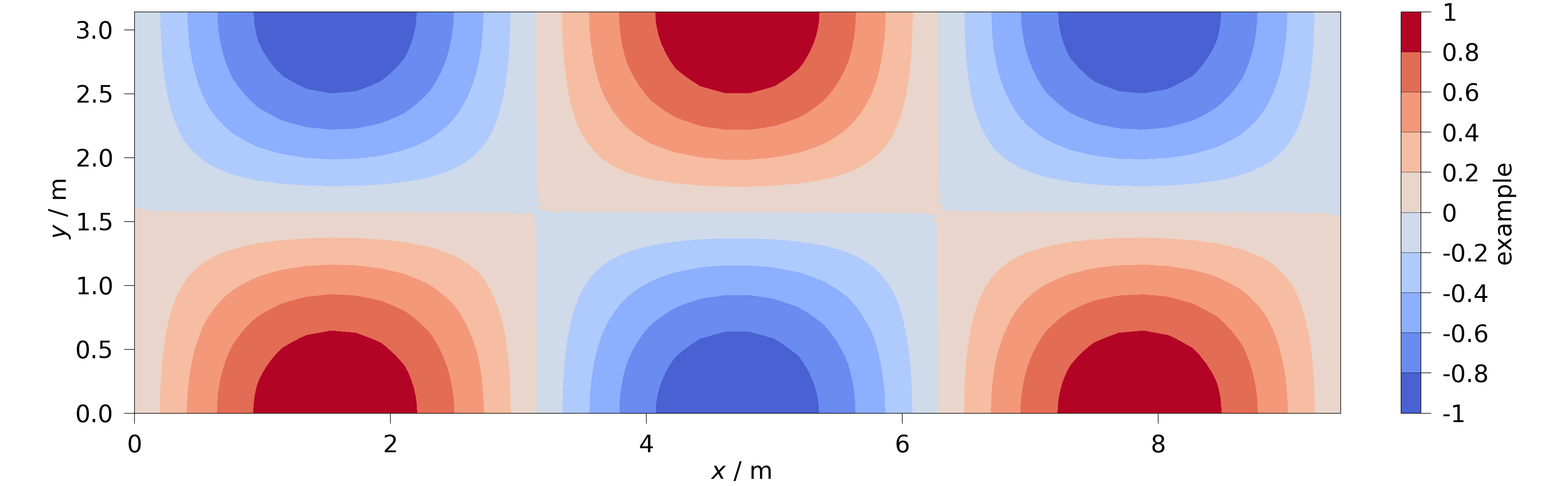

You can enforce true proportions regardless of the resulting figures dimensions, by setting the limiting values to None. In this case we get a very wide figure.
ot.plot.setup.min_ax_aspect = None
ot.plot.setup.max_ax_aspect = None
fig = ot.plot.contourf(custom_mesh(np.pi * 3, np.pi), "example")
plot aspect ratios

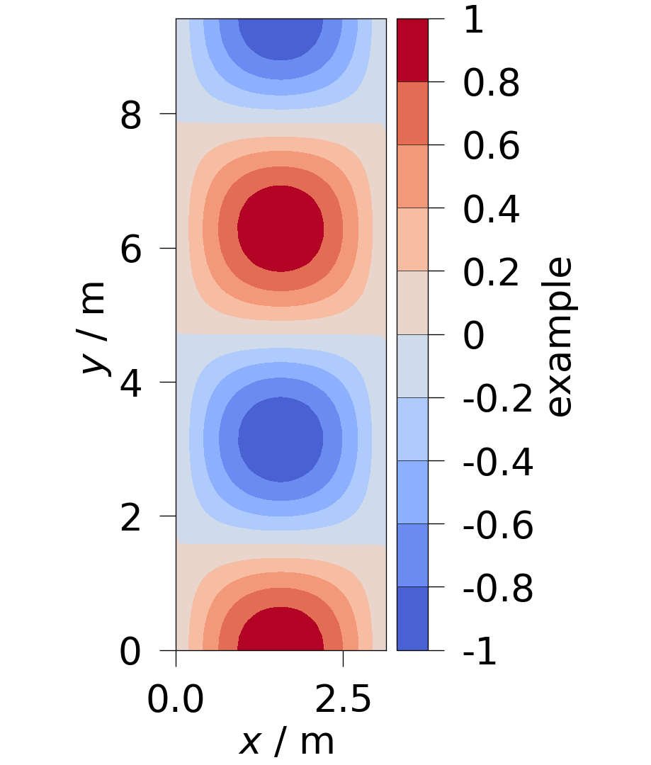

And in this case we get a very tall figure.
plot aspect ratios
