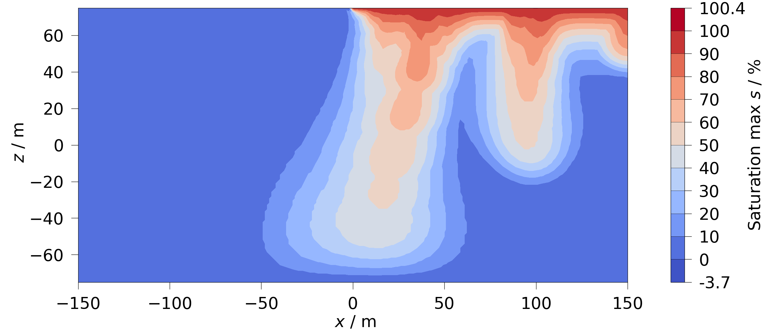

You aggregate the data in MeshSeries over all timesteps given some aggregation function, e.g. np.min, np.max, np.var (see: aggregate_temporal()). The following code gets the maximum saturation for each point in the mesh over all timesteps and plots it. Note: the data in the returned mesh has a suffix equal to the aggregation functions name. The plot function will find the correct data anyway if given the original variable
mesh = mesh_series.aggregate_temporal(saturation, np.max)
fig = ot.plot.contourf(mesh, saturation)
plot aggregate

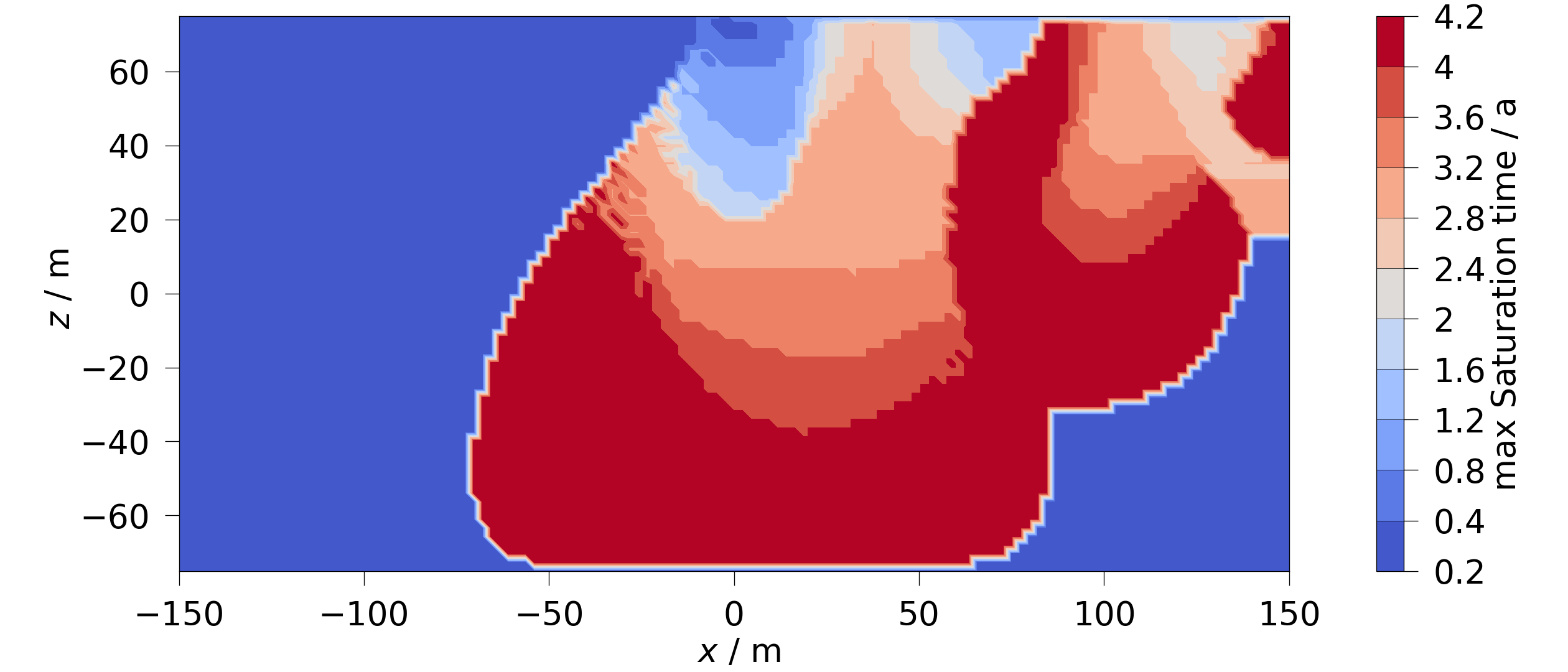

It is also possible to plot the time when the minimum or maximum occurs. However, here we have to use a new variable for the plot to handle the units correctly:
mesh = mesh_series.time_of_max(saturation)
    mesh, ot.variables.Scalar("max_Saturation_time", "a", "a")
plot aggregate

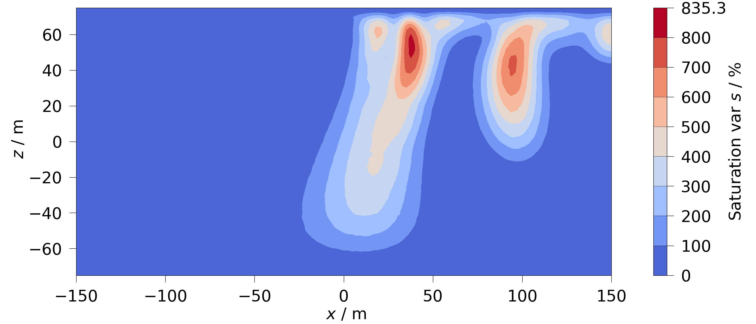

Likewise we can calculate and visualize the variance of the saturation:
mesh = mesh_series.aggregate_temporal(saturation, np.var)
plot aggregate

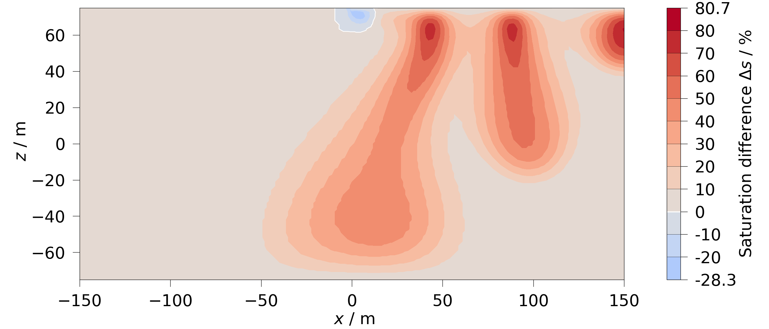

Difference between the last and the first timestep:
mesh = ot.mesh.difference(mesh_series.mesh(-1), mesh_series.mesh(0), saturation)
plot aggregate

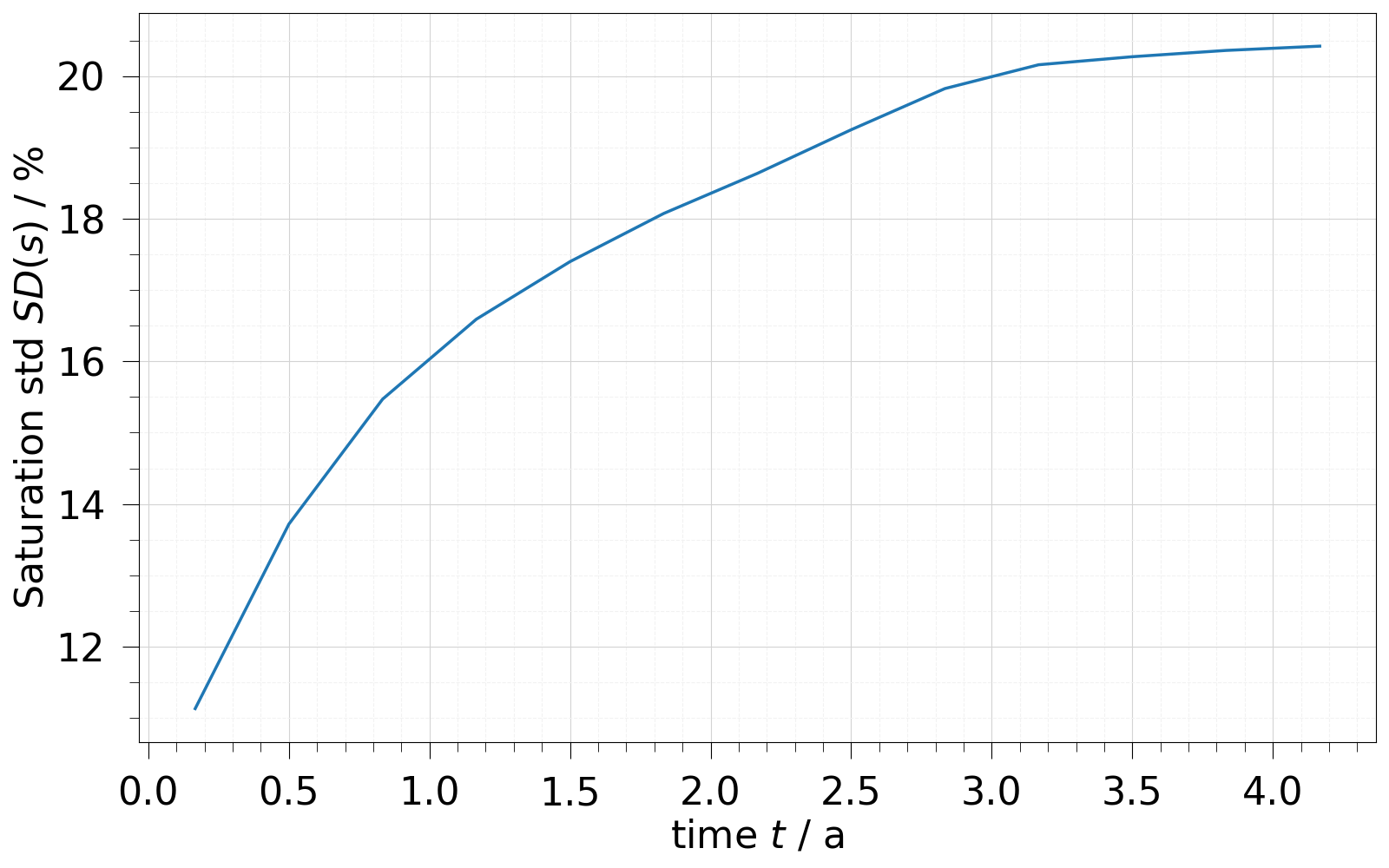

It’s also possible to aggregate the data per timestep to return a timeseries of e.g. the max or mean value of a variable in the entire domain.
mean_satuarion_array = mesh_series.aggregate_spatial(saturation, np.mean)
Instead of calculating the array itself, you can also plot it directly by using methods of the Variable which correspond to the equally named numpy-functions. The following are available: min, max, mean, median, sum, std, var.
fig = mesh_series.plot_line(saturation.std)
plot aggregate
