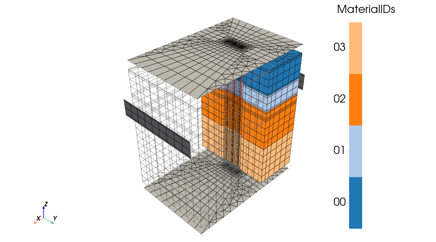

Create a simple prism mesh#
Generate a customizable prism BHE mesh:
bhe_meshes = gen_bhe_mesh(
    model_area=Polygon.from_bounds(xmin=0, ymin=0, xmax=150, ymax=100),
    layer=[50, 50, 50],
    groundwater=Groundwater(
        begin=-30,
        isolation_layer_id=1,
        upstream=(179, 181),
        downstream=(359, 1),
    BHE_Array=[
        BHE(x=50, y=40, z_begin=-1, z_end=-60, borehole_radius=0.076),
        BHE(x=50, y=50, z_begin=-1, z_end=-60, borehole_radius=0.076),
        BHE(x=50, y=60, z_begin=-1, z_end=-60, borehole_radius=0.076),
    refinement_area=Polygon.from_bounds(xmin=40, ymin=30, xmax=60, ymax=70),
    meshing_type="prism",
    meshname="bhe_prism",
Load the domain mesh and all submeshes, extract the BHE lines and visualize it all:
def load_and_plot(bhe_meshes: ot.Meshes):
    bhe_line = bhe_meshes.domain.extract_cells_by_type(pv.CellType.LINE)
    offsets = [(0, 0, 10), (0, 0, -10), (10, 0, 0), (-10, 0, 0)]
    plotter = ot.plot.contourf(
        bhe_meshes.domain.clip("x", origin=bhe_line.center, crinkle=True),
        ot.variables.material_id,
    plotter.add_mesh(bhe_meshes.domain, style="wireframe", color="grey")
    plotter.add_mesh(bhe_line, color="r", line_width=3)
    for submesh, offset in zip(
        bhe_meshes.subdomains.values(), offsets, strict=True
        plotter.add_mesh(
            submesh.translate(offset), show_edges=True, color="lightgrey"
    plotter.show()
load_and_plot(bhe_meshes)
plot gen bhe mesh

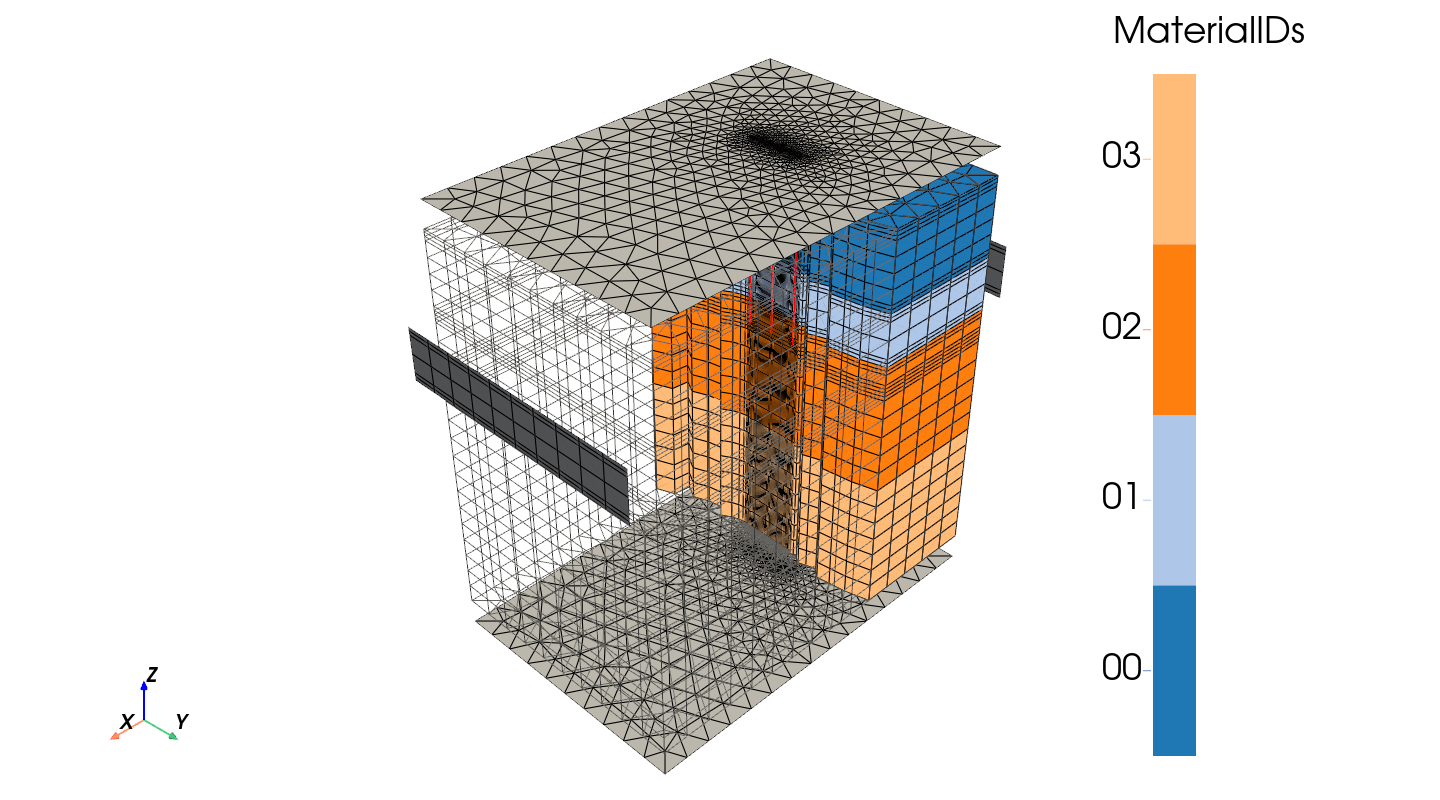

Create a simple structured mesh#
Generate a customizable structured BHE mesh:
    layer=[50, 50, 50],
        begin=-30,
    BHE_Array=[
    meshing_type="structured",
    meshname="bhe_prism_2",
Load the domain mesh and all submeshes as well as extract the BHE lines:
plot gen bhe mesh

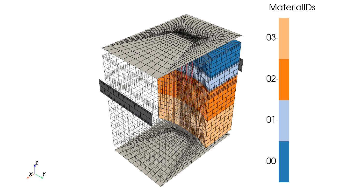

Create an advanced structured mesh#
Generate a customizable structured BHE mesh with advanced mesh sizing options (using gmsh). By adding additional points to the model_area, the subdivison of the surface by the structured mesh algorithm is controlled. To understand the specific behaviour of every mesh parameter, test each one after another.
../../_images/gen_bhe_mesh.svg
    # add additional points for better subsidivision of the surface by structured algorithm
    # compare with previous example, to see the difference
    model_area=Polygon(
            (0.0, 0.0),
            (40.0, 0.0),
            (60.0, 0.0),
            (150.0, 0.0),
            (150.0, 100.0),
            (60.0, 100.0),
            (40.0, 100.0),
            (0.0, 100.0),
    layer=[50, 50, 50],
        begin=-30,
    BHE_Array=[
        BHE(50, 40, -1, -60, 0.076),
        BHE(50, 50, -1, -60, 0.076),
        BHE(50, 60, -1, -60, 0.076),
    target_z_size_coarse=10,  # default value 7.5
    target_z_size_fine=2,  # default value 1.5
    n_refinement_layers=1,  # default value 2
    propagation=1.2,  # default value 1.1
    inner_mesh_size=8,  # default value 5
    outer_mesh_size=12,  # default value 10
    meshname="bhe_structured",
plot gen bhe mesh
