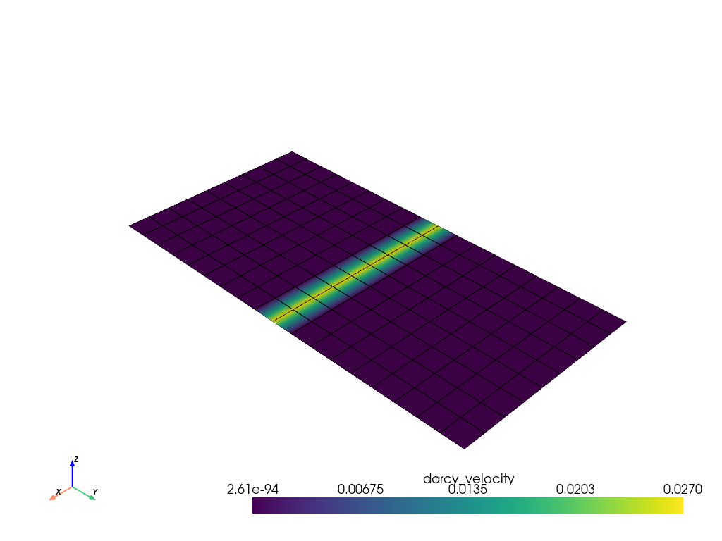

To get a single mesh at a specified timestep you can use the mesh() method of a MeshSeries object (in this example: ms). Another way to to do so is by indexing the MeshSeries object with brackets (ms[timestep]). Besides custom ogstools functions you can use all available pyvista functions. Here we use pyvista’s plot function.
mesh_ts10 = ms.mesh(10) # or ms[10]
mesh_ts10.plot(show_edges=True)

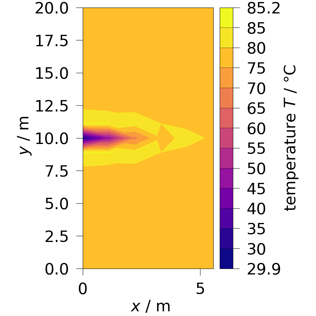

You can also use pyvista dataset filters to transform the domain for the
entire MeshSeries.
ms_right_half = ms.transform(
lambda mesh: mesh.clip("x", origin=mesh.center, crinkle=True)
temp_right_half = ms_right_half.values("temperature")
print("Data on clipped domain:", np.shape(temp_right_half))
Data on clipped domain: (97, 114)
Let’s plot the last timestep of the transformed MeshSeries.
fig = ot.plot.contourf(ms_right_half[-1], "temperature")
