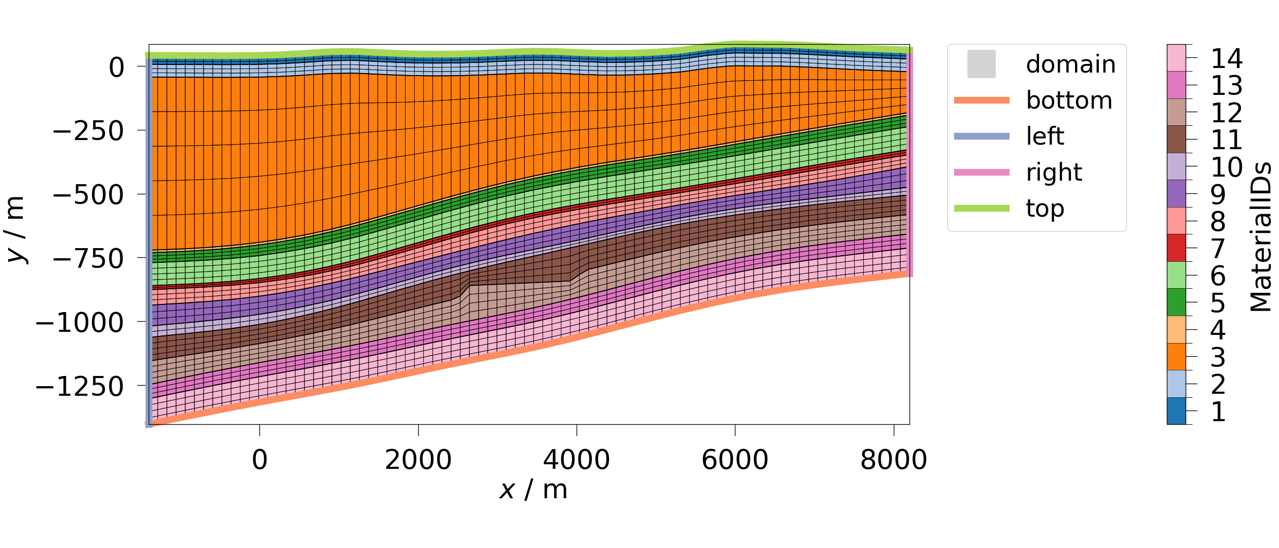

Let’s display and save them:
fig = meshes.plot()
plot extract boundaries
meshes.save()  # optionally, provide a path

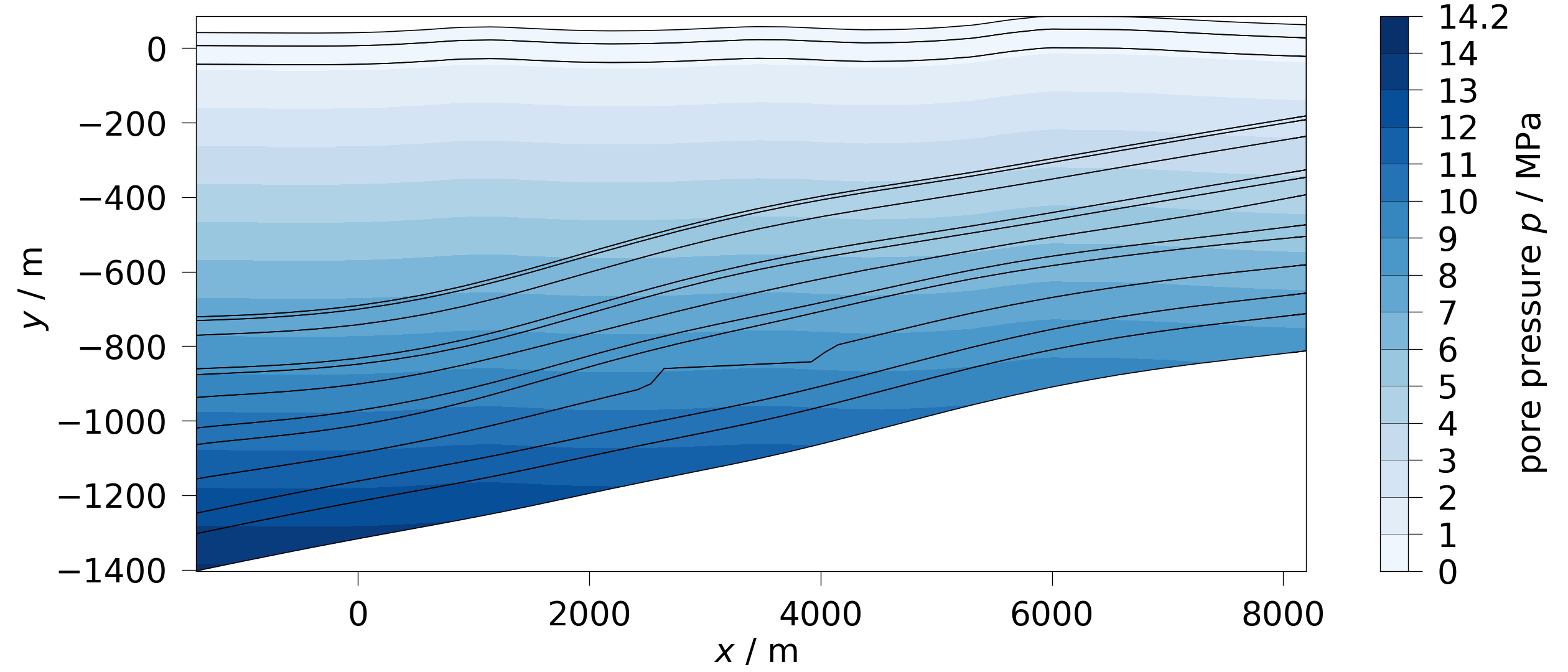

By having the top mesh as a boundary, you can calculate a depth-based water column as an initial conditions or for calculations of integrity criteria
depth = ot.mesh.depth(meshes.domain, meshes["top"])
meshes.domain.point_data["pressure"] = 1000 * 9.81 * depth
fig = ot.plot.contourf(meshes.domain, "pressure")

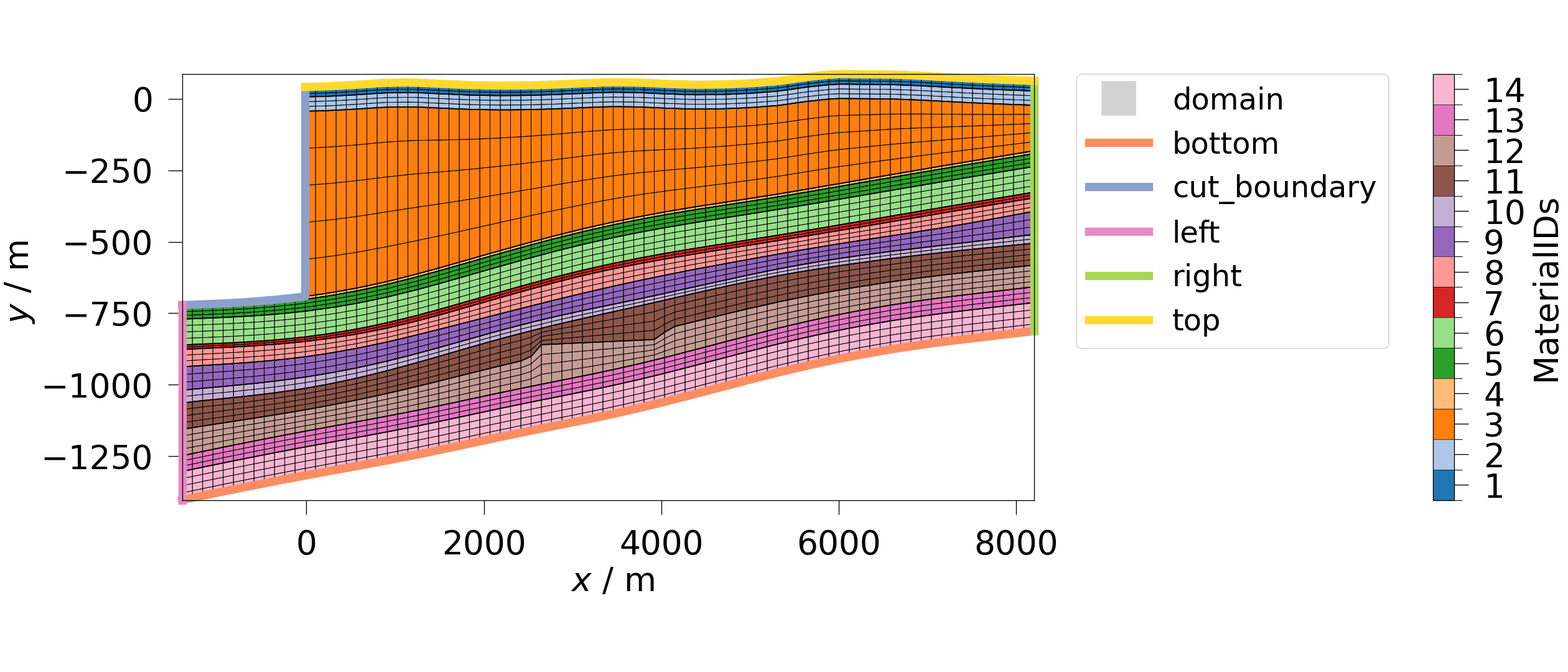

If you need to model an excavation or similar, the Meshes class provides the useful method remove_material() which removes a specified material from the domain and updates the boundary meshes accordingly. The following example is only for demonstration and is not meant to make practical sense.
x = domain.cell_centers().points[:, 0]
mat_ids = domain["MaterialIDs"]
mat_ids[(mat_ids <= 3) & (x < 0)] = 99
meshes.remove_material(99)
fig = meshes.plot()
