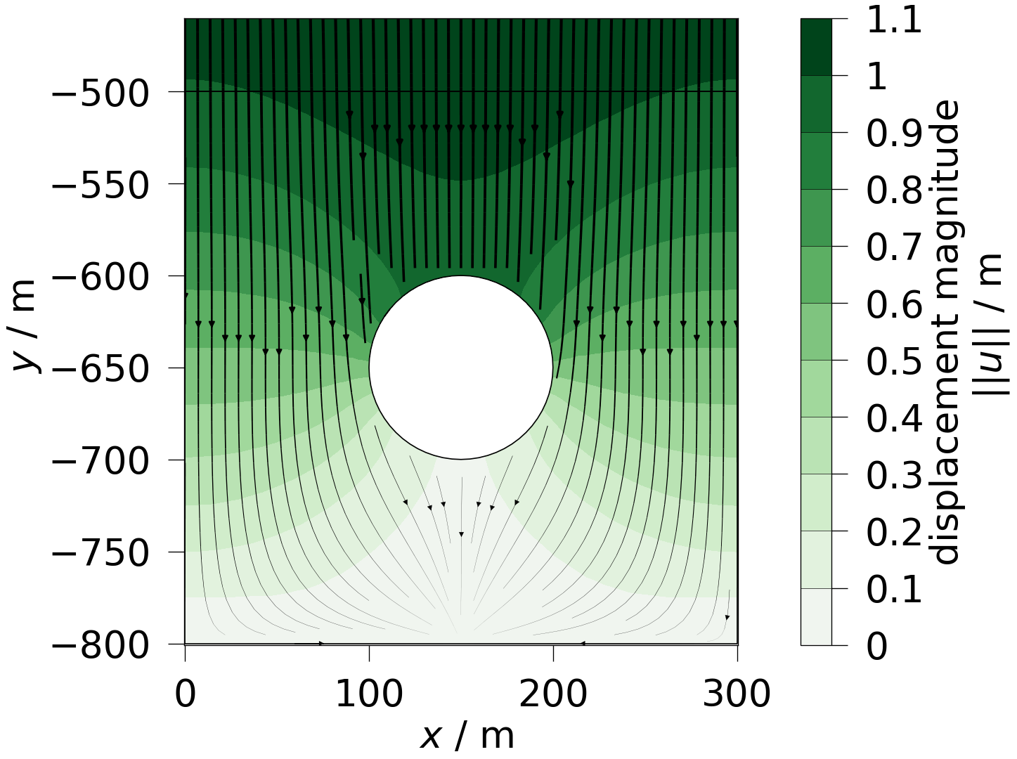

Stress analysis#
The following example from the ogs benchmark collection is used for the stress analysis:
<https://www.opengeosys.org/docs/benchmarks/thermo-mechanics/creepafterexcavation/>
fig = ot.plot.contourf(mesh, ot.variables.displacement)
plot solid mechanics

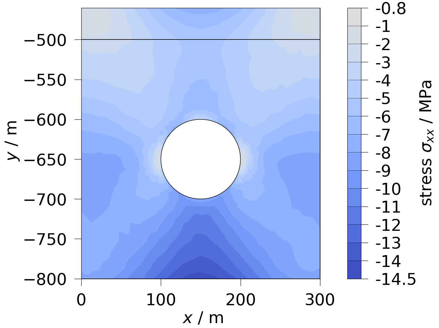

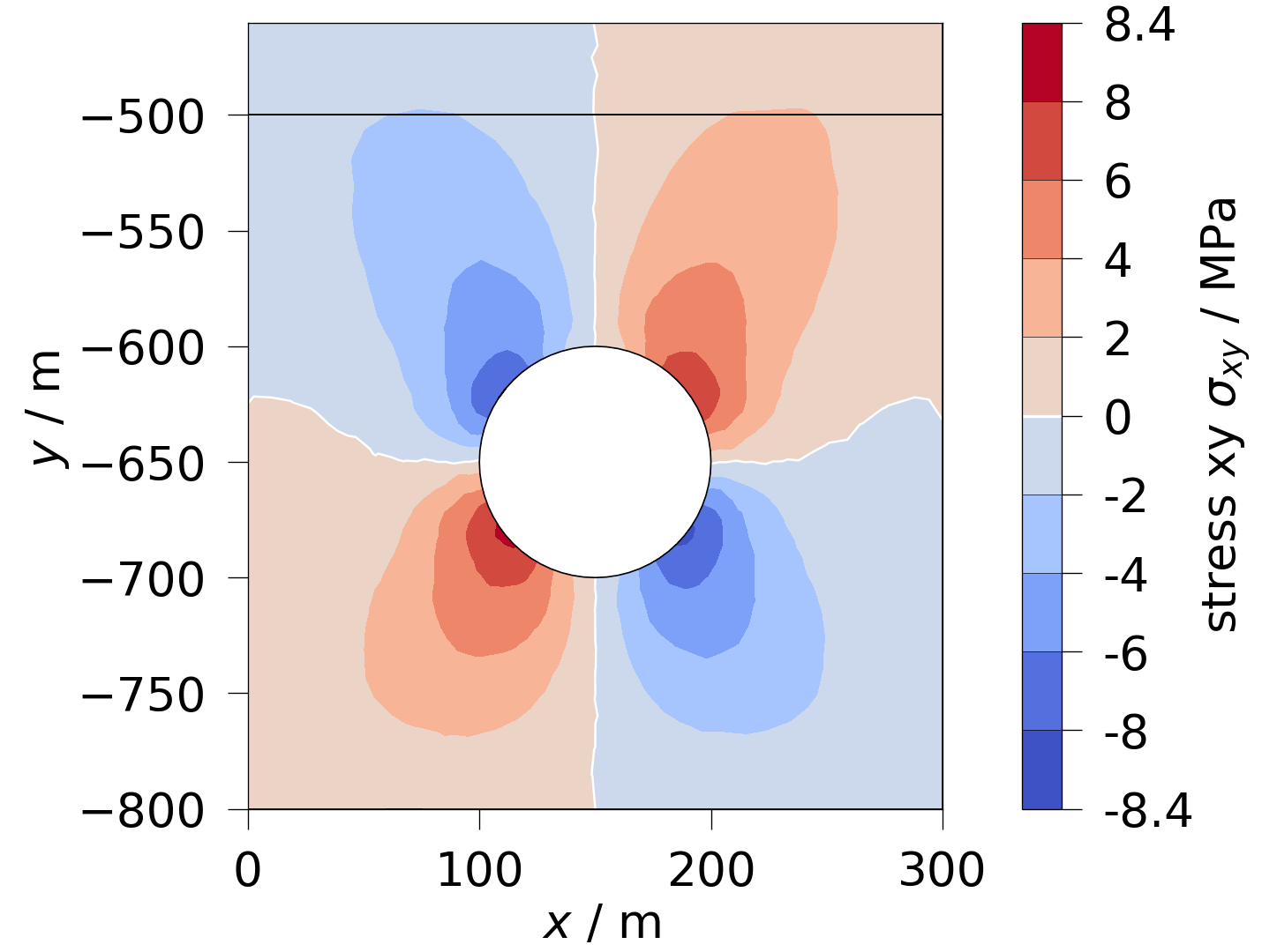

We can inspect the stress (or strain) tensor components by indexing.
fig = ot.plot.contourf(mesh, ot.variables.stress["xx"])
fig = ot.plot.contourf(mesh, ot.variables.stress["xy"])

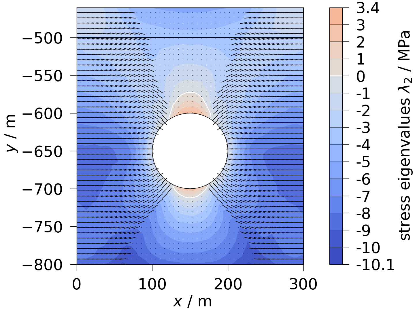

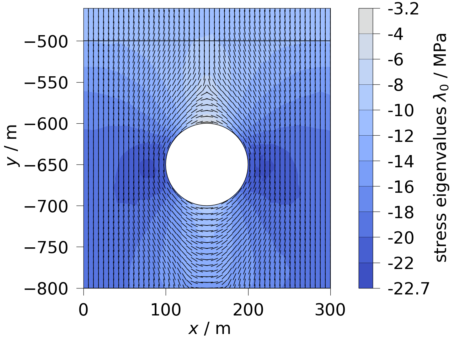

Principal stresses#

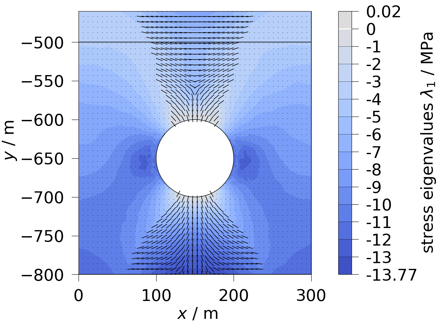

Let’s plot the the principal stress components and also overlay the direction of the corresponding eigenvector in the plot. Note: the eigenvalues are sorted by increasing order, i.e. eigenvalue[0] is the most negative / largest compressive principal stress.
eigvecs = ot.variables.stress.eigenvectors
fig = ot.plot.contourf(mesh, variable=ot.variables.stress.eigenvalues[0])
ot.plot.quiver(mesh, ax=fig.axes[0], variable=eigvecs[0], glyph_type="line")
fig = ot.plot.contourf(mesh, variable=ot.variables.stress.eigenvalues[1])
ot.plot.quiver(mesh, ax=fig.axes[0], variable=eigvecs[1], glyph_type="line")

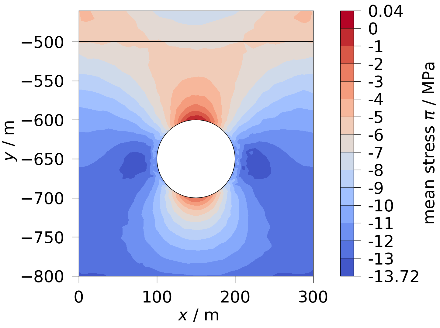

We can also plot the mean of the principal stress, i.e. the magnitude of the hydrostatic component of the stress tensor. see: ogstools.variables.tensor_math.mean()
fig = ot.plot.contourf(mesh, ot.variables.stress.tensor_mean)

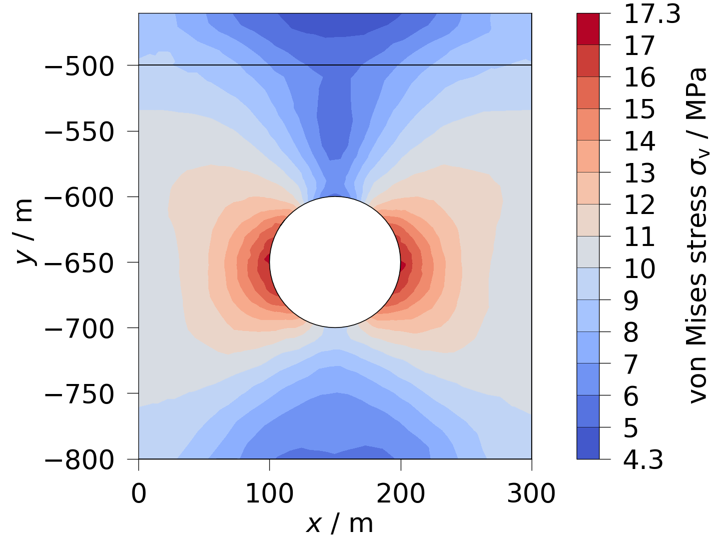

Von Mises stress#
see: ogstools.variables.tensor_math.von_mises()
fig = ot.plot.contourf(mesh, ot.variables.stress.von_Mises)

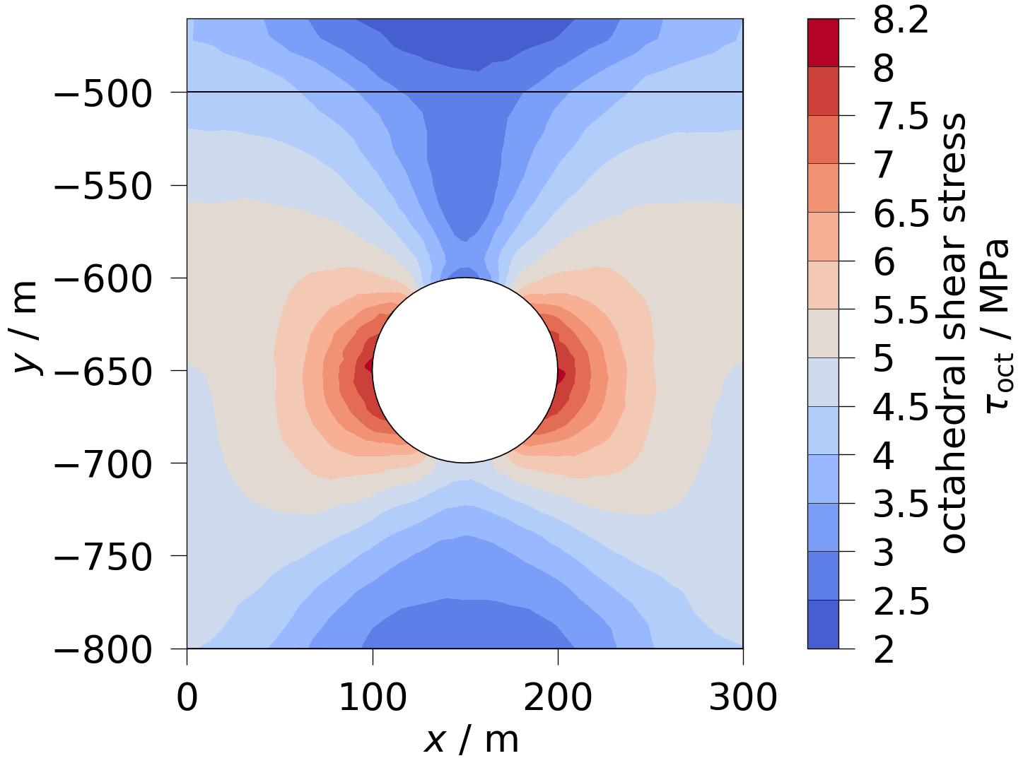

octahedral shear stress#
see: ogstools.variables.tensor_math.octahedral_shear()
fig = ot.plot.contourf(mesh, ot.variables.stress.octahedral_shear)

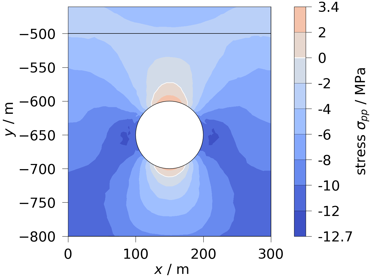

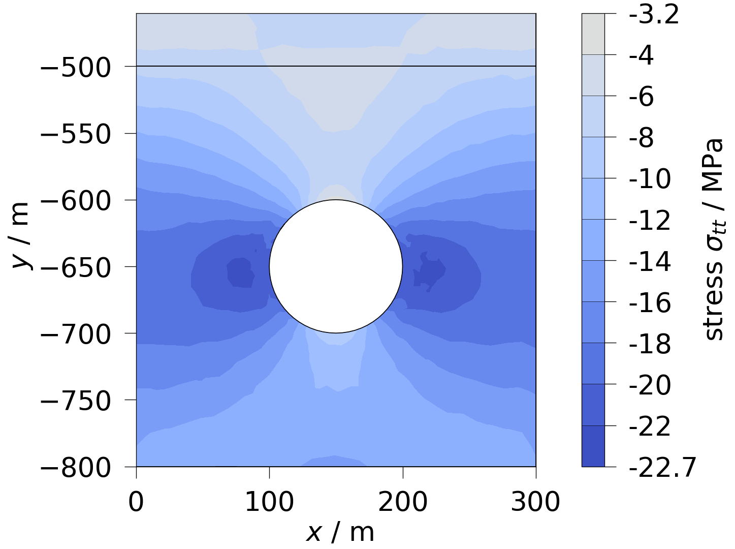

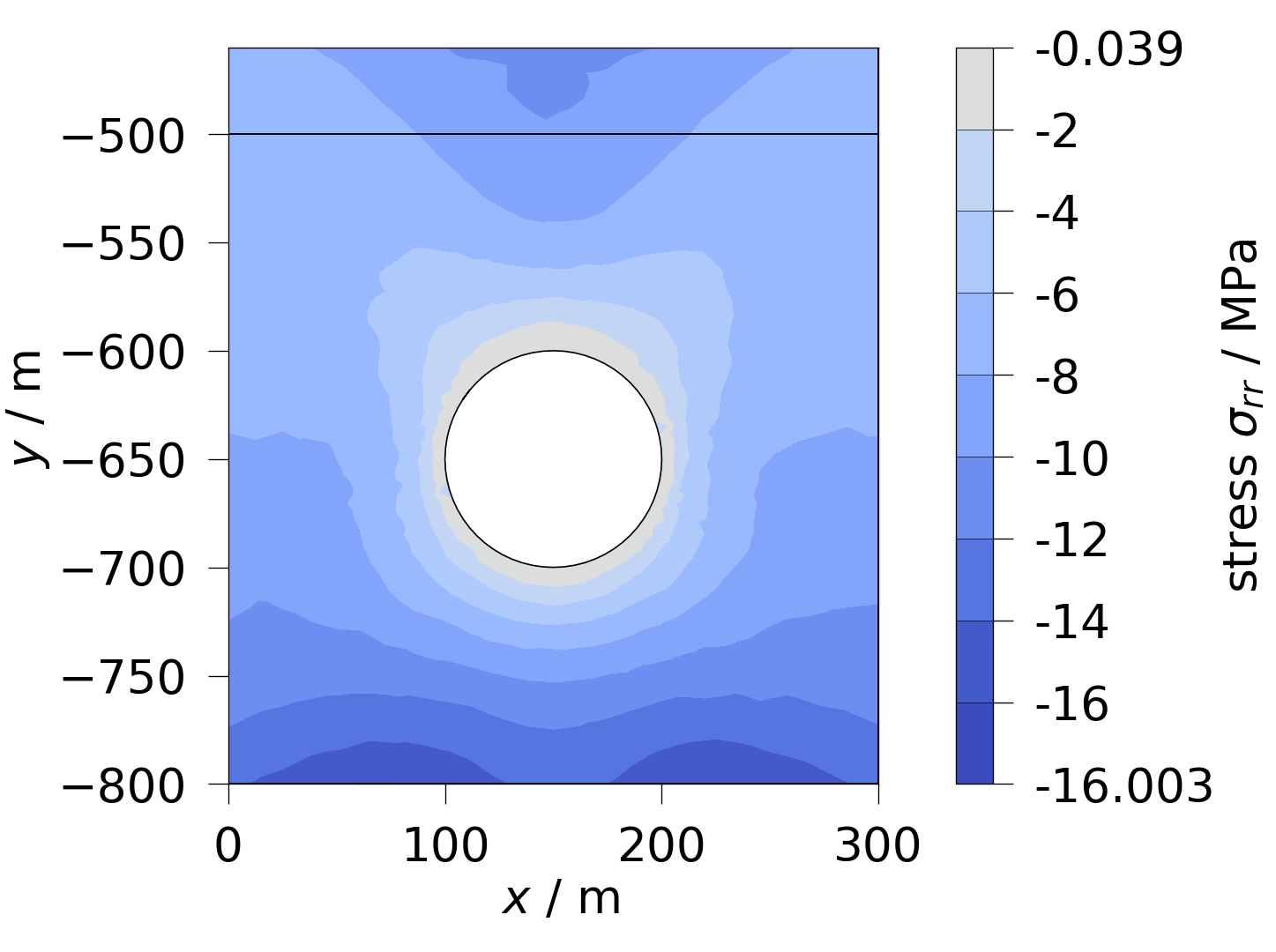

Stresses in polar coordinates#
You can inspect stresses in a polar coordinate system by deriving a new Variable from the stress Variable. Specify the polar center and, if needed, the rotation axis (default is z-axis: [0, 0, 1]).
polar_stress = ot.variables.stress.to_polar(center=(150, -650, 0))
fig = ot.plot.contourf(mesh, polar_stress["rr"])
fig = ot.plot.contourf(mesh, polar_stress["tt"])
fig = ot.plot.contourf(mesh, polar_stress["pp"])
  • plot solid mechanics

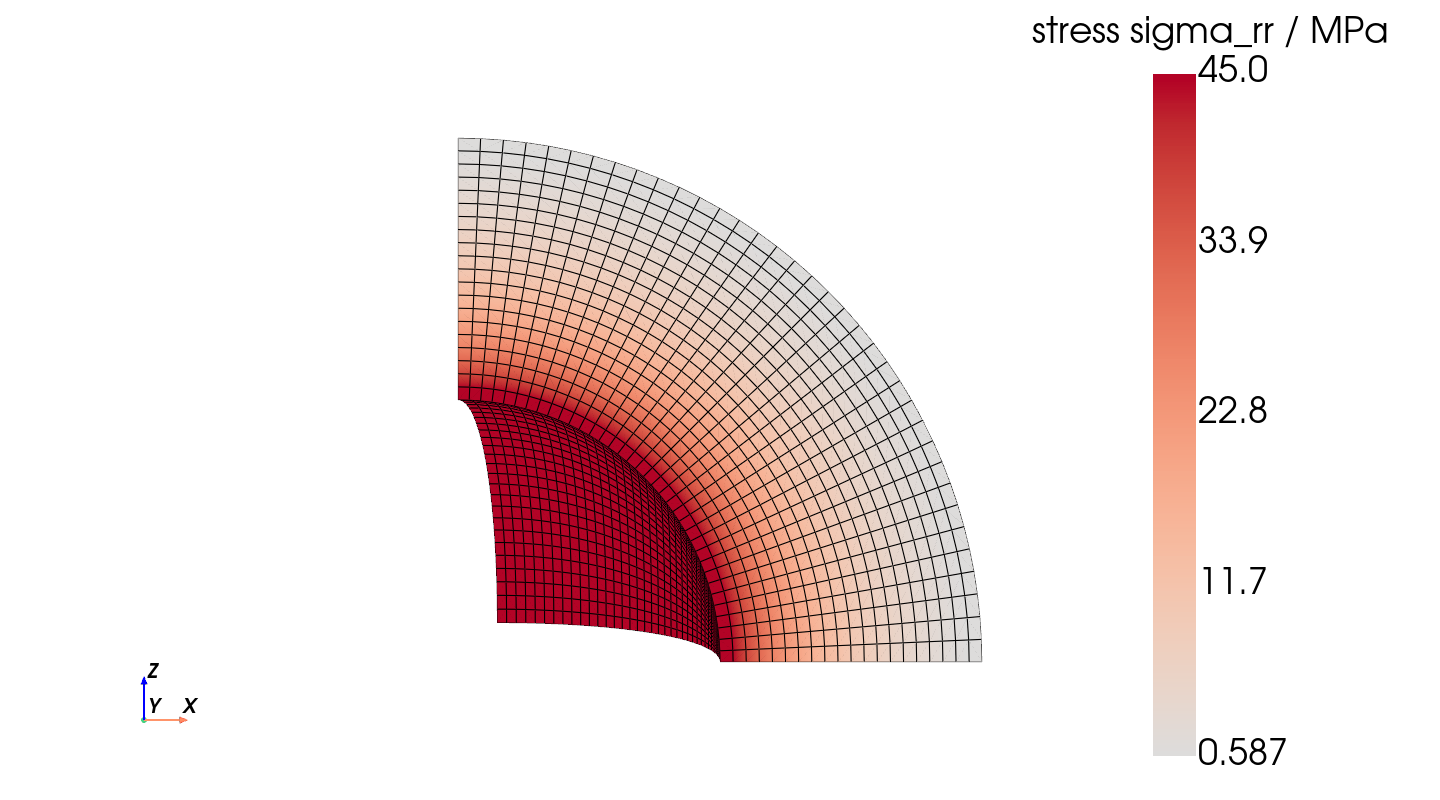

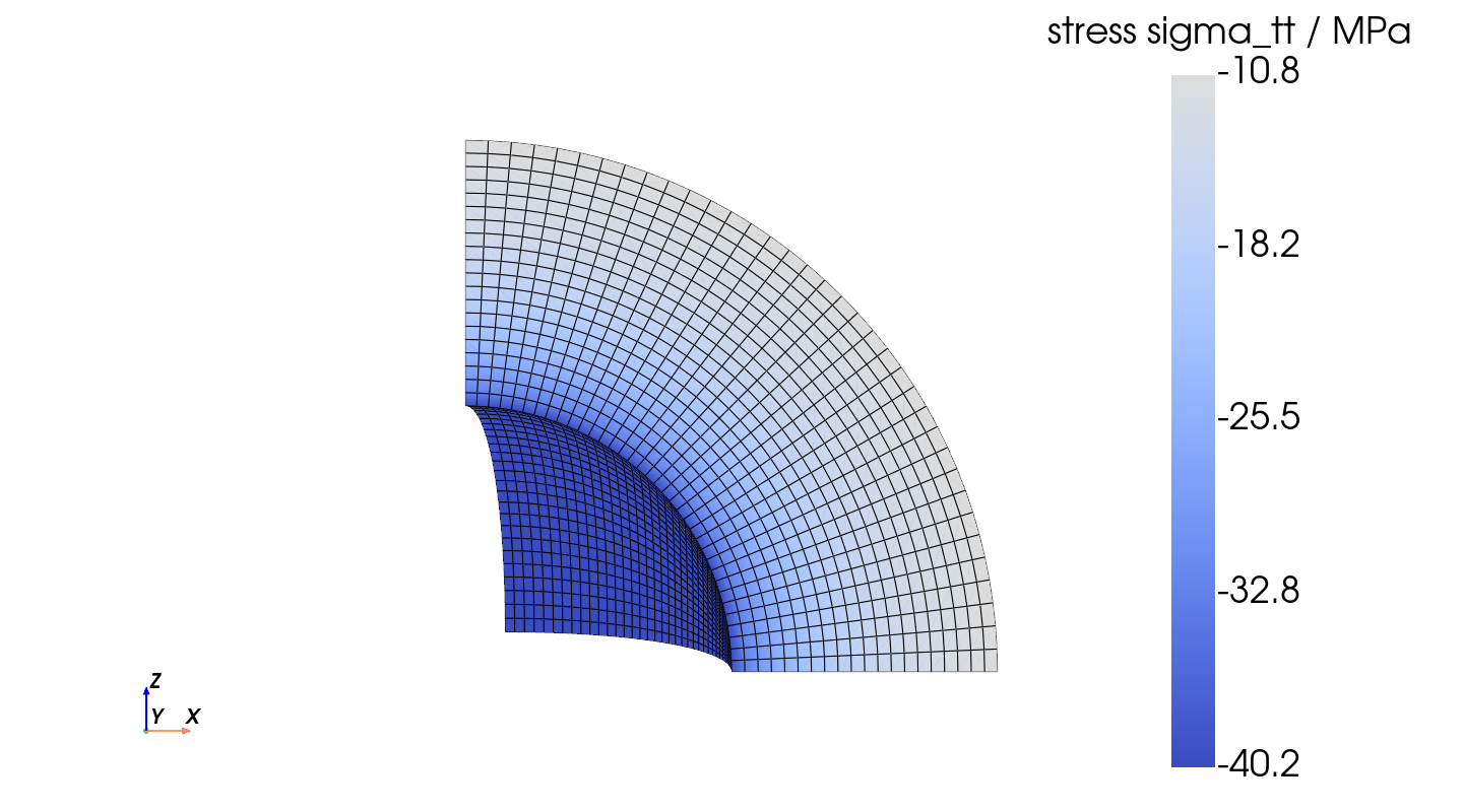

Here is a 3D example with a cylindrical hole at (0, 0, 0) in y direction:
mesh_3D = examples.load_mesh_mechanics_3D_sphere()
polar_stress_3D = ot.variables.stress.to_polar()
for comp in ["rr", "tt", "pp"]:
    pl = ot.plot.contourf(mesh_3D, polar_stress_3D[comp])
    pl.view_xz()
    pl.show()

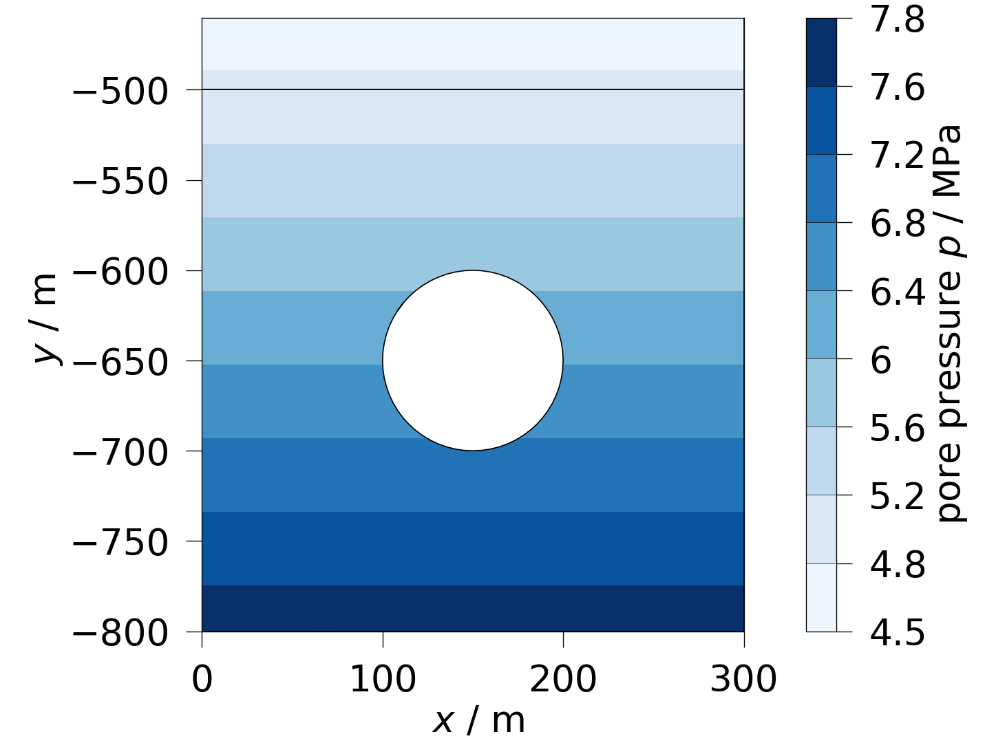

Integrity criteria#
Evaluating models regarding their integrity is often dependent on the fluid pressure. If not already present, we have to calculate it manually, e.g. as a hypothetical water column proportional to the depth.
mesh["pressure"] = -1000 * 9.81 * mesh.points[:, 1]
fig = ot.plot.contourf(mesh, ot.variables.pressure)

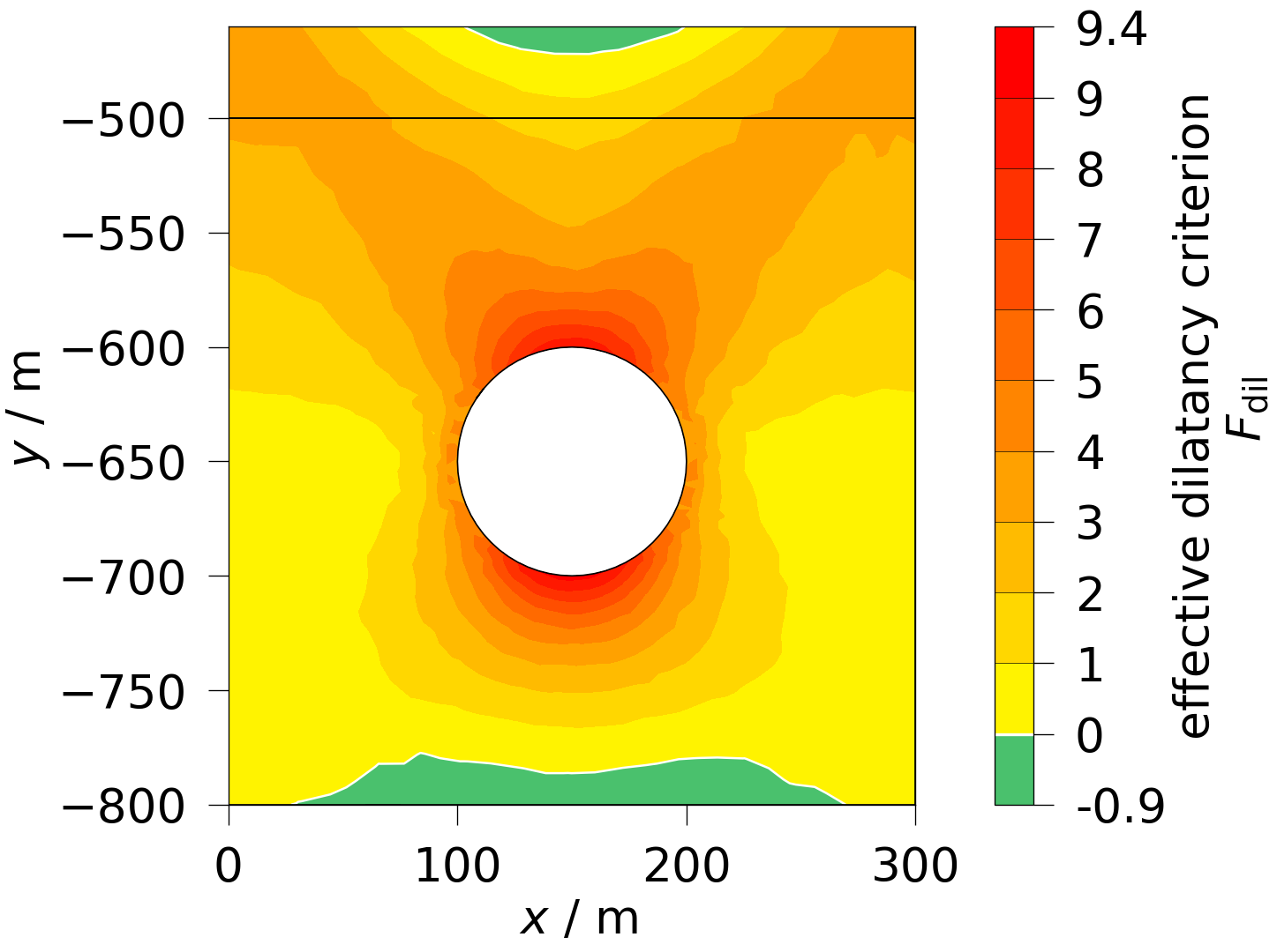

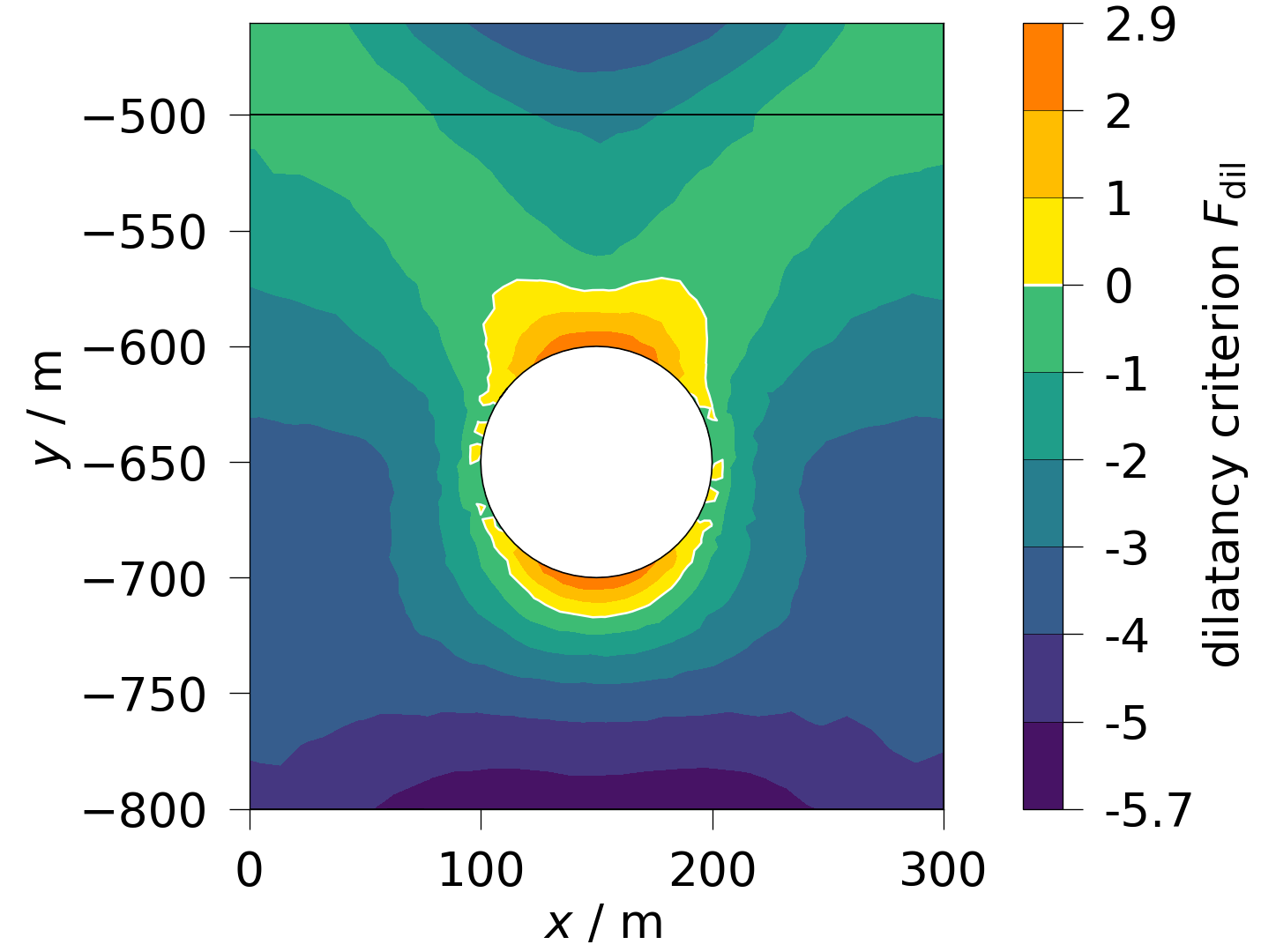

Dilantancy criterion#
see: ogstools.variables.mesh_dependent.dilatancy_critescu()
fig = ot.plot.contourf(mesh, ot.variables.dilatancy_critescu_tot)
fig = ot.plot.contourf(mesh, ot.variables.dilatancy_critescu_eff)

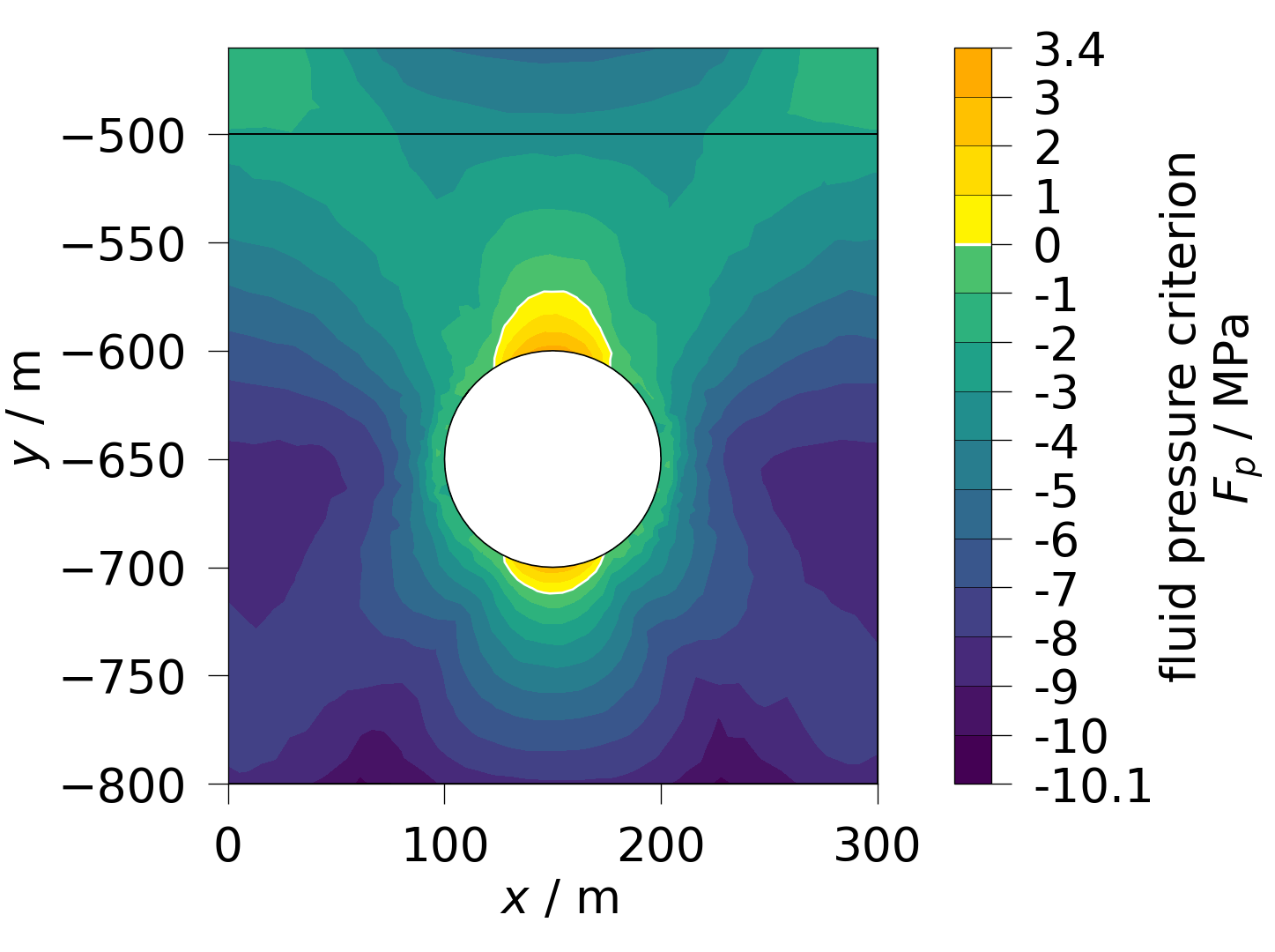

Fluid pressure criterion#
see: ogstools.variables.mesh_dependent.fluid_pressure_criterion()
fig = ot.plot.contourf(mesh, ot.variables.fluid_pressure_crit)
