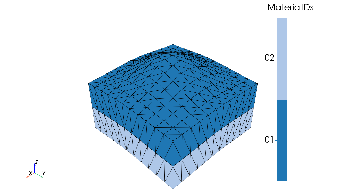

Visualize the prism mesh
if tetgen_present:
plotter = ot.plot.contourf(mesh, ot.variables.material_id)
plotter.show()
