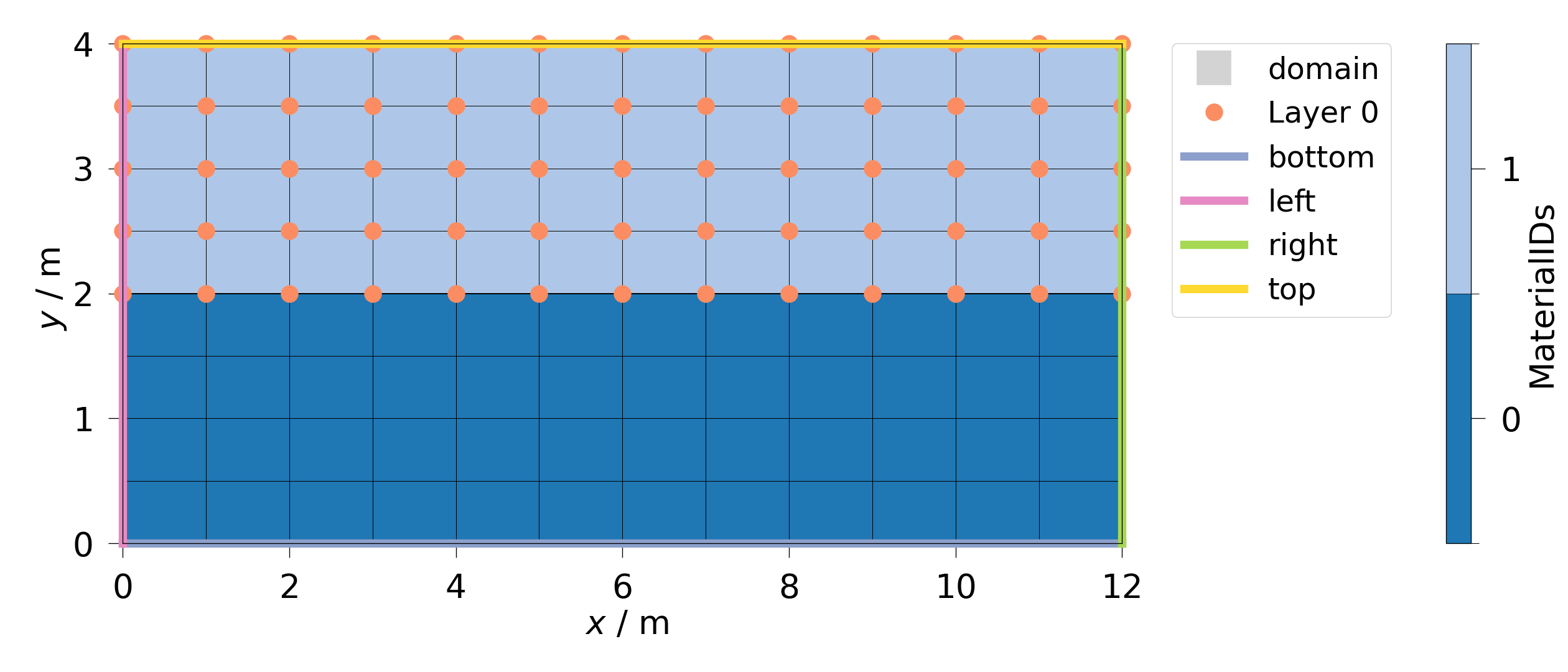

Understanding Meshes: Input Geometry with PyVista#
Meshes is the input mesh for OGS. Technically it is a collection of PyVista Unstructured grids that represent
your simulation domain. You can access and manipulate individual meshes:
# Access a specific boundary mesh
print(f"Available meshes: {list(meshes.keys())}")
# Meshes are PyVista objects - The example shows how you can set initial conditions or properties
meshes["right"].point_data["pressure"] = np.full(meshes["left"].n_points, 3.1e7)
# Visualize the mesh topology
fig_topology = meshes.plot()
Available meshes: ['domain', 'bottom', 'top', 'right', 'left', 'Layer 0']

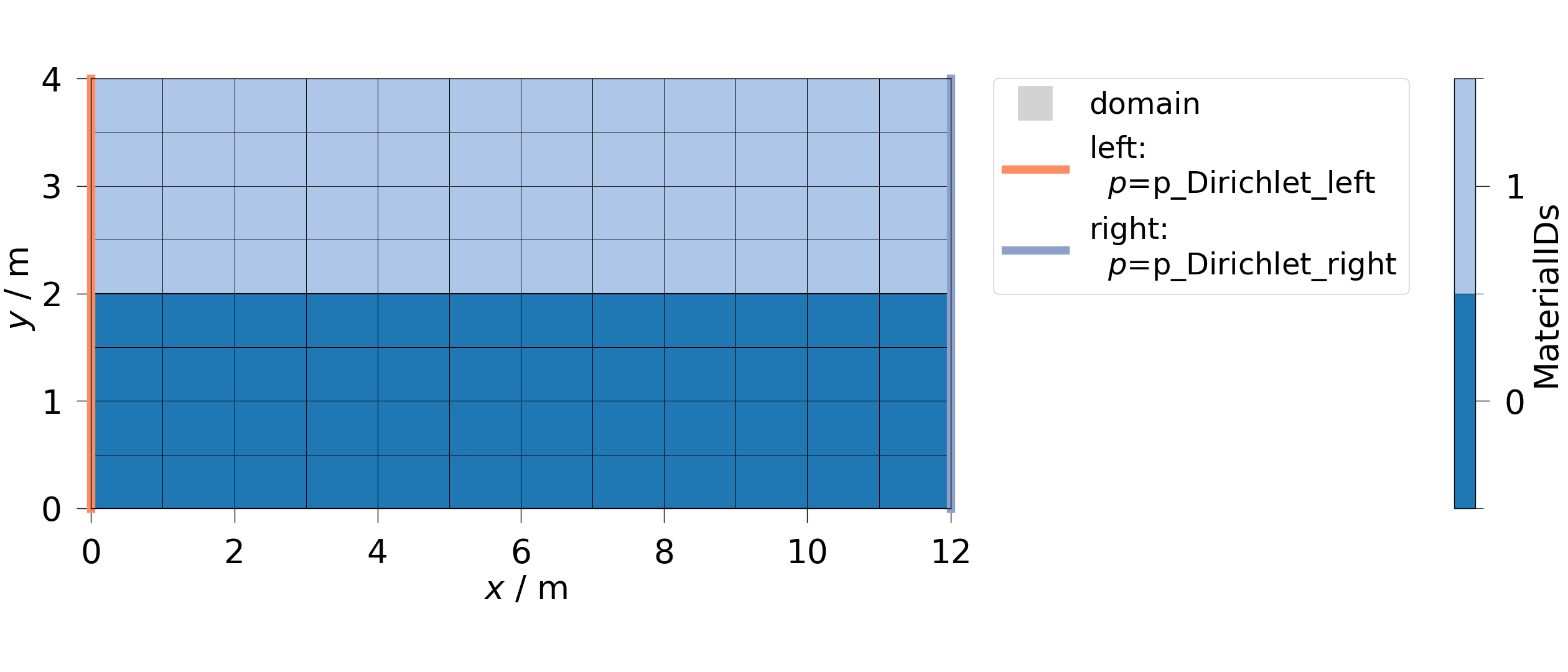

model = ot.Model(project=project, meshes=meshes)
# Optionally configure execution settings
# e.g. model.execution.interactive = True # Uncomment for stepwise control
# Visualize the model setup with boundary conditions
fig_constraints = model.plot_constraints()
The constraints plot shows your model domain with annotated boundary conditions and source terms, making it easy to verify your setup before running.

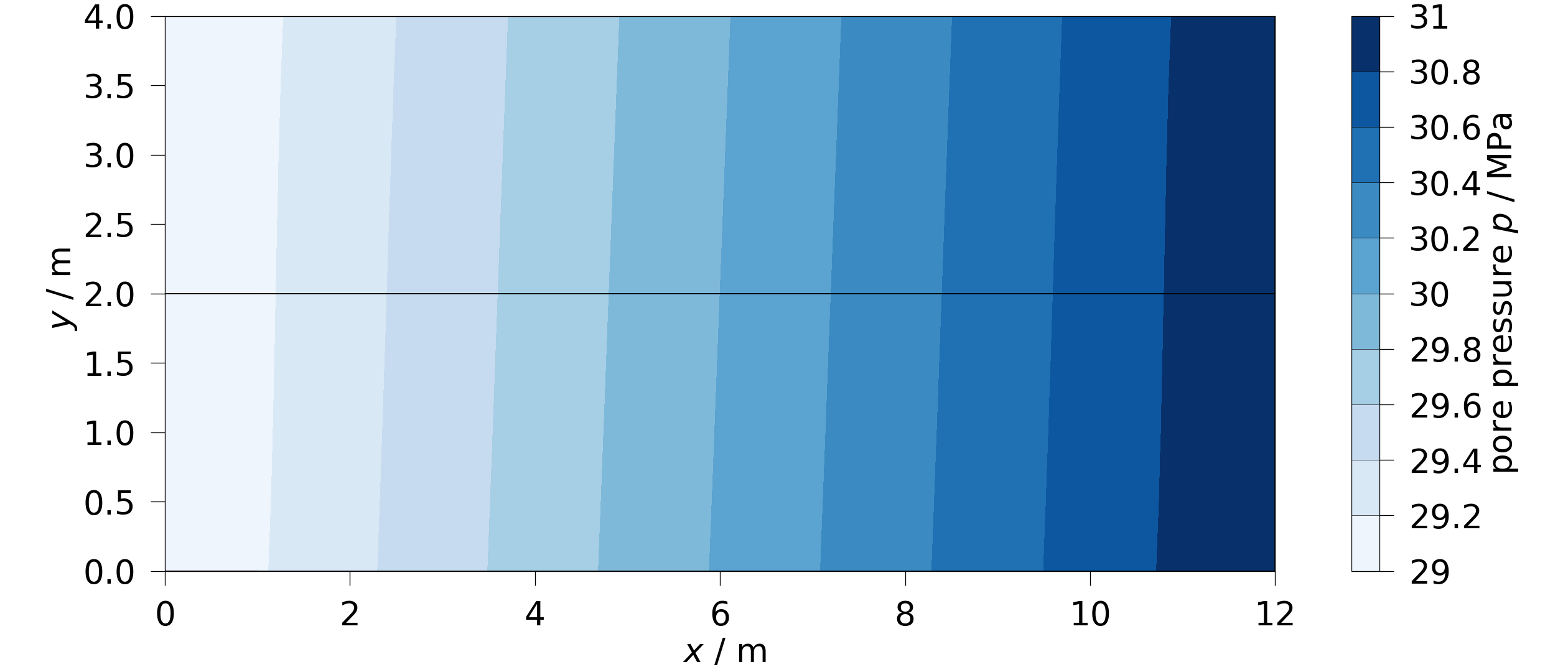

The sim.result property provides a MeshSeries interface to your output data.
You can index it like a list to get results at specific timesteps:
# Get the final timestep and plot pressure distribution
fig = ot.plot.contourf(sim.meshseries[-1], "pressure")

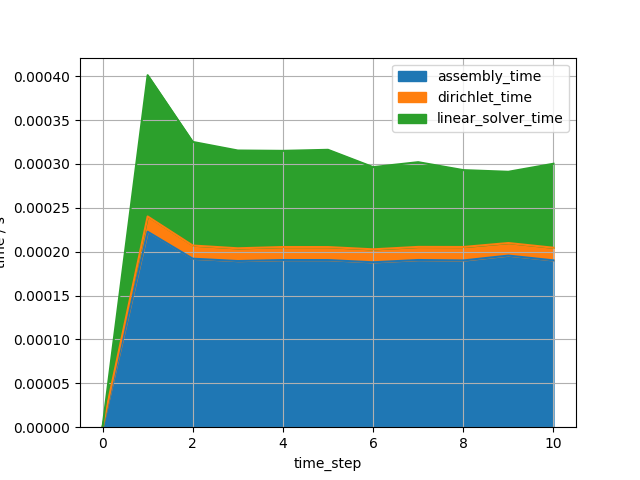

Analyzing Convergence with the Log Parser#
The log parser extracts convergence data, timestep information, and errors from the simulation log file:
<Axes: xlabel='time_step', ylabel='time / s'>
The convergence plot shows how the nonlinear solver converged at each time step, helping you identify potential numerical issues.
