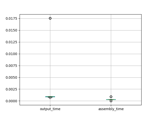

df_ts[["output_time", "assembly_time"]].boxplot()
plot 102 logparser advanced
<Axes: >
