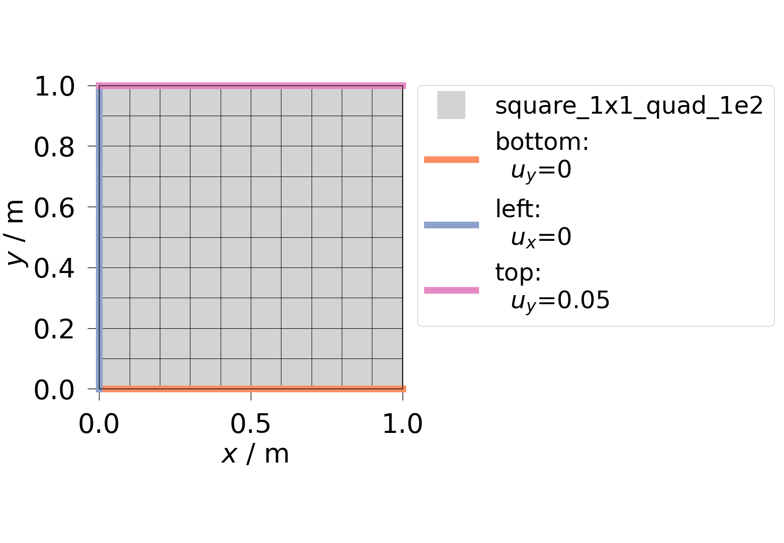

m = ot.Model(project=prj, meshes=ot.definitions.EXAMPLES_DIR / "prj")
fig = m.plot_constraints()
plot creation
