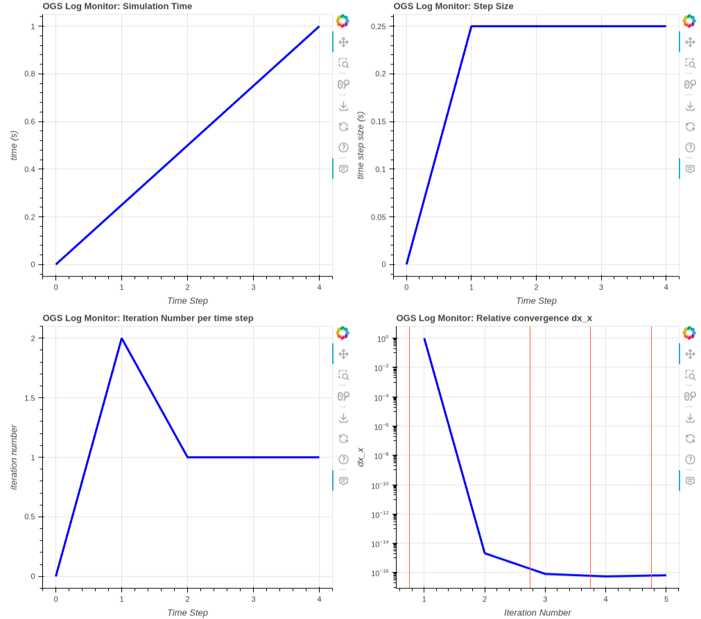

Alternatively, for more control
simc = model2.controller() # this call is not blocking
simc.terminate() # do something while the simulation is running
simc.run() # this call is blocking, it waits for the simulation to finish
Simulation(model=Model.from_folder('/tmp/ogstools_root/Model/20260601_131501_269211'), result=Result('/tmp/ogstools_root/Result/20260601_131501_488681'))
log_file='/tmp/ogstools_root/Result/20260601_131501_488681/log.txt'
meshseries_file='/tmp/ogstools_root/Result/20260601_131501_488681/E=1e9.pvd'
status=Status: completed successfully (results pending)
StorageBase(id='20260601_131501_492400', is_saved=False, _active_target=None, next_target=PosixPath('/tmp/ogstools_root/Simulation/20260601_131501_492400'))
