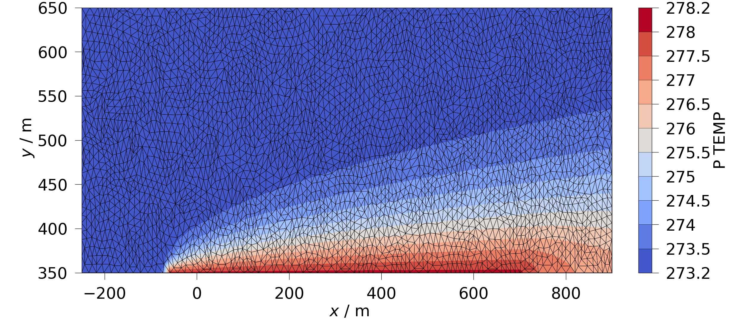

  1. Plot the temperature simulated in FEFLOW on the mesh.
fig = ot.plot.contourf(mesh, "P_TEMP", show_edges=True)
fig.show()
plot B feflowlib BC mesh

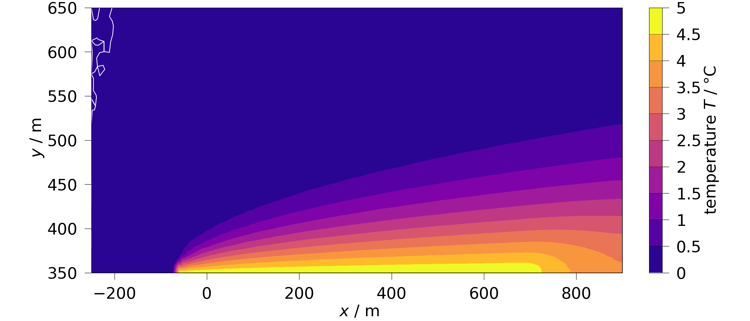

  1. Plot the temperature simulated in OGS.
fig = ot.plot.contourf(ogs_sim_res, ot.variables.temperature)
fig.show()

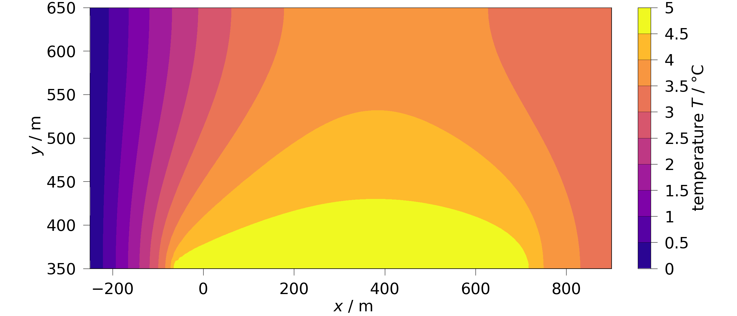

6. The boundary meshes are manipulated to alter the model. The original boundary conditions are shown in this example: Workflow with Feflowlib: Hydro-thermal model - conversion, simulation and post-processing 6.1 The Dirichlet boundary conditions for the hydraulic head are set to 0. Therefore, no water flows from the left to the right edge.
bc_flow = feflow_model.subdomains["P_BC_FLOW"]["P_BC_FLOW"]
feflow_model.subdomains["P_BC_FLOW"]["P_BC_FLOW"][bc_flow == 10] = 0
6.2 Overwrite the new boundary conditions and run the model.
feflow_model.run(overwrite=True)
 ogs  -o . /tmp/ogstools_root/examples/converted_models463d7b0069c24453aad18d493cf7729f/HT_model.prj
['ogs', '-o', '.', '/tmp/ogstools_root/examples/converted_models463d7b0069c24453aad18d493cf7729f/HT_model.prj']
6.3 The corresponding simulation results look like.
ms = ot.MeshSeries(temp_dir / "HT_model.pvd")
# Read the last timestep:
fig.show()

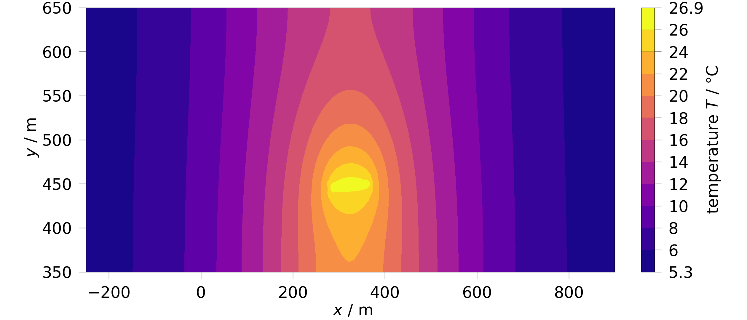

6.4 Create a new boundary mesh and overwrite the existing subdomains with this boundary mesh.
assign_bulk_ids(mesh)
# Get the points of the bulk mesh to build a new boundary mesh.
wanted_pts = [1492, 1482, 1481, 1491, 1479, 1480, 1839, 1840]
new_bc = mesh.extract_points(
    [pt in wanted_pts for pt in mesh["bulk_node_ids"]],
    adjacent_cells=False,
    include_cells=False,
new_bc["bulk_node_ids"] = np.array(wanted_pts, dtype=np.uint64)
# Define the temperature values of these points.
new_bc["P_BC_HEAT"] = np.array([300] * len(wanted_pts), dtype=np.float64)
feflow_model.subdomains["P_BC_HEAT"] = new_bc
  1. Run the new model and plot the simulation results.
fig.show()
