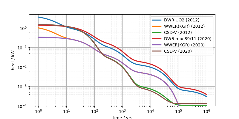

Let’s compare the heat timeseries of single containers of different nuclear waste types without interim storage or deposition taken into account (baseline=True).
fig, ax = plt.subplots(figsize=(8, 4))
for model in models:
    q = model.heat(time, baseline=True, **units)
    ax.loglog(time, q, label=model.name, lw=2.5)
format_ax(ax)
ax.set_ylim([1e-4, 5])
fig.show()
plot nuclearwasteheat

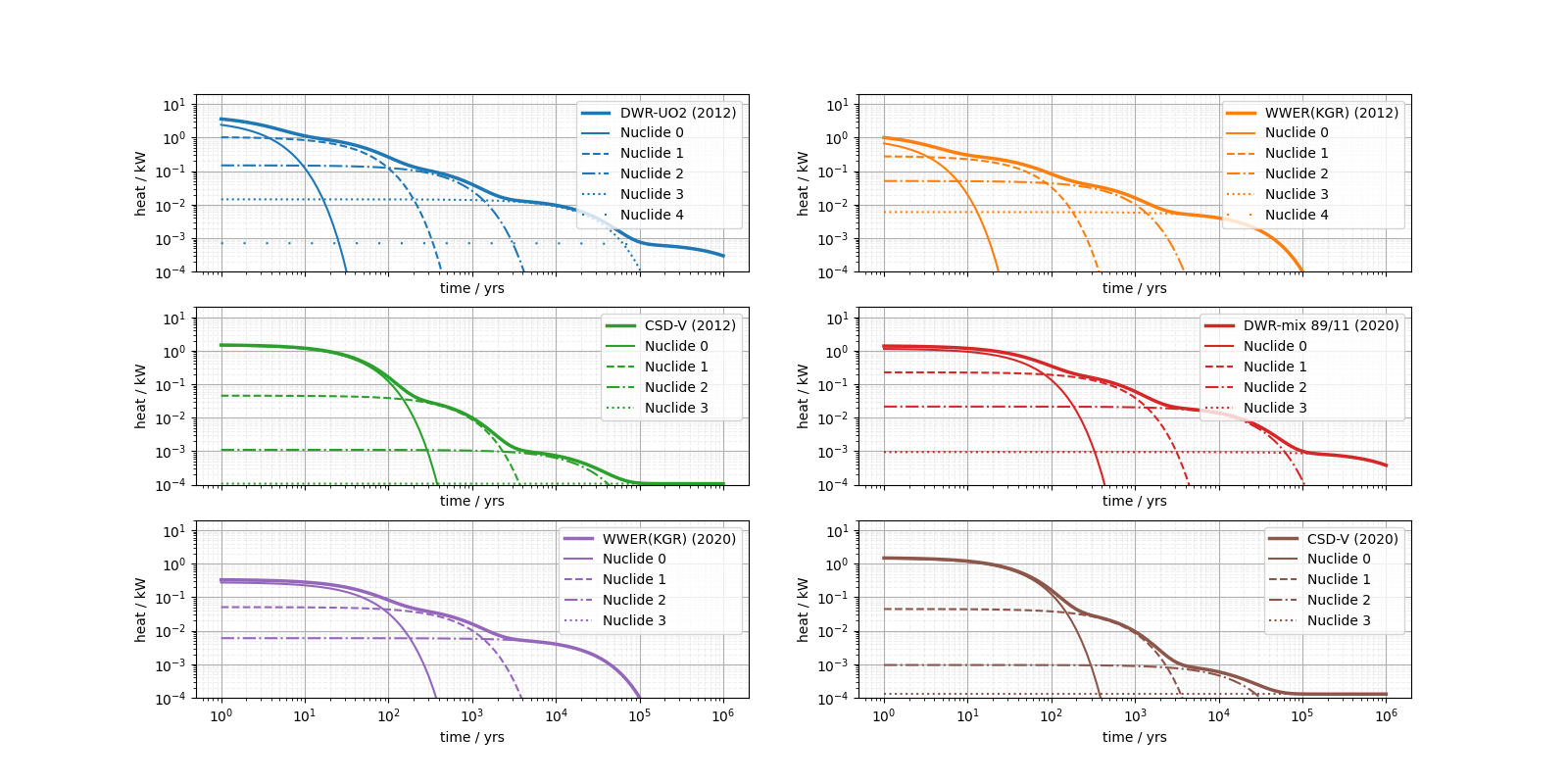

The bumps in the curves stem from the different leading nuclides in the proxy model sequentially decaying to nothing. The leading nuclides don’t necessarily represent actual physical nuclides, but they give a close match to the result of burn-off simulations. We can visualize the decay of the nuclides themselves as well:
fig, axs = plt.subplots(
    nrows=int(0.5 + len(models) / 2), ncols=2, figsize=(16, 8), sharex=True
axs: list[plt.Axes] = np.reshape(axs, (-1))
colors = plt.rcParams["axes.prop_cycle"].by_key()["color"]
for ax, model, color in zip(axs, models, colors, strict=False):
    ax.loglog(time, q, label=model.name, lw=2.5, c=color)
    for i, _ in enumerate(model.nuclide_powers):
        q = model.heat(time, baseline=True, ncl_id=i, **units)
        ax.loglog(time, q, label=f"Nuclide {i}", lw=1.5, c=color, ls=ls[i])
    format_ax(ax)
    ax.set_ylim([1e-4, 20])
fig.show()

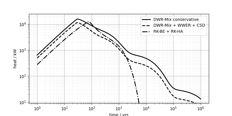

When taking the interim storage time and the time to fill the repository into account we get a linear increase of bundles adding to the total heat. Is is assumed, that each bundle has reached exactly the interim storage time at the moment it is deposited. Let’s compare the different available repository models.
repos = [
    nuclear.repo_2020_conservative,
    nuclear.repo_2020,
    nuclear.repo_be_ha_2016,
repo_heat = [repo.heat(time, **units) for repo in repos]
ax.loglog(time, repo_heat[0], "k", label="DWR-Mix conservative", lw=2, ls=ls[0])
ax.loglog(time, repo_heat[1], "k", label="DWR-Mix + WWER + CSD", lw=2, ls=ls[1])
ax.loglog(time, repo_heat[2], "k", label="RK-BE + RK-HA", lw=2, ls=ls[2])
format_ax(ax)
ax.set_ylim([9, 25000])
fig.show()

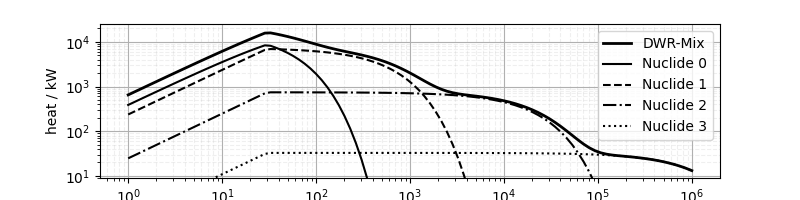

fig, ax = plt.subplots(figsize=(8, 2))
ax.loglog(time, repo_heat[0], label="DWR-Mix", lw=2, c="k")
for i, _ in enumerate(nuclear.repo_2020_conservative.waste[0].nuclide_powers):
    q = nuclear.repo_2020_conservative.heat(time, ncl_id=i, **units)
    ax.loglog(time, q, label=f"Nuclide {i}", lw=1.5, c="k", ls=ls[i])
format_ax(ax)
fig.show()
