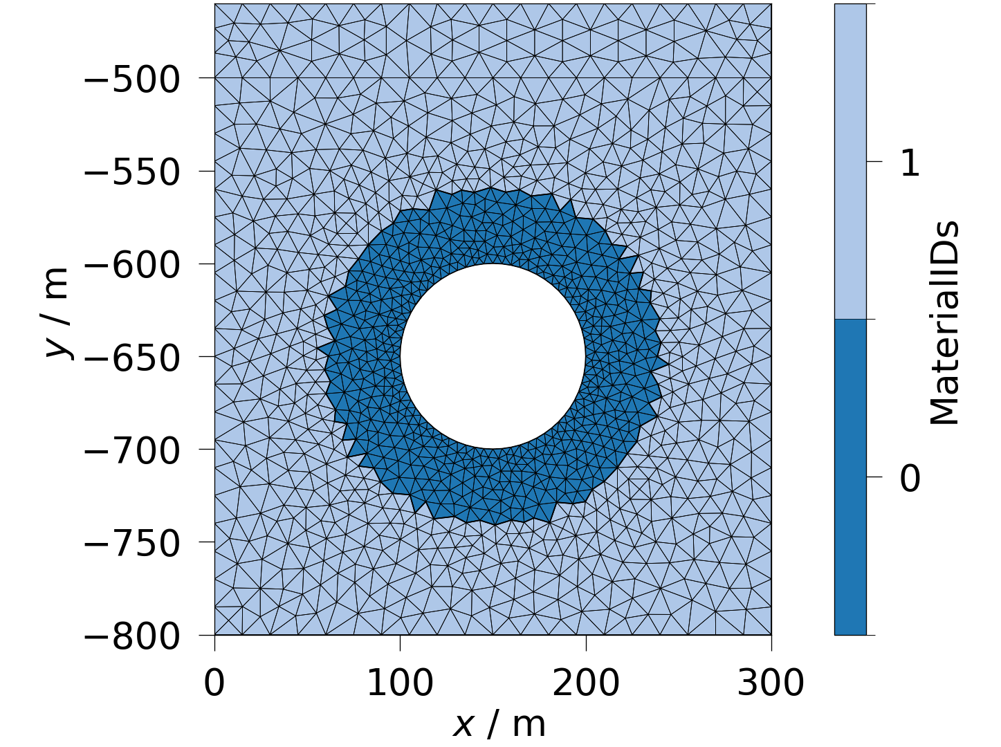

One way to set-up new Material IDs is by defining a function.
def material_ids(pt: np.ndarray) -> int:
    if np.sqrt((pt[0] - 150) ** 2 + (pt[1] + 650) ** 2 + pt[2] ** 2) < 90:
        return 0
    return 1
The function is then used to create an array of type np.int32 and same size as the number of elements in the mesh. The numpy array is later implicitly converted into a VTK array of VTK-type Int32 which is the required by OpenGeoSys for Material IDs.
ccp = mesh.cell_centers().points
mat_ids = np.array([material_ids(pt) for pt in ccp], dtype=np.int32)
Then the array is attached to the mesh.
mesh.cell_data.set_array(mat_ids, "MaterialIDs")
fig = ot.plot.contourf(mesh, ot.variables.material_id)
fig.show()
plot initial properties and variables

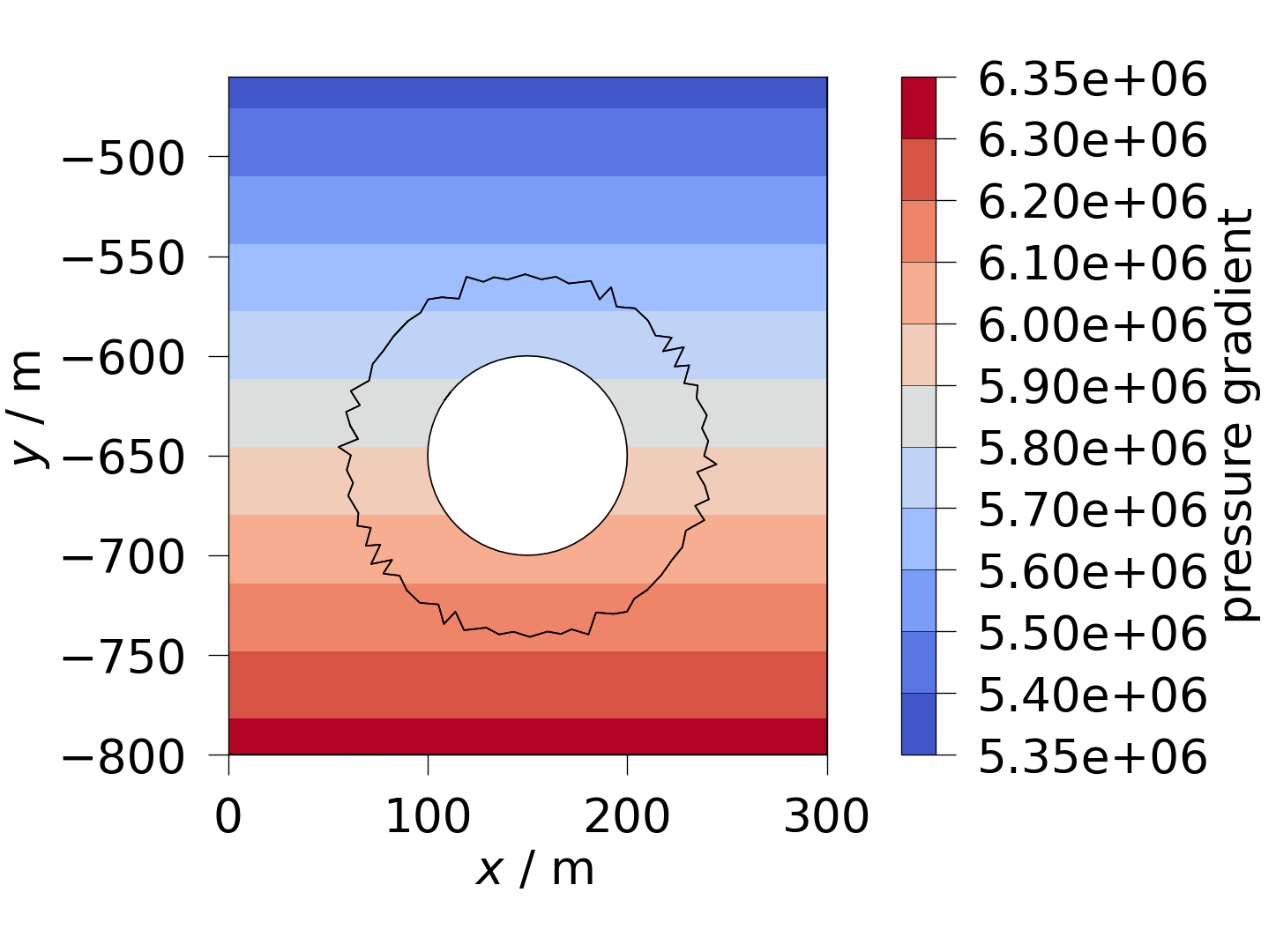

Creating variable/points fields#
In this example we use the y-coordinates to create a linear pressure gradient along the y-axis.
y = mesh.points[:, 1]
p = 1e6 * y / (np.min(y) - np.max(y)) + 4e6
The array is added to the mesh.
mesh.point_data.set_array(p, "pressure_gradient")
fig = ot.plot.contourf(mesh, "pressure_gradient")
fig.show()

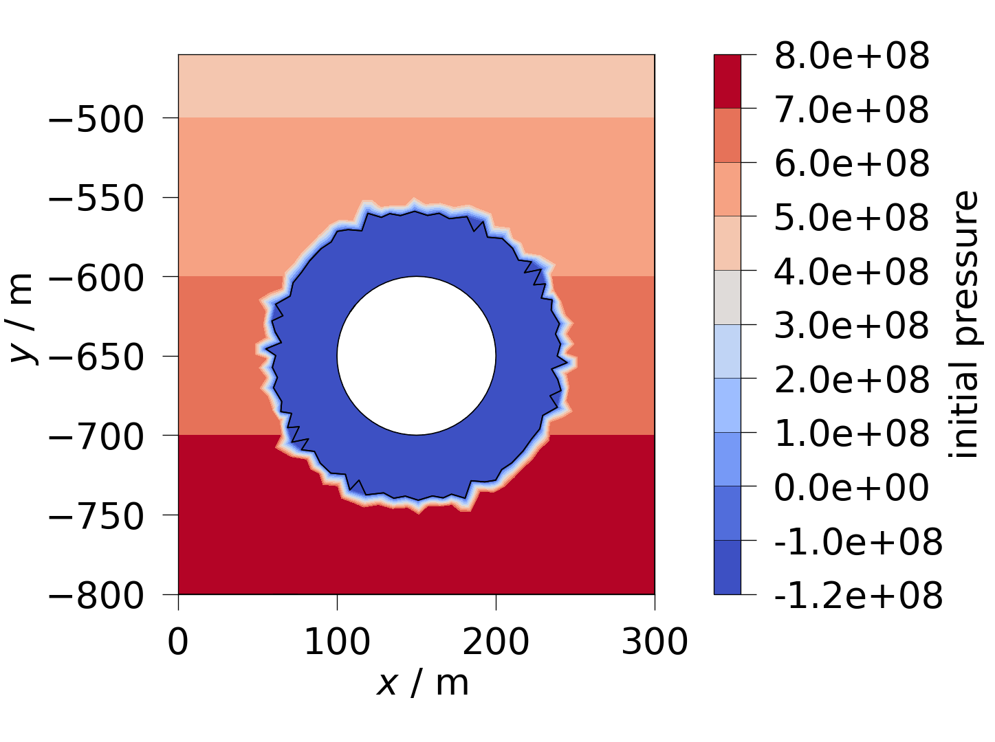

Mapping element data to node data#
First, we convert the cell data to point data. Subsequently, a new array is created and filled point-by-point.
mat_ids = mesh.cell_data_to_point_data().point_data["MaterialIDs"]
p0 = np.where(mat_ids.astype(int) == 0, -1.2e8, -1e6 * mesh.points[:, 1])
Finally, the array is added to the mesh and can be saved to disc using pyvista/meshio.
mesh.point_data.set_array(p0, "initial_pressure")

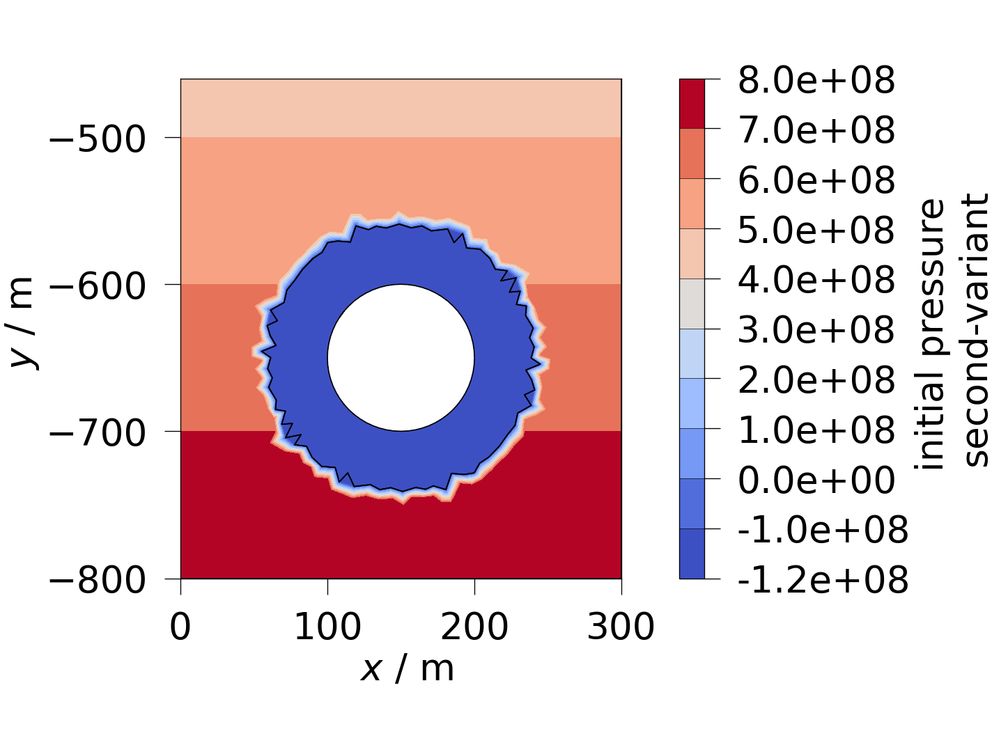

It is important to note that at the interface we have to deal with the ambiguity of setting initial pressures / material data. Therefore, it might be useful to have an alternative approach to set the initial pressures. In the following we assume that all nodes connected to bentonite cells have bentonite pressure:
bentonite = mesh.extract_cells(mesh["MaterialIDs"] == 0)
p0_new = -1e6 * mesh.points[:, 1]
p0_new[bentonite["vtkOriginalPointIds"]] = -1.2e8
mesh.point_data.set_array(p0_new, "initial_pressure_second-variant")
fig1 = ot.plot.contourf(mesh, "initial_pressure")
fig1.show()
fig2 = ot.plot.contourf(mesh, "initial_pressure_second-variant")
fig2.show()
  • plot initial properties and variables
