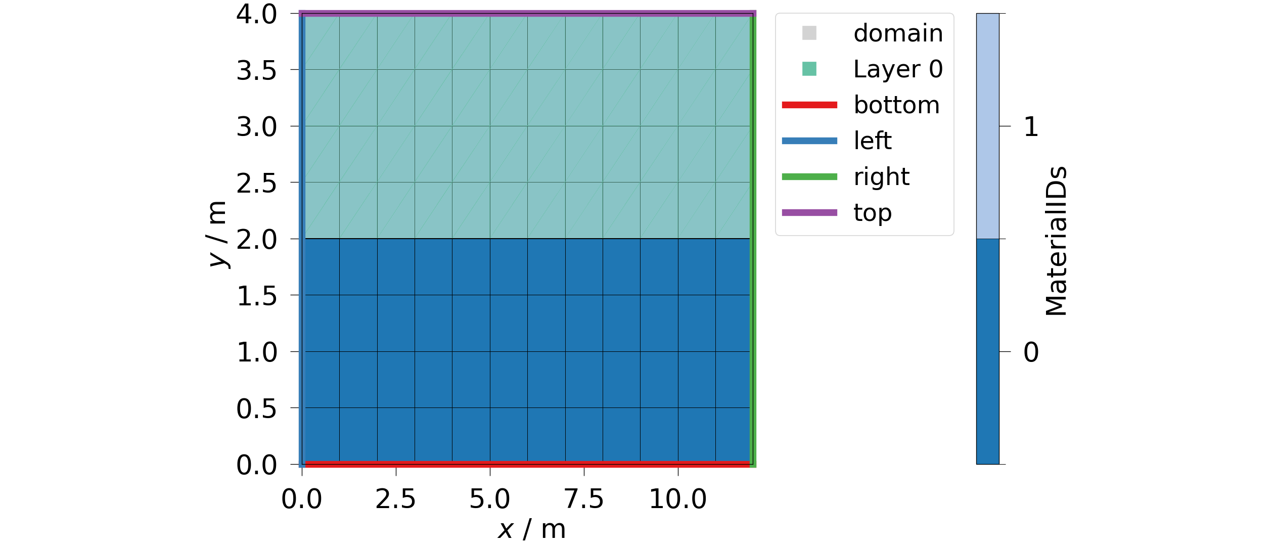

# Visualize the mesh topology
fig_topology = meshes.plot()
fig_topology.show()

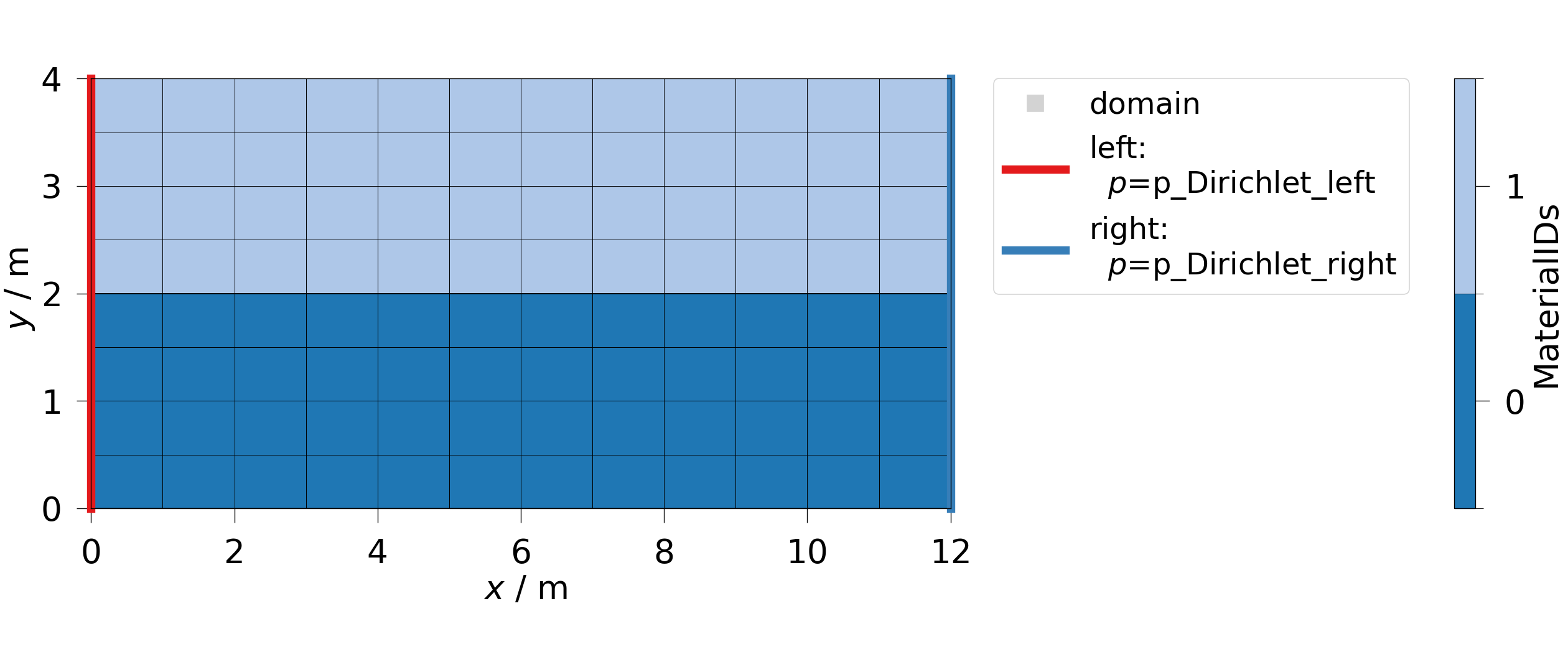

# Visualize the model setup with boundary conditions
fig_constraints = model.plot_constraints()
fig_constraints.show()
The constraints plot shows your model domain with annotated boundary conditions and source terms, making it easy to verify your setup before running.

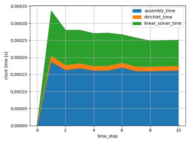

# Plot clock time per solver phase
df_ts = ot.logparser.analysis_time_step(sim.log.df_log).reset_index()
times = ["assembly_time", "dirichlet_time", "linear_solver_time"]
ax = df_ts.plot.area(x="time_step", y=times, ylabel="clock time [s]", grid=True)
ax.get_figure().tight_layout()
ax.get_figure().show()

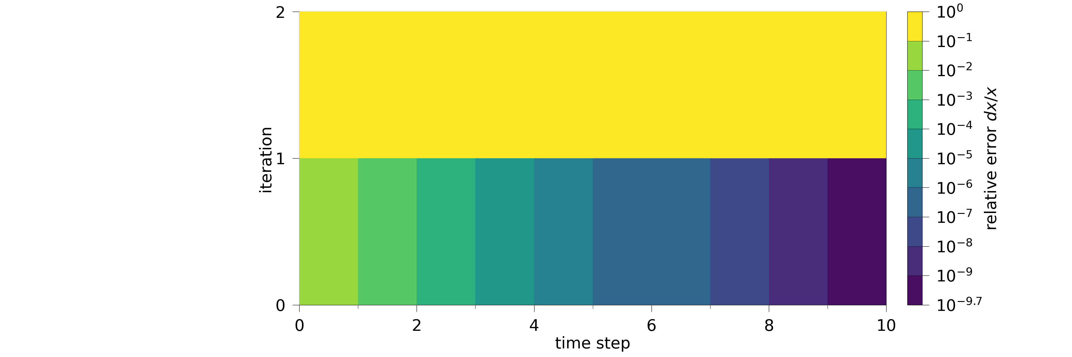

Plot convergence behaviour
The convergence plot is a heatmap of the relative error at each iteration and time step, giving an overview of how the nonlinear solver converged over the entire simulation and helping you identify potential numerical issues. In this simple example all timesteps converge in 2 iterations.
