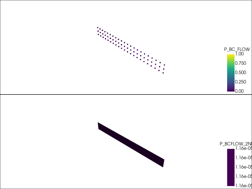

  1. Extract the subdomains conditions.
subdomains = feflow_model.subdomains
# Since there can be multiple boundary conditions in the subdomains,
# they are plotted iteratively.
plotter = pv.Plotter(shape=(len(subdomains), 1))
for i, (name, boundary_condition) in enumerate(subdomains.items()):
    # topsurface refers to a cell based boundary condition.
    if name != "topsurface":
        plotter.subplot(i, 0)
        plotter.add_mesh(boundary_condition, scalars=name)
plotter.show()
plot E feflowlib H simulation

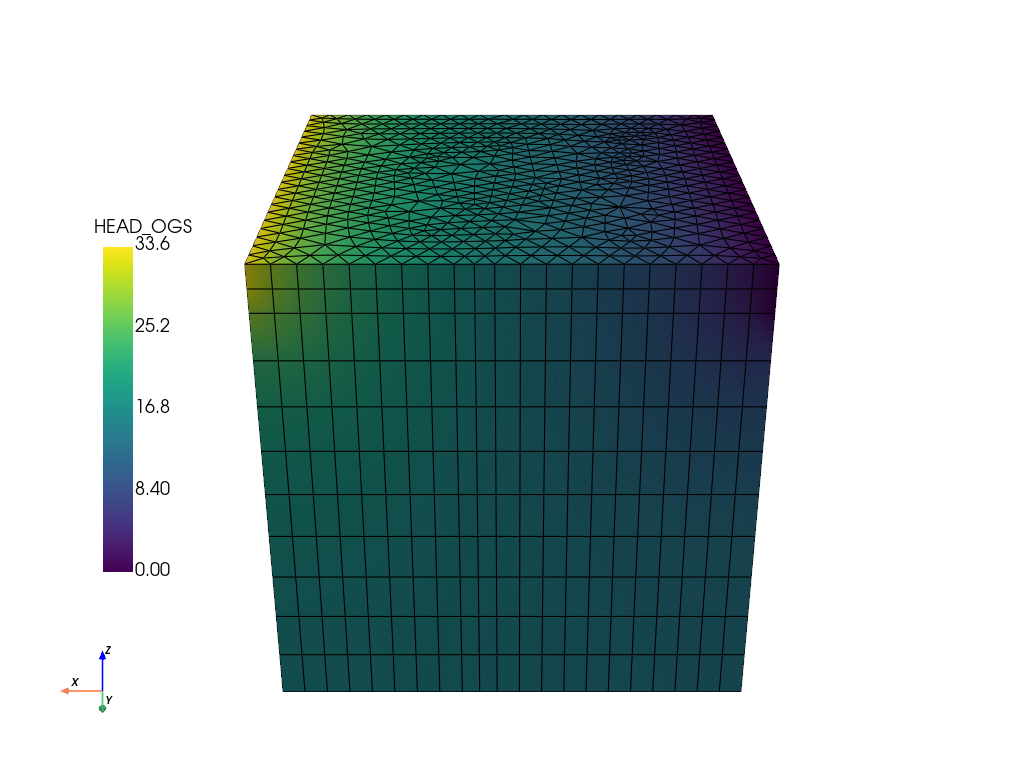

  1. Read the results and plot them.
ms = ot.MeshSeries(temp_dir / "boxNeumann.pvd")
# Read the last timestep:
It is also possible to read the file directly with pyvista:
ogs_sim_res = ot.mesh.read(temp_dir / "boxNeumann_ts_1_t_1.000000.vtu")
ogs_sim_res.plot(
    show_edges=True,
    off_screen=True,
    scalars="HEAD_OGS",
    cpos=[0, 1, 0.5],
    scalar_bar_args={"position_x": 0.1, "position_y": 0.25},

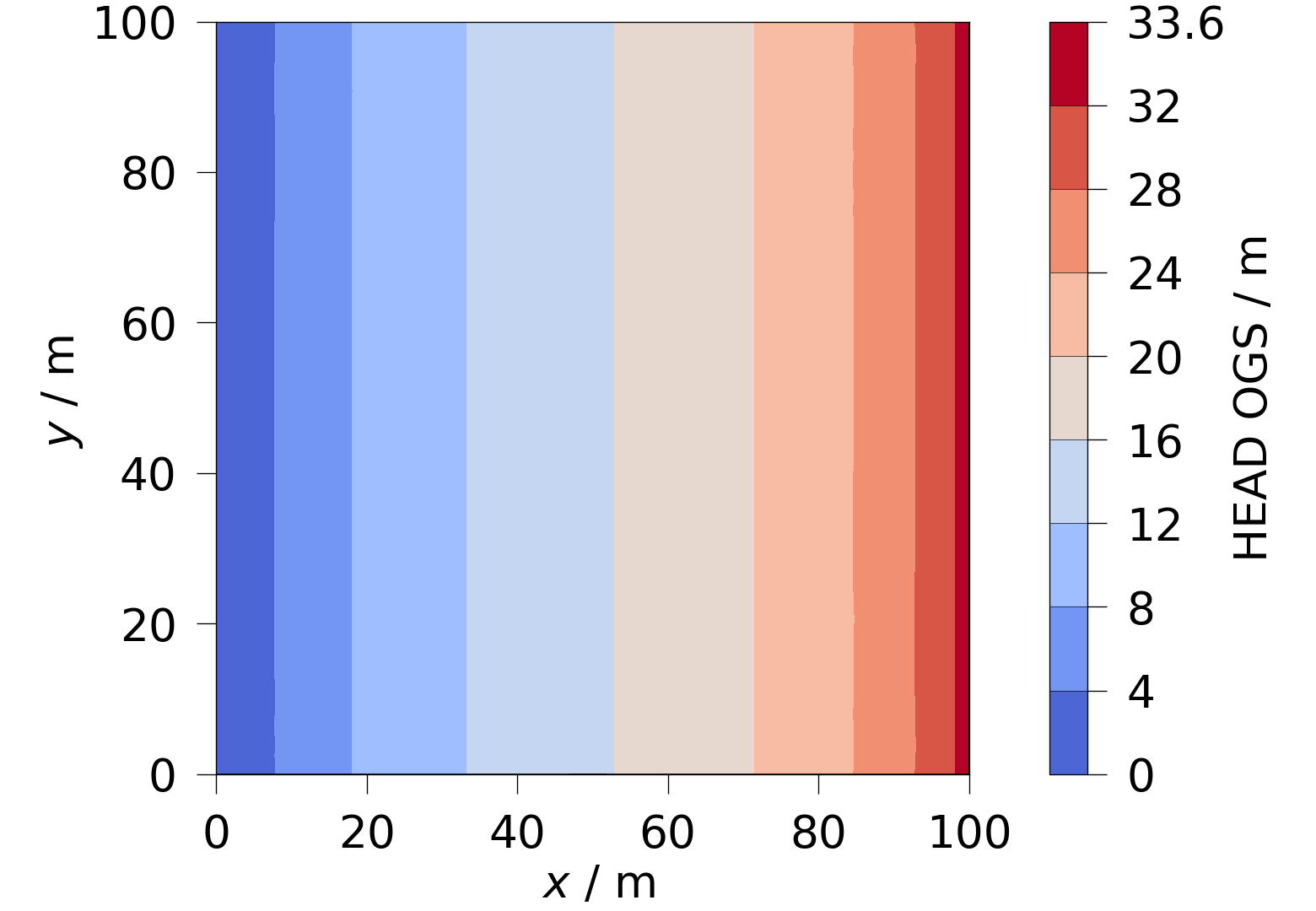

5.1 Plot the hydraulic head simulated in OGS with ogstools.plot.contourf.
head = ot.variables.Scalar(data_name="HEAD_OGS", data_unit="m", output_unit="m")
fig = ot.plot.contourf(ogs_sim_res.slice(normal="z", origin=[50, 50, 0]), head)

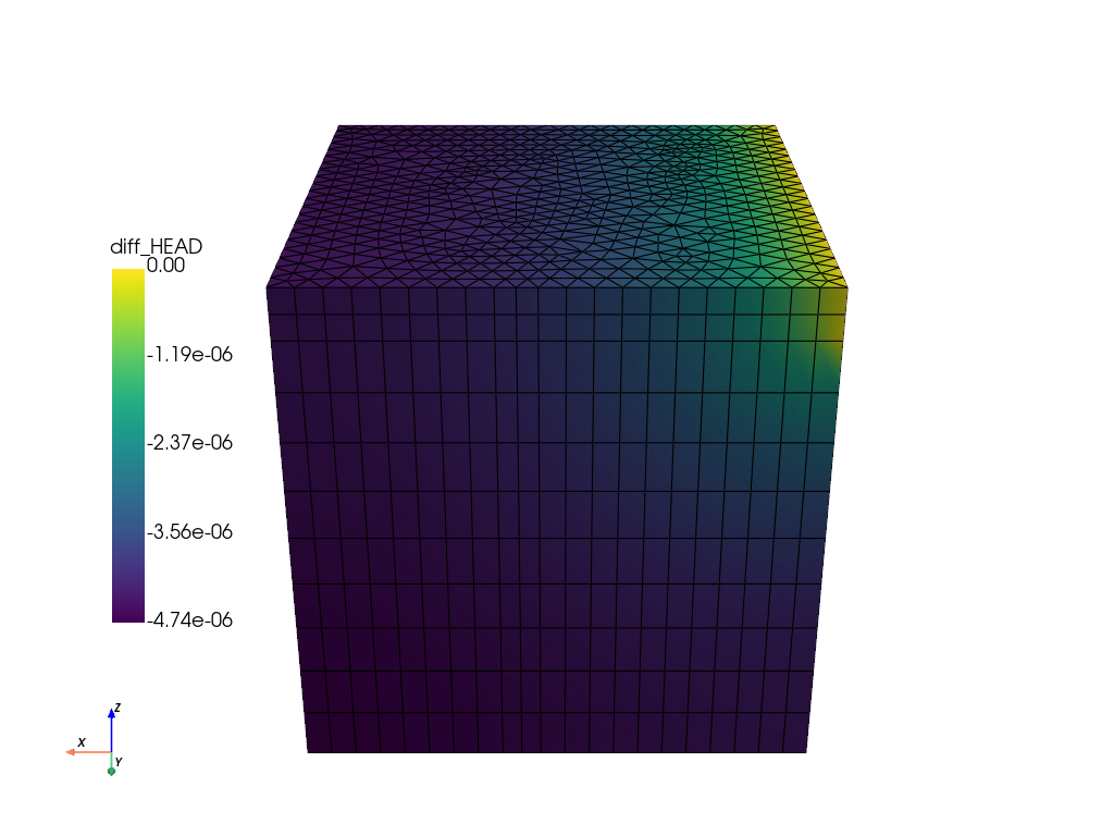

  1. Calculate the difference to the FEFLOW simulation and plot it.
diff = feflow_model.mesh["P_HEAD"] - ogs_sim_res["HEAD_OGS"]
feflow_model.mesh["diff_HEAD"] = diff
feflow_model.mesh.plot(
    show_edges=True,
    off_screen=True,
    scalars="diff_HEAD",
    cpos=[0, 1, 0.5],

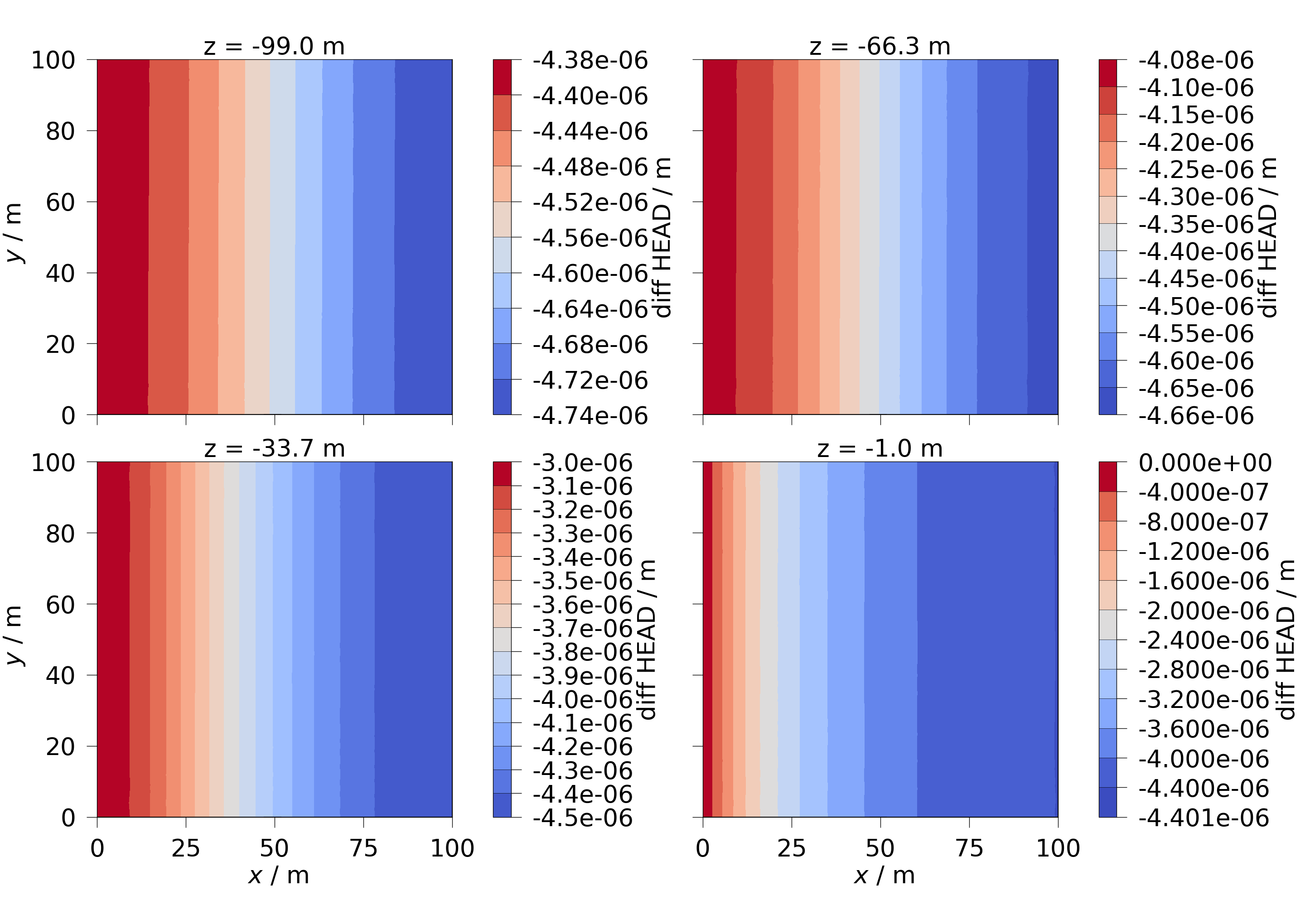

6.1 Plot the differences in the hydraulic head with ogstools.plot.contourf. Slices are taken along the z-axis.
diff_head = ot.variables.Scalar(
    data_name="diff_HEAD", data_unit="m", output_unit="m"
slices = np.reshape(
    list(feflow_model.mesh.slice_along_axis(n=4, axis="z")), (2, 2)
fig = ot.plot.contourf(slices, diff_head)
for ax, slice in zip(fig.axes, np.ravel(slices), strict=False):
    ax.set_title(f"z = {slice.center[2]:.1f} m", fontsize=32)
z = -99.0 m, z = -66.3 m, z = -33.7 m, z = -1.0 m

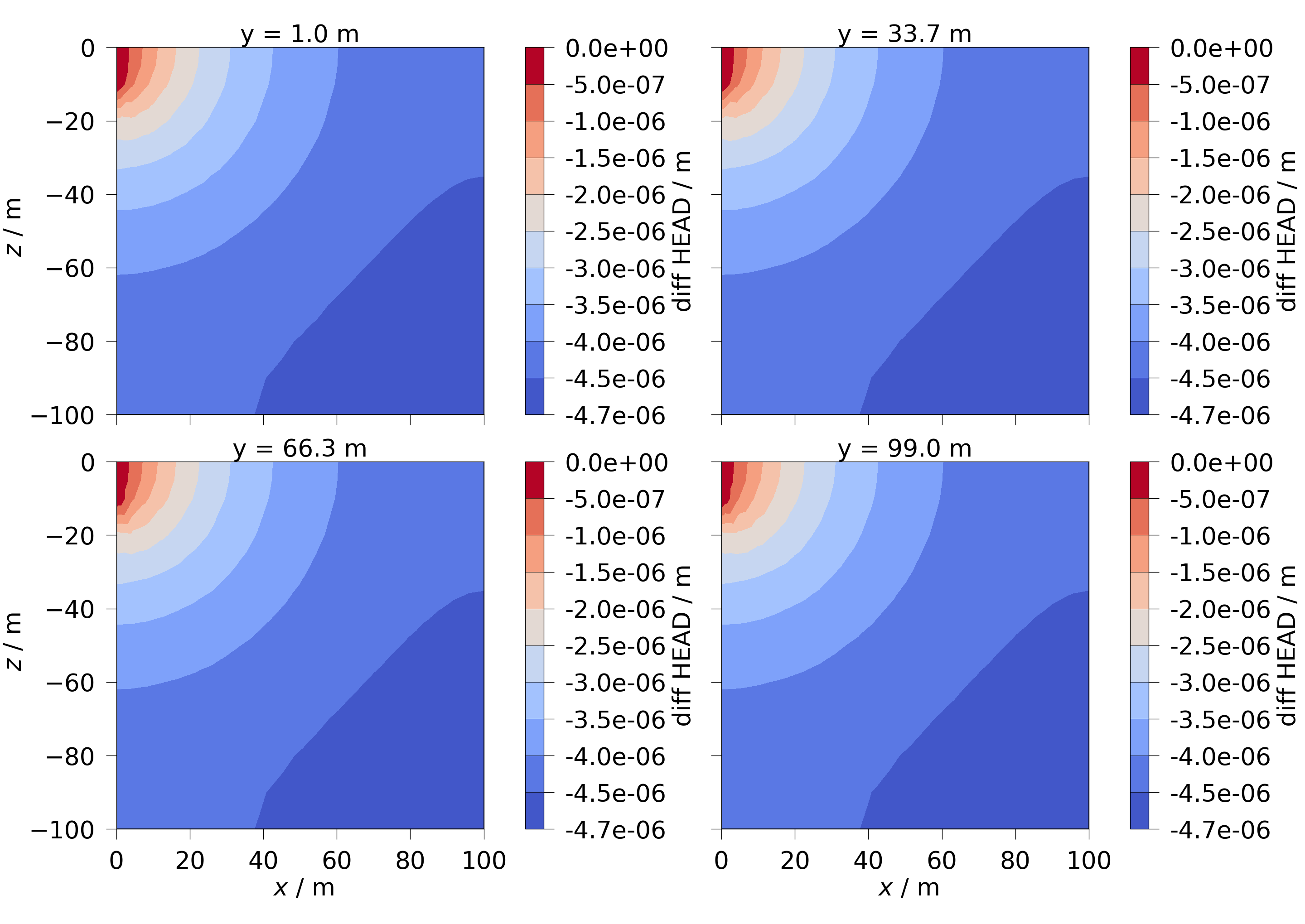

6.2 Slices are taken along the y-axis.
    list(feflow_model.mesh.slice_along_axis(n=4, axis="y")), (2, 2)
    ax.set_title(f"y = {slice.center[1]:.1f} m", fontsize=32)
y = 1.0 m, y = 33.7 m, y = 66.3 m, y = 99.0 m
