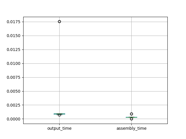

ax = df_ts[["output_time", "assembly_time"]].boxplot()
ax.get_figure().show()
plot 102 logparser advanced
