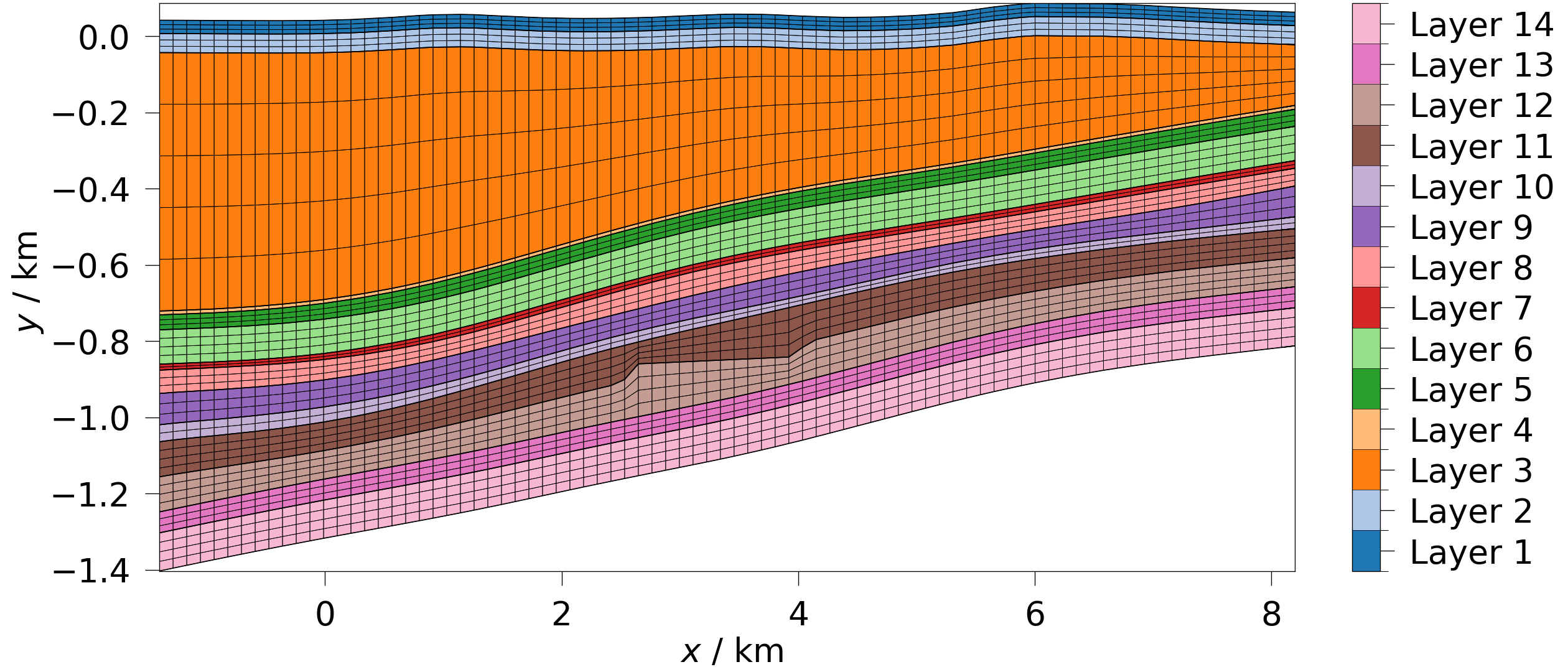

Plotting Cell Data#
First, let’s plot the material ids, which is part of the mesh’s cell_data. Per default in the setup, this will automatically show the element edges.
fig = ot.plot.contourf(mesh, ot.variables.material_id)
fig.show()

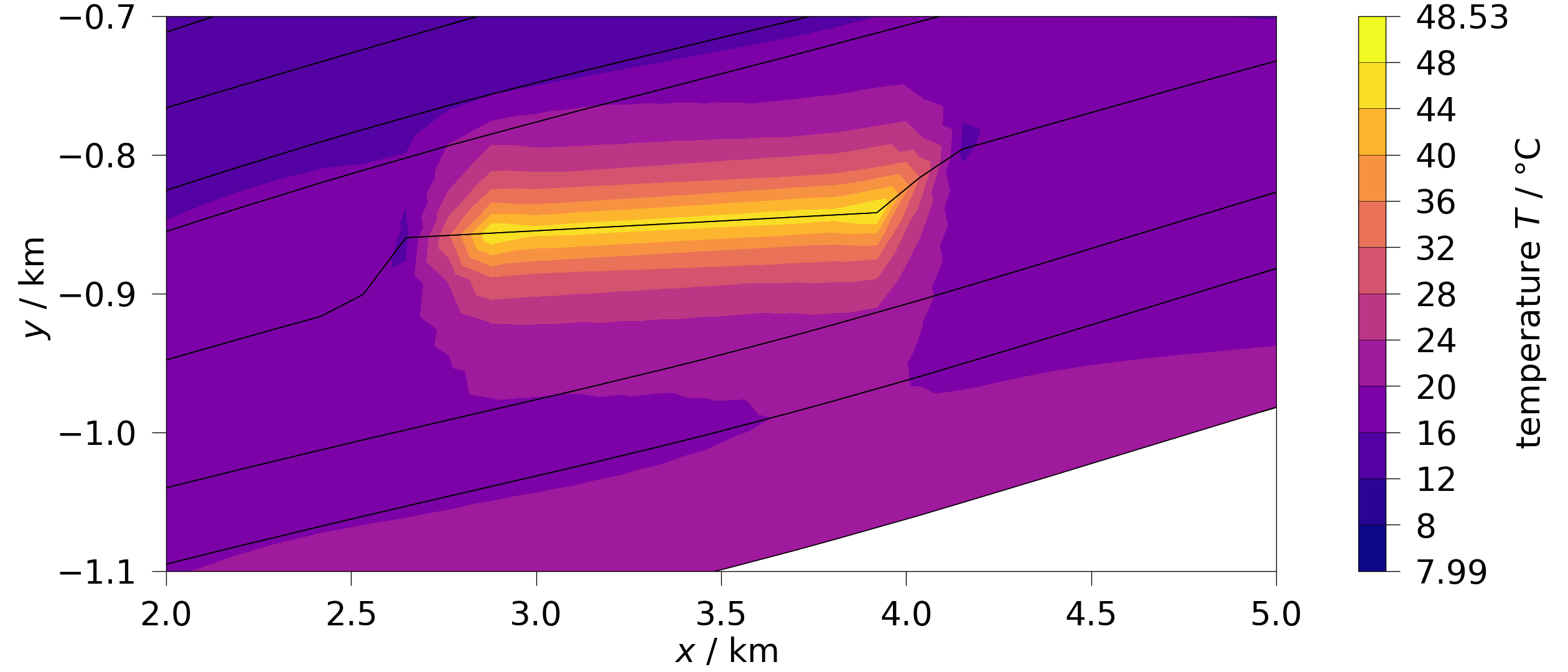

Now, let’s plot the temperature field (point_data). The default temperature variable from the variables reads the temperature data as Kelvin and converts them to degrees Celsius. This also shows how to only plot a specific part of the model by using xlim and ylim.
    mesh, ot.variables.temperature, xlim=[2, 5], ylim=[-1.1, -0.7]
fig.show()

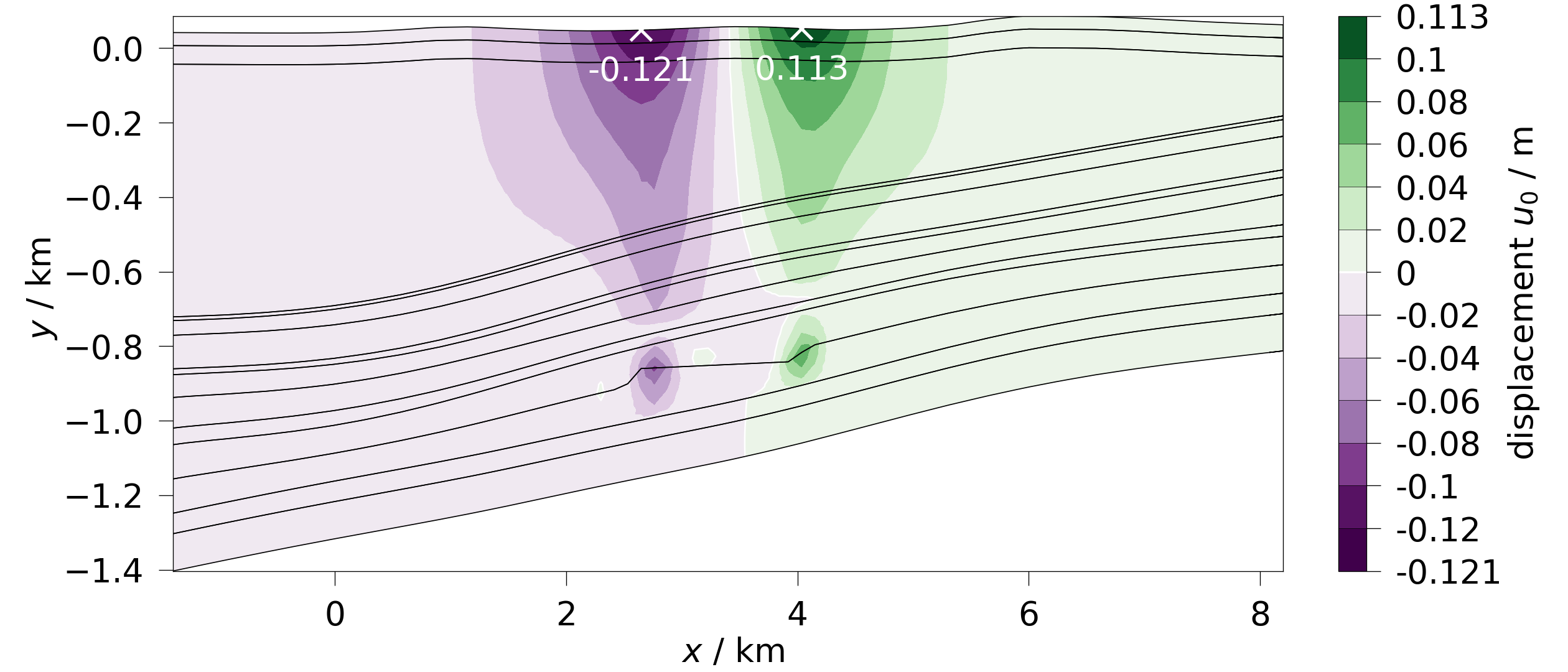

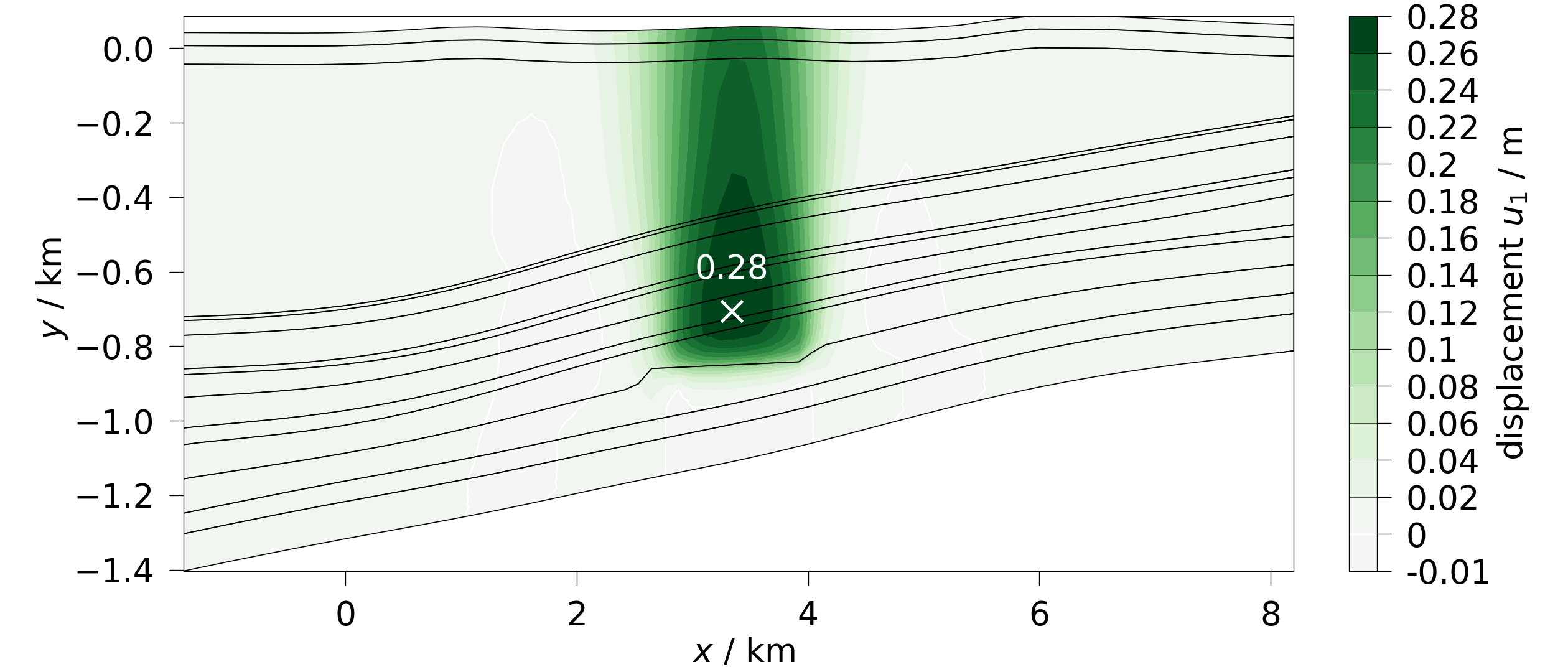

We can also plot components of vector variables:
    mesh, ot.variables.displacement[0], show_min=True, show_max=True
fig.show()
plot contourf 2d

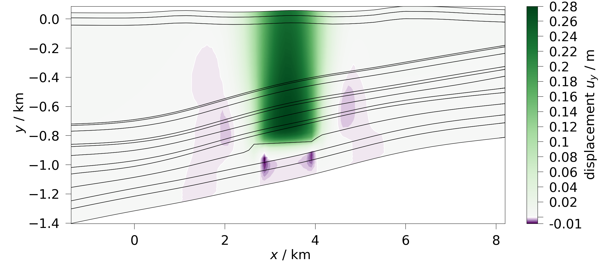

fig = ot.plot.contourf(mesh, ot.variables.displacement[1], show_max=True)
fig.show()
plot contourf 2d
To have a continuous colormap instead of discrete colors per level pass a the equally named argument. In this case this helps to increase the level of detail of the negative displacements due to the bilinear colormap. You are also able to access the vector component via a string of the data with the appended suffix.
fig = ot.plot.contourf(mesh, "displacement_y", continuous_cmap=True)
fig.show()
plot contourf 2d

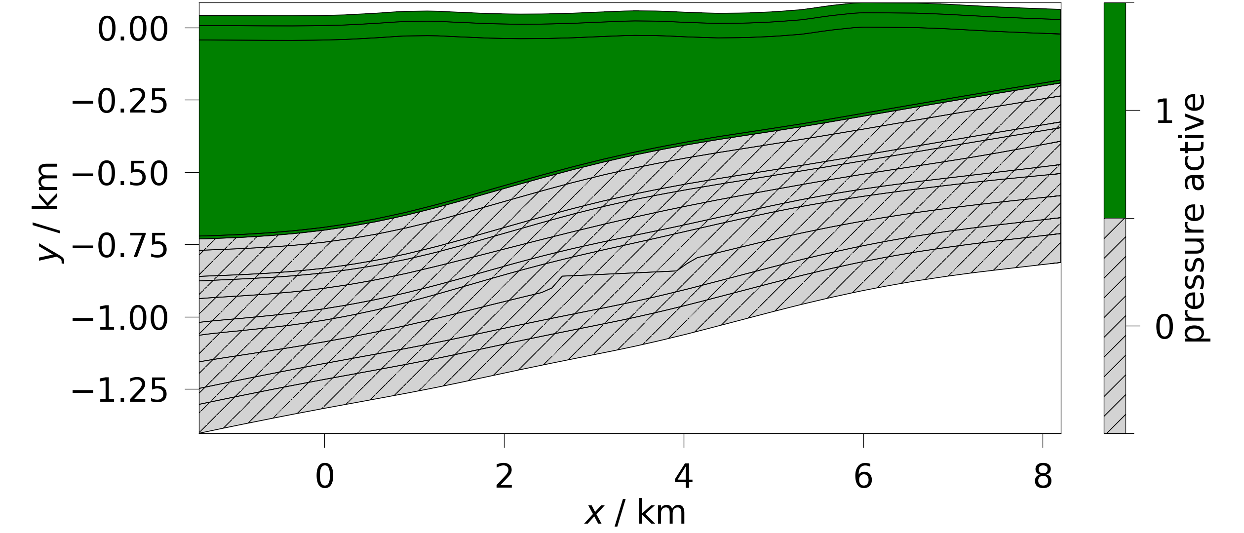

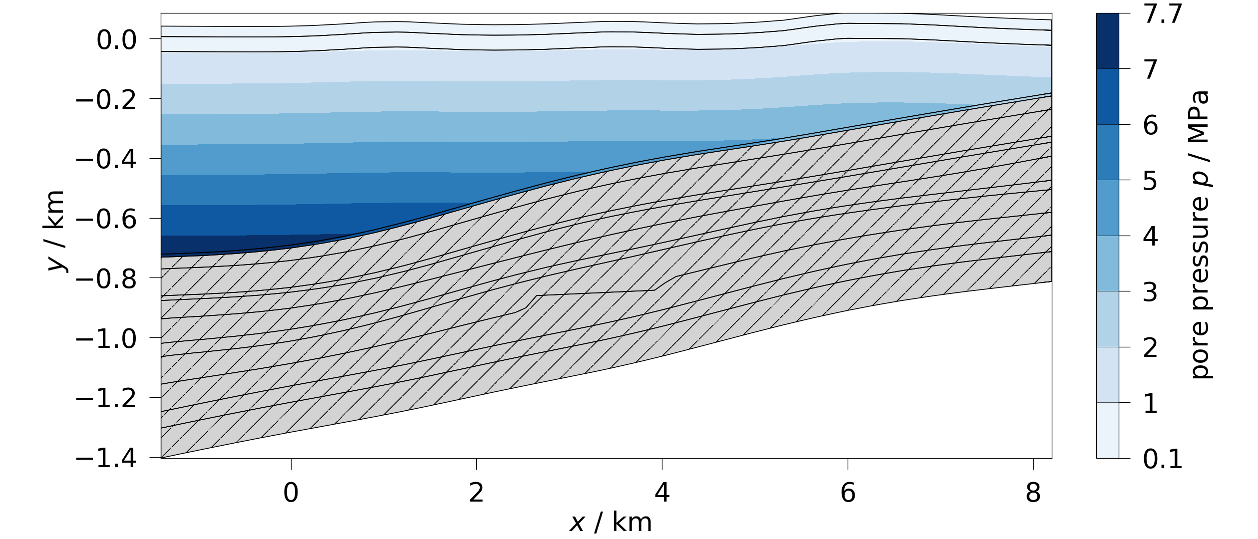

Plotting with deactivated subdomains#
This example has hydraulically deactivated subdomains, which will mask the related variables.
fig = ot.plot.contourf(mesh, ot.variables.pressure.get_mask(), fontsize=40)
fig.show()
plot contourf 2d
fig = ot.plot.contourf(mesh, ot.variables.pressure)
fig.show()

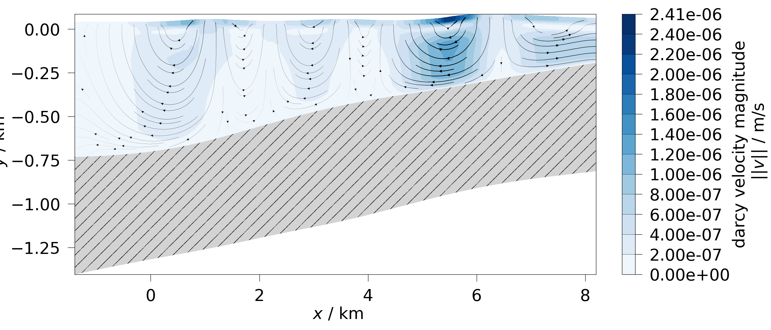

Plotting vector data#
Let’s plot the fluid velocity field. As this is vectorial data, this will automatically add streamlines to indicate the vector directions.
fig = ot.plot.contourf(mesh, ot.variables.velocity, show_region_bounds=False)
fig.show()
plot contourf 2d

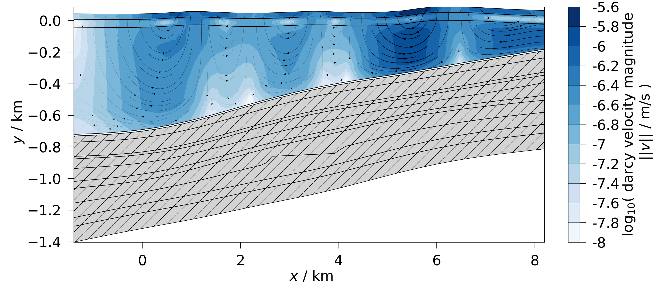

Let’s plot it again, this time log-scaled.
fig = ot.plot.contourf(mesh, ot.variables.velocity, log_scaled=True, vmin=-8)
fig.show()
